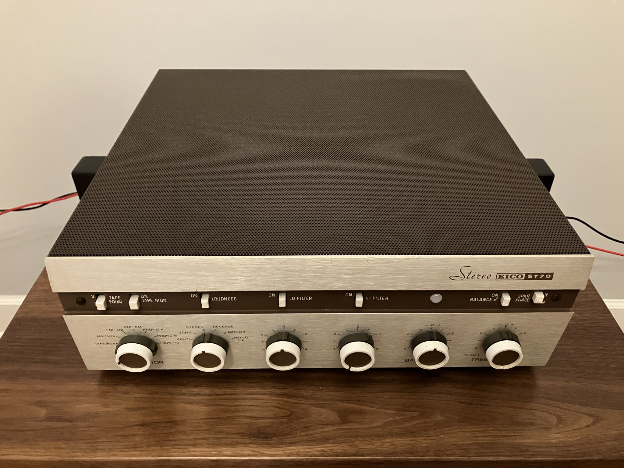

So, I just recapped, new tubed and adjusted balance and bias. Also did 2 dexoit sessions on the pins and sockets of tubes and all wipers and switches. At the 0 volume there is this white noiseish coming through the speakers and as I turn up the volume and at max (with nothing playing) it actually goes mostly away but is very faint. When music is playing I cannot hear it, just when there is no signal. Inserting shirted RCA plugs has no affect neither does changing to any other inputs or selections on the Stereo, mono, L, R.
It is a beautiful amp, very pleased with how it has turned out so far and would love to determine if this is normal (doubt it) or there are some usual players I can look at.
More cleaning? Maybe check other components along signal path? Ground? Any suggestions, thank you!

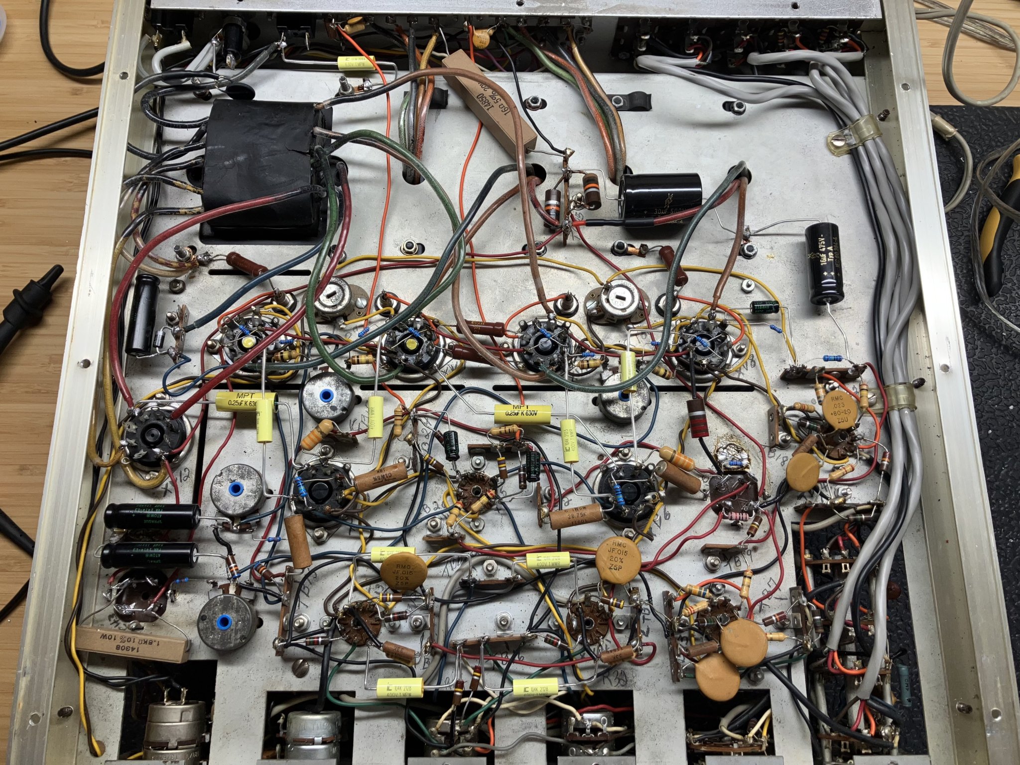

Also, wanted to point out, I didn't do any mods, I left everything intact as far as how the amp was originally designed and wired. Here is a photo of my board after the work I did. There were some carbon comps that I replaced with Yaego Metal Film if there were near a cap I was replacing, or, if they looked like they had gotten hot. Also, i am pretty anal when it comes to values so I matched all cap values to what was being removed. The only thing that changed were voltage ratings and I only replaced with higher values.

This is a characteristic of poor design choices EICO made - there's just too much gain after the volume control. And the feedback around the line amplifier stage is grounded when the volume control is at zero, which increases the stage gain to maximum. The modifications suggested at http://tronola.com/ will help, a further reduction in gain as suggested in the link above will help more.
