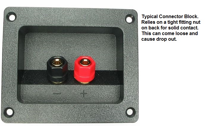

A poor connection sounds like the culprit!

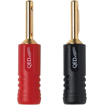

This is a good connector, IMO. 4mm banana. Prefereably hard soldered to fresh copper cable. Never like screwdown connection at all.
This is a type I like less, the loose expanding sleeve on the tip only makes contact connection.
You can test a speaker by shorting out the input with a single speaker wire loop. If the connection is dubious somewhere, you will hear sort of crunching noise or crackle from the tweeter when you push the bass cone in.
