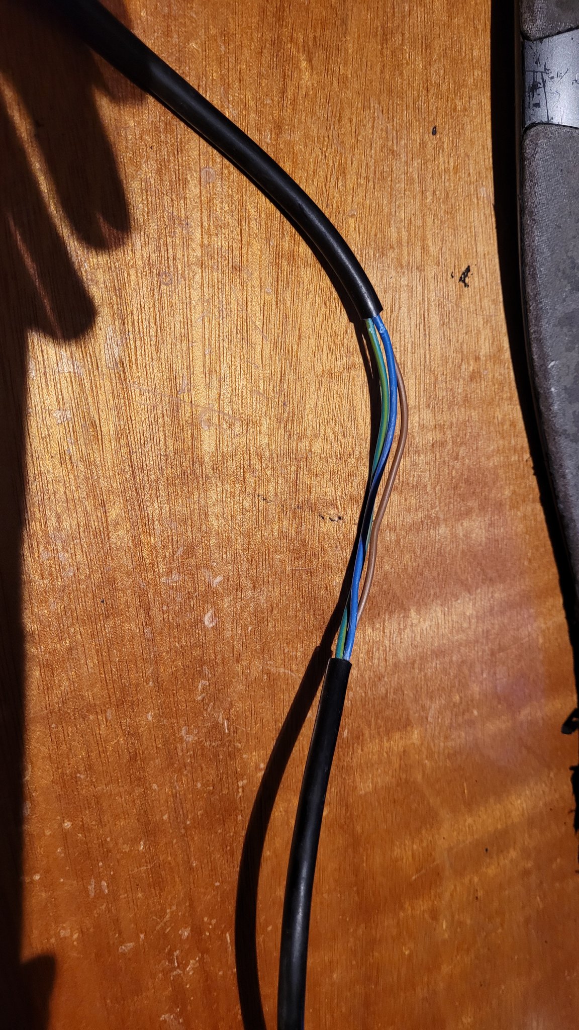

Well,
I sacrificed a spare power cable to the gods of testing and non-compliance.
Chucked on a clamp meter.
Clipping into a 4ohm load. I got 0.7A on 230V mains.
So max power consumption is 160W
Clipping in my amp is at 80W.
Scale that up to 100W output
0.7A/0.8 = 0.875A or 200VA.
Very educational.
