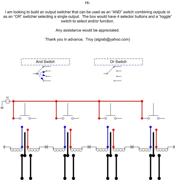

Hi All-
I am researching threads about good signal relays for a switching project I am working on and figured I would ask a question.
I am looking for a logic circuit to turn on 1-4 relays using 4 buttons for direct access to a relay. Only one relay can be operational at a time, and they must have direct access from its respective button, which would turn off all other relays.
In essence the same as a preamp with multiple inputs and 1-to-1 correlating selector buttons but I will be using for distribution, not input selection.
I would appreciate any assistance on this matter.
Thanks again,
Troy

The solution is very simple, use latching relays. Connect every relays latch down pin with a blocking diode to all the other relays latch-up pins.
Leve
Leve

Diode assistance
Hi All-
I was hoping someone could elaborate on LBHajdu's post (# 27) earlier in this thread.
I have a simple diagram attached and any assistance on the diode placement would be appreciated.
Please disregard the drawing if it is easier to start from scratch.
Thank you in advance,
Troy (stgrab@yahoo.com)
Hi All-
