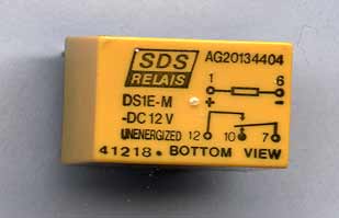

I want to make a high end preamp and i want to use relays for input switching and volume control. So i want to know which relay is the best for audio purpose?
Are reed relays better than other ones? Can I use cheapest ones I get, or are there differences? If yes, which do you recommend?
What are about HF-Relays which are designed for very high frequency? Are the good for audio signals? For example the Omron G6Y-1?
Please give me some recommendations. And please give me exact type names.
I have searched the forum, but have not found concrete information. So please help me, i am searching for THE best relay you can buy...
Thanks very much for your help!!!

For the input selector the best solution is to use
bistabile relay switcher.
relay:
Siemens V23042-B2203-B101
I think that this relays are gold plated...
And you need a digital trigger circuit to drive the relays...

You need relays wich closes with very low Imin of the signal switched.
I suspect you are able to read german: http://www.schuro.de/preisl-relais.htm
http://www.schuro.de/takami-dat.htm
as stated on my hompage linked above.
Takamisawa RY12WKexact type names.
Here's the close up of relays used in top of the line Madrigal preamp ML32 and a link to a similar thread: http://www.diyaudio.com/forums/showthread.php?s=&threadid=16129&highlight=
peranders said:Do you have any of them "in duty" or are them still in the original box?
Uhrmmm, actually they are still in the box but I have never been closer to using them than today...

One of the most important parameter is "minimum current" and "minimum voltage" for the contacts. SDS/NAIS had extremely low values of those parameters but I would say that any good signal relay will do a good job. AVOID power relays, over 2 A current.

OK, you want a reed relay recommendation. Mine is
Coto (www.cotorelay.com , I believe). I've use a number
of different types in precision instrumentation application
(DC as well as high dynamic range 100kHz AC). Very
good. If you want to get really fancy, look at mercury-
wetted reeds. Coto and most others are sensitive to
physical orientation (the Hg needs to stay in the proper
place), though Pickering (not my favorite relay vendor)
has a mercury-wetted low thermal EMF reed that claims
not to be sensitive to orientation.
Given my poor results with some Aromats in the past
few years, I'm avoiding them for all my work-related
applications. However, for DIY audio projects where
you could "buzz" them for a while and then verify goodness,
I'd consider an Aromat SX series.
Note that the SX series comes in normal as well as latching
(aka "bistable") configurations. You can get them
from Digi-Key.
