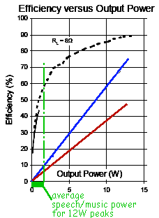

Using drivers similar to yours, with a 5*150W amp array, I used to do 1,000-head concerts in the park. In an earlier day, even larger movie theaters used 15W amps. It appears you are over-provisioned.
The operating efficiency of Linear amps is VERY much about the ratio of power available to power actually demanded.
First-thought is to try a 20W amp. It may be ample. It certainly will not be throwing 100W-200W of waste heat. Even if biased "hot and sweet".
OTOH, when you discard your old thirsty car for a thrifty car, you should consider the cost of *making* that new car. The energy cost (from red-dirt and sand to showroom) is very roughly similar to all the energy that car will use in fuel over a typical operating life. As the energy spent to make the old car can not be recovered, buying new/thrifty is not always best for the Planet (altho the smog happens in some other place).
I have not looked at electronics the same way. Let's see. A 600W amp has $100 of transistors alone. Sand is cheap and most of the cost is Energy: smelting, founding, shipping. In domestic use this amp could pull 100W. Take 4 hours/day and 300 days/year. At my electric rate this is $20/year. It takes some years to pay-back just the Silicon investment already spent. More for iron/copper. Yes, you may be able to pawn the amp to a musician who would thus defer the energy cost of making a new amp. No hard answers, just fogging the question.
In an air-conditioned space there is further savings from not working the A/C as hard. (Here I might put the 600W upstairs 9 months a year, down cellar in the summer.)
It happens my uncle just discovered "TriPath" (clone) and I plotted efficiency for A B and D. Attached. Assuming a 12W amp driven to the edge of clipping, the B has a real efficiency of 10% (not 78% as when driven FULL) and the D is some better. Working a 600W amp in a job that only needs 10W-20W puts B down like 2%! All the voltage headroom you are not using is still dissipated as heat to give you your small output. Yes, a HG class switch-rail design could cut this dramatically. Even within the parameters of your existing 600W amp. Add +/-20V rails to your +/-100V rails so it runs 99% of the time with just-enough rail voltage. Of course it is unlikely that you could modify any existing 600W B amp to HG mode without burning a heap of energy in blown Silicon.

The real eco crime is the inefficiency of speakers, don't you think?...
Hi Brian
I have some of the most efficient speakers it is possible to buy, but then people say they are "over-provisioned"😉
Best wishes
David
