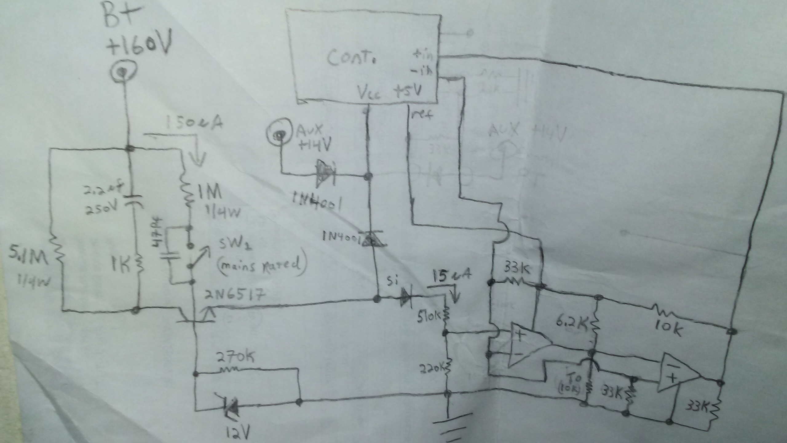

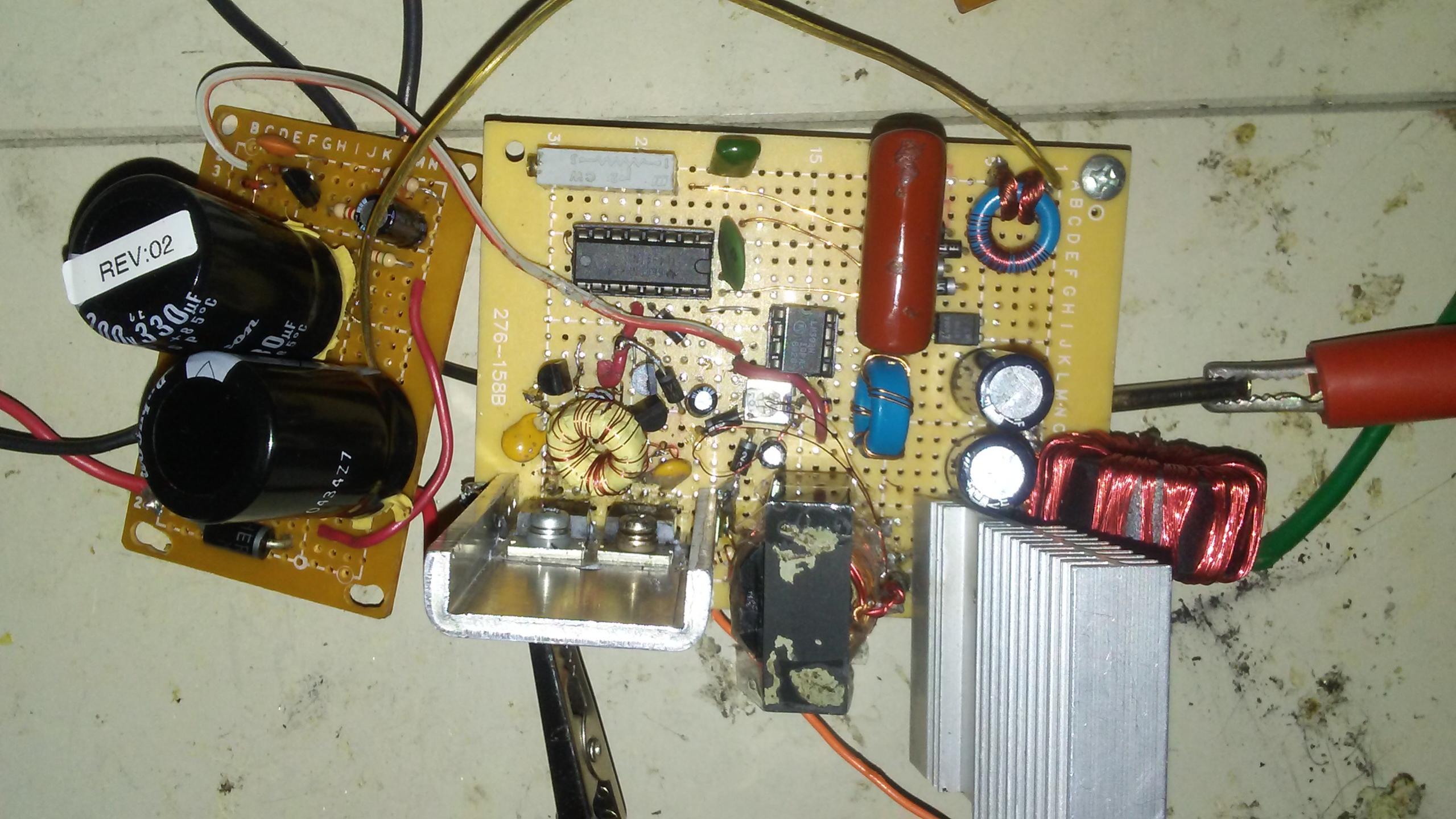

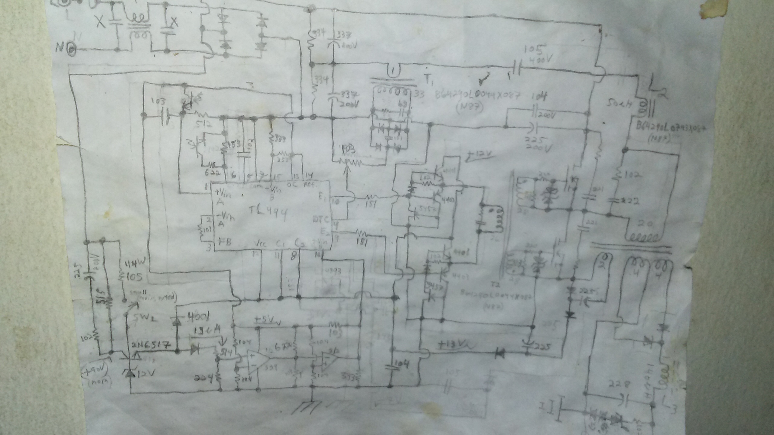

Hi. This sounds like a problem I have had recently. I am a bit new to SMPS but I came up with a solution that seems to work pretty good.:spin: I figured that you only need the current but for a short time which sounds like a capacitor situation.:lickface: I sketch out the relevant circuit section. It may not be exactly your situation but maybe you can adapt. My situation is with a non-isolated controller, starting a TL494 and gate drive transformer for an asynchronous 1/2 bridge from 120VAC rectified mains. Then using an auxiliary winding from the power transformer to take over duty providing Vcc to the control circuit. But then also switch off with the switch. :boggled:
In this case referring to the first pic, when the switch is closed, the 2.2uf cap in series with the collector of transistor provides charge in order to start and the auxiliary winding/rect takes over. When the switch, which can be small but mains rated:att'n: is opened, the comparator circuit interrupts the controller by way of error input and the circuit unlatches. Also thermistor thrown in there can trigger comparator. Seems to work, at least in practice.😛. Second pic is the circuit mock up sketch that I used in with minor corrections and it had a drink spilled on it...oops😀:drink: but it will be redrawn in CAD for PCB soon anyway. Third pic is the experimental circuit.
If you are using 310V B+, you can scale up values, maybe adjust cap value to suit the needed current but use at least 400V, should use 1/2W size resistors where voltage constraints require, and 400V Transistor. I used 2N6517 but it will not reach 310V.😛. Anyway, maybe you will get ideas.🙂
