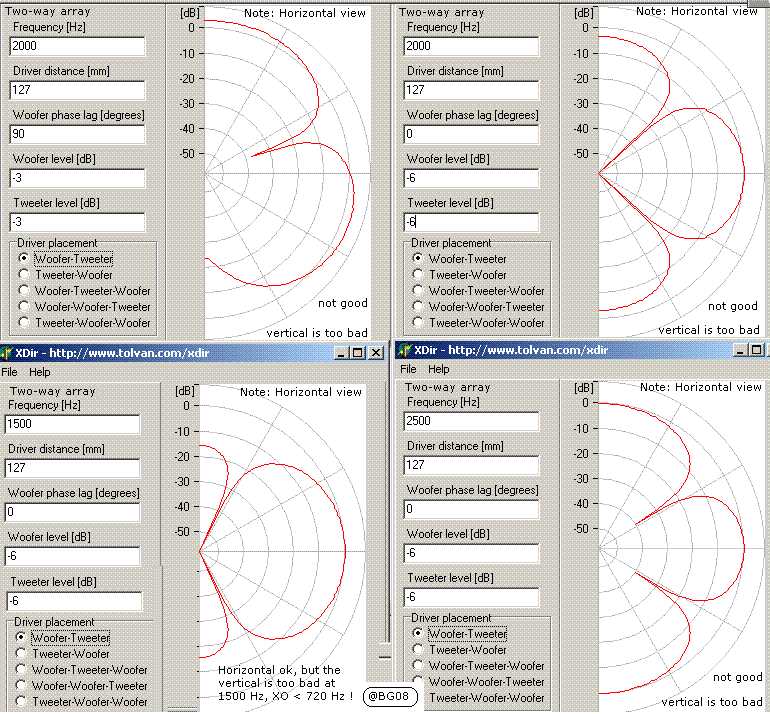

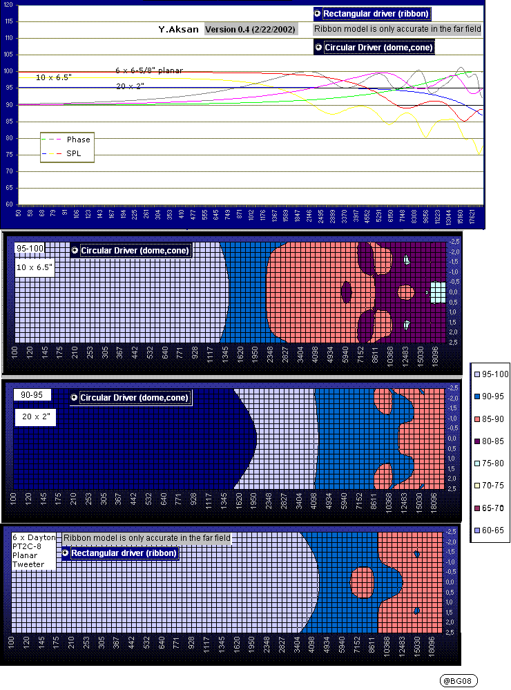

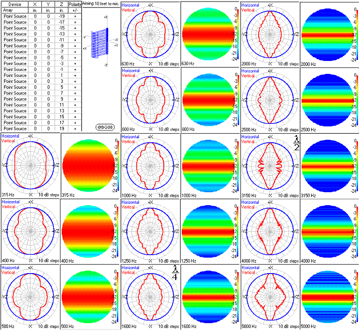

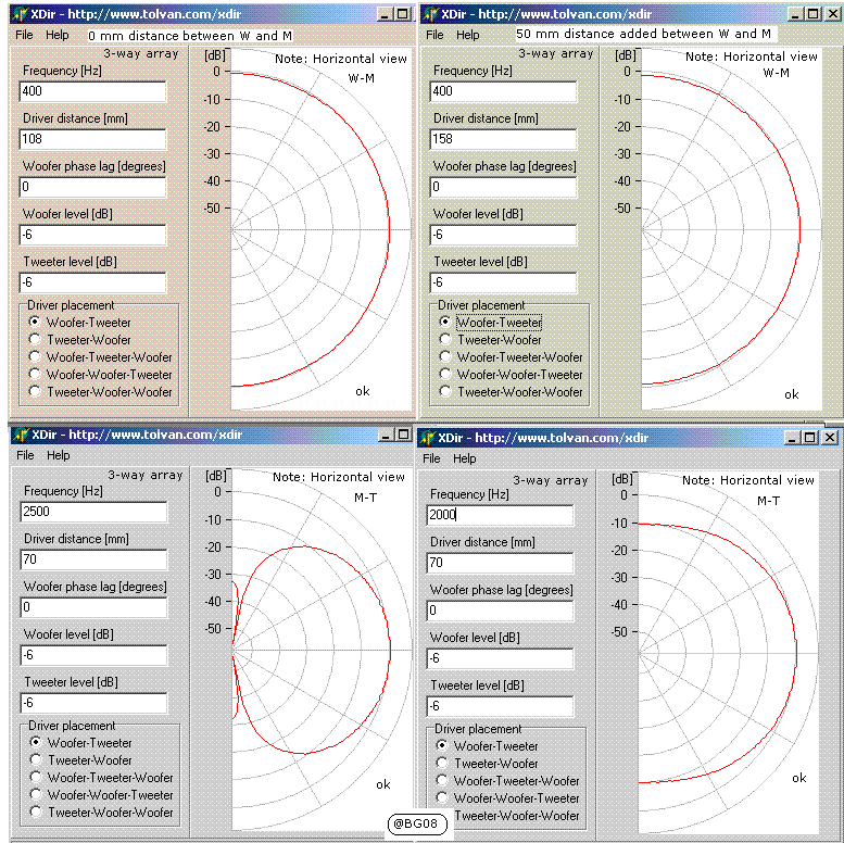

Bjorno, thanks for those simulations. Unfortunately, I'm not 100% certain of what I'm looking at, but I think I get the idea.

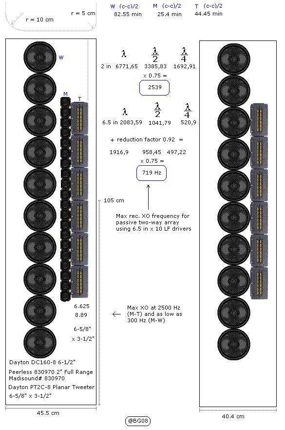

First off, I'm going to scrap the entire idea of building the LA's with the Dayton Classic drivers. Not only are they too large, but they also have those midrange issues and will not match up to the Dayton planars properly.
So what I think I will do now is this...
I will buy a total of (20) GR M-130 drivers and a total of (15) Dayton PT2C-8 planars. The left and right channels will each have EIGHT woofers and SIX planars, the center channel will be exactly half with FOUR woofers and THREE planars.
This will keep me in budget (just over $1k for drivers alone), will provide better performance due to the better quality woofers, they are smaller and their C-T-C will be closer allowing for a higher xover freq to match up with the planars (2kHz), will be a nominal 4 ohms for the main channels (nominal 8 ohms for the center channel), the main channels will probably extend down into the mid-30's pretty well, and will be like the smaller, cheaper baby brother of the GR LS-6. :thumb:
From the looks of the plot on GR's website for the M-130, even off axis, a 2kHz xover point looks to be well within reach as the driver seems to be flat at 2kHz. Since if I am staying with the Dayton planars due to their price and performance, I am stuck with a minimum xover point of 2kHz and from what I gather, C-T-C spacing with 5.25" drivers at this freq shouldn't be an issue anymore.

C-T-C @ 5 1/2" will be asmaller issue at 2 Khz for sure... it's just whether or not you'll hear the lobing. It will definitely be an improvement over the 6 1/2" 'ers, though. wavelength @ 2100 Hz ~ 6.5", and ideally you'd like to keep the ctc distance well below that... to minimize irregular response... that's the problem

Nice project! And somewhat challenging as well, given your budget constraints. Some comments:
1) Given that you will use the DCX2496 as an active x-over I would not bother with impedance-flattening. As long as you take the time to measure the response of your implementation any deviations due to changes in impedance can easily be corrected with the EQ of the DCX. This will also keep passive components out of the path of these drivers, bettering amp control over them. And, at least if fed by a 24/96 source (using the SRC2496 as a frontend will achieve this) the DCX is highly transparent even at quite high levels of EQ'ing.
2) Although the M130 and PT2 combination should work well, you should try to avoid cutting the length of the lines from your suggestion of (at least) 12 + 8 per channel. To achieve line source behavior at lower frequencies (which you will want) your woofer-line should cover about 70% of the floor-ceiling distance if possible. Also, experience seems to indicate that using tweeter-lines of about the same length as the woofer-line leads to a more 'right' sounding array (probably due to a better balance in frequency response between direct and in-direct radiation).
3) The center channel is tricky, and you may be better off leaving that for later. This is because: a) Going with PT2 mounted horizontally you will want a line that is at least as wide as the width of seating for viewers = a very large center, b) Mounting it vertically you can only use 1 tweeter (which, in the case of the PT2 will have to be crossed quite high to keep up in terms of demanded SPL), more than that will get you in serious trouble in terms of cancellations at certain frequencies, and c) You may not need one as the sweet-spot of the arrays will be a lot larger than what you are used to. This is particularly true if you angle them quite aggressively (crossing in front of listening position could work out well) as this will better balance the relative SPL of the two speakers when you move to the side.
