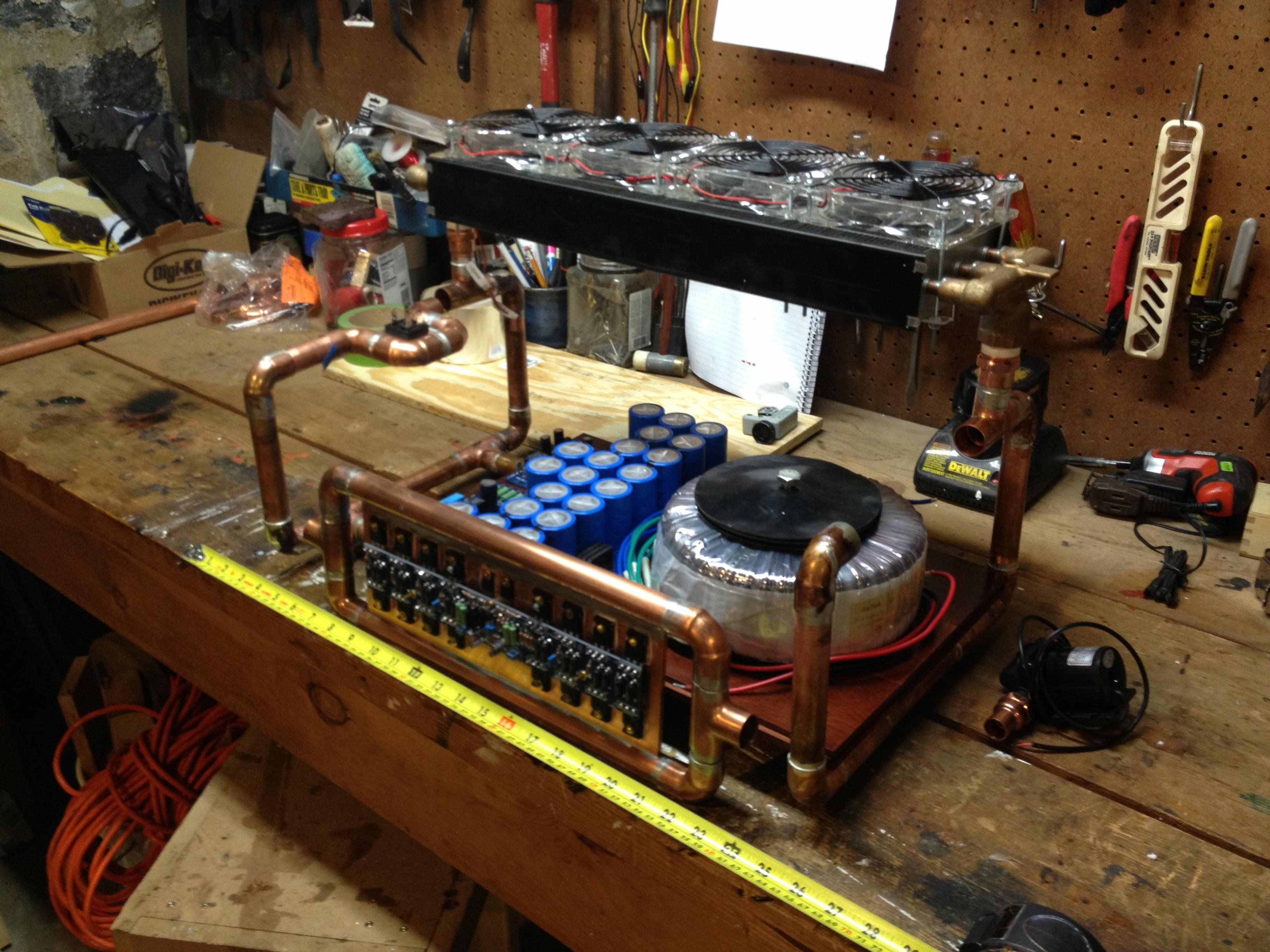

I have been away from this project for a while but now I have all the components and have started putting together the frame/cooling loop. Thanks for everyone's help, to date. More to follow.
What happened with liquid cooled F5T_V3?
1.4hp pump makes too much noise?😉
..or the fans?
..or both?

I am the OP on this thread and I know it's very old but I wanted to circle back. I never completed this build and the boards, PS, etc, are still on the shelf after 6 years. Unfortunately, life got in the way. I am now thinking about recycling the components into a 4-channel Firstwatt F5 amplifier v3. 25W x 4 to be used to drive 2-driver stereo speakers via an active crossover (digital signal processor). Doable? Will 4 channels fit in the DELUXE 4U ALUMINUM chassis?
