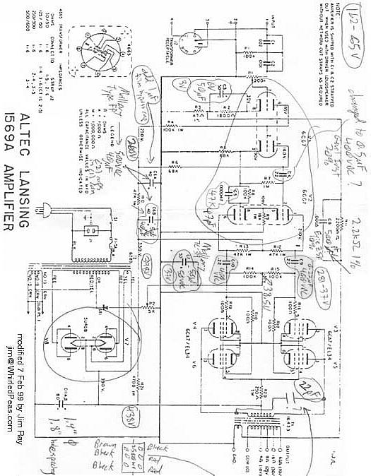

This schematic is another version of the Williamson amplifier (including the infamous design mistake- the low frequency stability will be marginal). The design is analyzed in detail in the book "Valve Amplifiers," and there are probably 10,000 discussions of every aspect of it here and at other tube forums. That's the key word you need- Williamson.
It would be worthwhile to try to find a copy of the David Hafler article in Audio where he builds the Williamson with an Ultralinear output stage like the one in this schematic. He even discusses fixing the LF problem. A little search engine work will pay off.

The problem is one of LF stability. Reducing the coupling caps from the driver to the output stage by a factor of 5 or more will help that a LOT.
As SY said, I would eliminate one RC network for better stability on low end.
Also, a constant bias of output tubes would be more efficient.
And I would decrease values of resistors in the global negative feedback at least ten times.

unfortunately, that schematic is tiny. if you have to resize it to be able to host it on diyaudio's server, try imageshack.us, they do everything i need when i want to post pics on a forum.

sorenj07 said:unfortunately, that schematic is tiny. if you have to resize it to be able to host it on diyaudio's server, try imageshack.us, they do everything i need when i want to post pics on a forum.
This one looks better, no graffity.
http://www.triodeel.com/al1568a.gif
