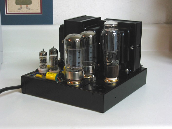

The thing I remember reading about X-rated caps 🙂 is that they're designed to fail open rather than closed, as Morse said, and that's not guaranteed with other types of film caps. I put mine after the fuse and power switch. But this topic has probably been discussed enough already.
So this resistor would go in parallel across the primaries, in series with the capacitor? Could you please explain the benefits of that? Most power line filter circuits I've seen have resistors in series with each leg of the primary winding.
What you have to be aware of though is that some, not all, X-rated caps sometimes contain a resistor as well, which make them more ideal for snubber service at the primary side of a xformer or across rectifier diodes for instance.

Plate dissipation on Sovtek 2A3s - I've read several posts where people say that they've heard that these tubes can be run at higher than the classic 15W rating. I've read some posts saying they can do 40W, I've read posts by J. C. Morrison refuting this.
The Angela schematic runs them at ~ 18W for the cascaded 6SL7 version, and below 15W for the SRPP 6SL7 version. My plate voltage is around 345V and cathode voltage is around 55V with an 880 ohm resistor, so that's 290V*62.5mA or a little over 18W.
Does anyone have first-hand long-term experience with using these tubes at higher than 15W plate dissipation? Are there any detrimental effects to doing this? How does it affect the sound to be at a higher plate dissipation (besides higher output, of course)? Also, I've read some people say they like to run tubes at lower voltages and higher currents. I don't see how I can do that without changing my cathode bias resistor, but I'm still interested in peoples' opinions on that.

NO PROBLEMA.
In series is more like it.Look at it as a filter network.
The benefit is that it will "snub", attenuate any disturbance on the mains depending on what C and R you combine which will define the frequency it is effective.
40W out of a 2A3 is whishful thinking indeed, 18W dissipation is closer to home.
The more you squeeze out of them the more often you'll need to replace the valves...just like any other incandescent device you'll burn it up faster.
Yes, same thing really...the more current you allow to flow the better they sound ( usually), in order to allow for that you'll need to lower the cathode resistor.
Understanding loadlines and tubes in general is a plus, none of that is all that hard.
Keep in mind that there really are no limits to this though,so take your time...
Cheers,😉
Cheers,😉
Hi Saurav;
I've got close to a year's running time on a set of SovTek 2A3's at the same plate dissipation as yours (345VDC B+, 55V bias) and (*knock on wood* as I type this!! 🙂 ) so far no prob. Only dead valve in the amp was an early mortality 6SL7 (about the 800hr mark). Since I run this amp for maybe 4 hours per day on average (and have more than one 18+ hour listening session on it), you can get an idea of the number of hours on those 2A3's.
When I've run 'em about 35V hotter than this (maybe 200 hours like that), the sound seemed a little brittle somehow - but the amp seemed to have a little more 'oomph' too. FWIW, I went back to 345VDC and haven't considered bumping it back up to 380VDC.
Hope this helps!
I would like to think that I have a bit of a handle on that, but you never know how much you don't know, do you 🙂 I do plan on taking my time learning things with this amp, as well as enjoying music of course. I just used the component values in the schematic, and didn't bother with plotting a load line for this amp. I'll eventually go back and do that.
So 18W is probably not something to panic about. That's good to know.
So the idea is to try to pick a point on the plate dissipation curve that's high current and low voltage, while still being linear. That makes sense. Once I start feeling like changing things again, I'll figure out the current operating conditions of my amp, and see if I can pick a better one.
Morse, just saw your post. Thanks, that's good information to know.

My PSU is 20uF - 7H - 200uF and i have the voltage right smack at 323V... but this is with 5U4G.
When i replaced the rectifier with 5AR4 i had to change the first cap to 4uF (2uf x 2). Gave me a B+ of around 321V.
Maybe this will work for you too.

Morse, a screen grab of my PSU is posted on page 6 of this thread. I have a 5AR4 with 3uF - 10H - 100uF which feeds both 2A3's, then 27K - 100uF to each of the 6SL7s. This gives me around 345V at the plates of the 2A3s, and 320 or so at the 6SL7s.

Your PSU is really similar to mine. I used 20uF->10H->100uF->27kr->40uF with the B+ taps at 100uF and the B'+ taps (to the 6SL7's) at the 40uF. Our voltages are pretty much identical as you would expect.
Only real diff is that I bypassed all my caps with series pairs of .22uF 400V film and foil caps (Daytons). It didn't make as big an improvement as did the RF filter cap, but it definitely did smooth things out in the midrange.
By the way, here's a crazy idea. I see that you're still up in the air with where you want your B+ and that's causing you some grief in terms of setting a consistent heater/cathode potential on the 6SL7's. Why not put a potentiometer in series with the voltage divider, between the 2 resistors? Then draw the offset voltage from the wiper of the pot. You'd need to do a little math to give yourself enough adjustability in the pot and make sure it can handle the 1 or 2mA of current. Just an idea, but I thought it might work for you.
*slaps his head* Why didn't I think of that? I have 100K pots left over from previous projects, and I can get the current draw down by adding another series resistor. That's perfect. Thanks!
