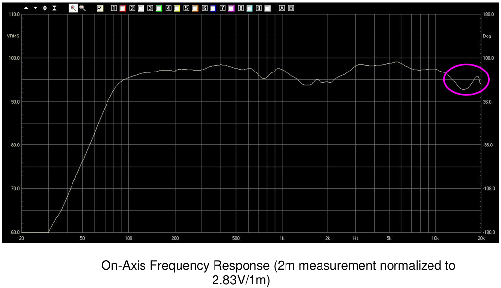

After a lot of thinking my best wanted solution considering that I listen from only 3 meters could be a small full range horn loaded above a bass box
Problem is that most of these little fr have a nasty 10dB peak around 10kHz that could sound offensive
If not I would use them immediately cut a 300Hz or so
An example of the model and frequency response you are talking about would help. Properly designed horn speakers can have mostly flat response through the treble, but they also typically need a creative crossover or equalization to achieve it. The raw/unfiltered response of a compression driver/horn is often not pretty.
Many start rolling off around 15 kHz. A high frequency resonance is also relatively common, but it's not always large or at a frequency that's likely to be intrusive. In something like a strictly pro audio application these features are often irrelevant for the use case, so those may have more ragged response.
As stated earlier, the horn and compression driver work together, so ultimately you have to look at them as a unit. Compression driver frequency response is often given based on a particular horn or a plane wave tube. That does not tell you exactly how that compression driver will behave on a different horn.
This model from the Celestion pages is a good example of top octave performance that's pretty smooth by horn standards.
https://celestion.com/wp-content/uploads/2019/10/186.pdf
