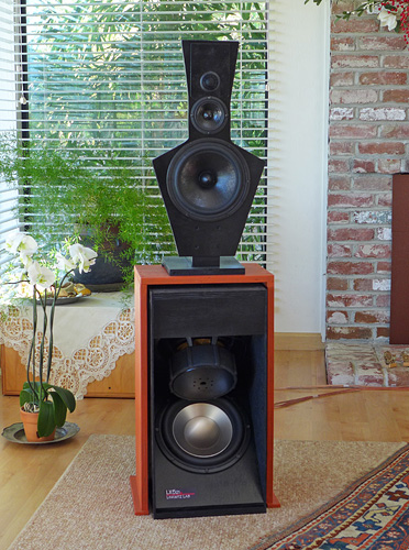

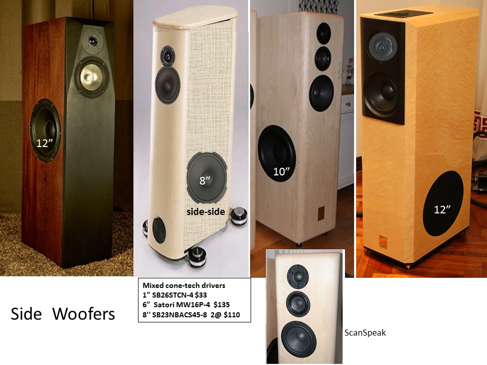

Construct a low edge diffraction distortion cabinet like 3-attached examples
Select small frame 1" tweeter and cut faceplate for shortest C-to-C spacing with midbass
Use a 6" midbass which can cover ~80Hz to 1,700 - 2,000Hz in a SEALED volume because...
Use two 8" woofers in SEALED volume for best transients and modest 11" - 12" baffle width

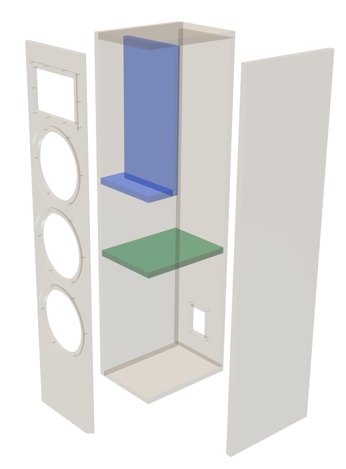

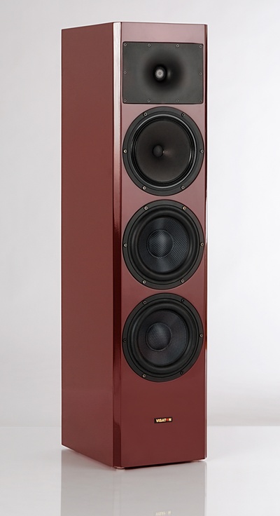

reinforcing the line of thought of Line Source, I would recommend taking a look at the Visaton project "La Belle" that follows exactly these guidelines but with a much simpler to build and also sealed cabinet.

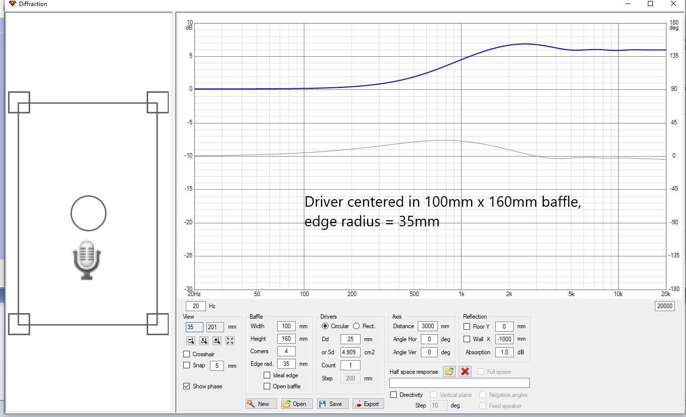

I'd think that smaller width baffles might actually be tougher to get right as it pertains to diffraction. Reasoning would be that "local", to the driver, diffractions would disrupt on axis response more than a square edged baffle of a wider width would. Some of the sim's I've seen posted here look like baffle edge diffraction would mainly disrupt off axis response first. The farther away the edge is, the wider the on axis "clean" angle seems to be. A narrower baffle, without proper edge treatment, would collapse the "clean" angle placing those disruptions even closer to on axis response. .... or am I all wet here.
The baffle step is the biggest diffraction effect of the baffle size/shape, but the "cure" for this effect is pretty much the same for most normal size speaker baffles. A gently decreasing response from 100 Hz to 1000 Hz of about 6 dB. With a passive crossover, a designer is going to do the best they can, but to think that they can exactly counteract the simulated baffle step (either simulated or measured) is rather silly. The designer will get as close as they can with the crossover tools they have (i.e. an increase in the inductance on the woofer and/or mid).

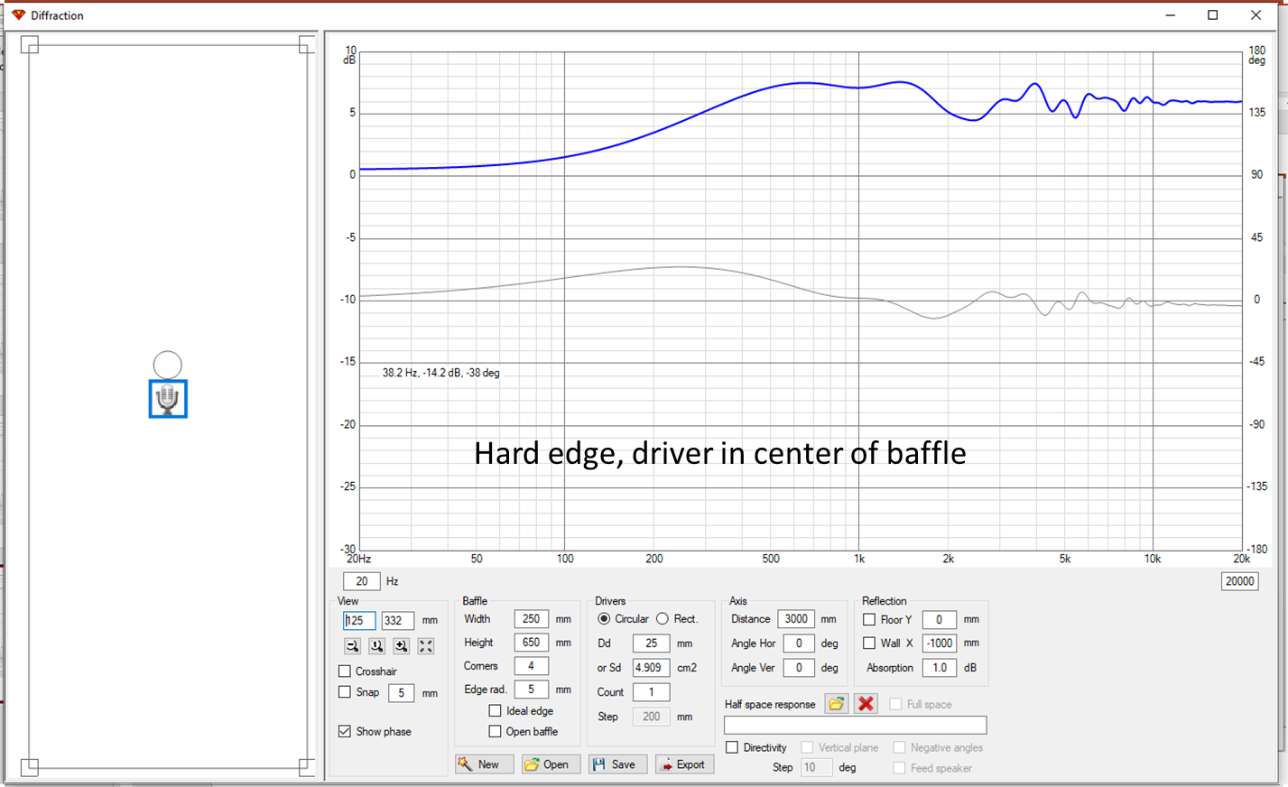

If a baffle has sufficiently radiused edges, much of the negative diffraction effects are minimized.

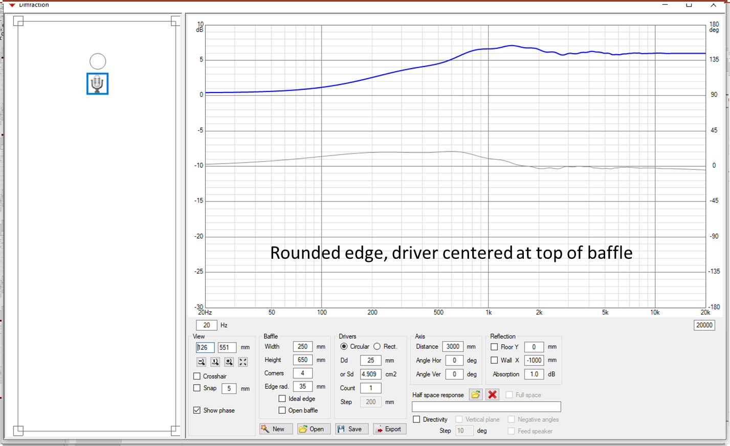

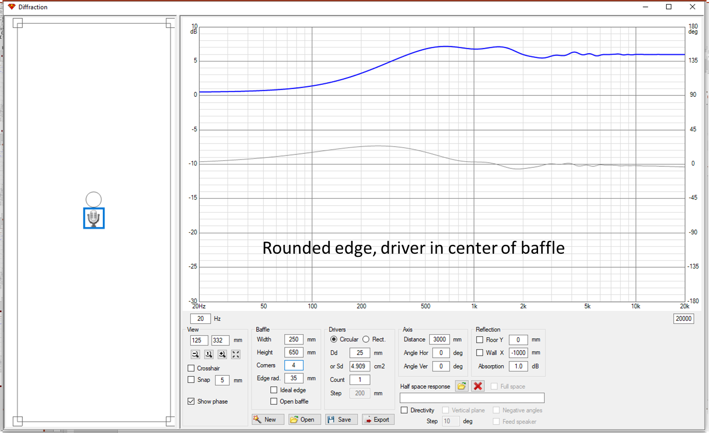

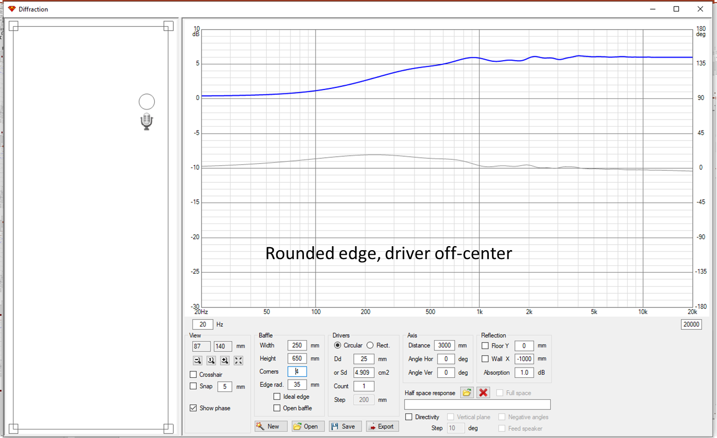

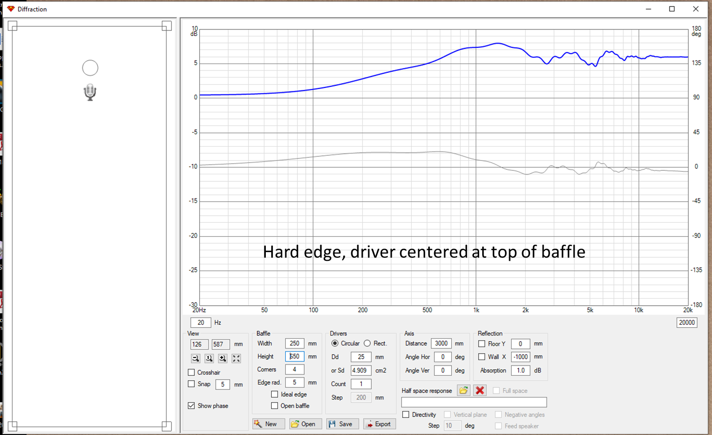

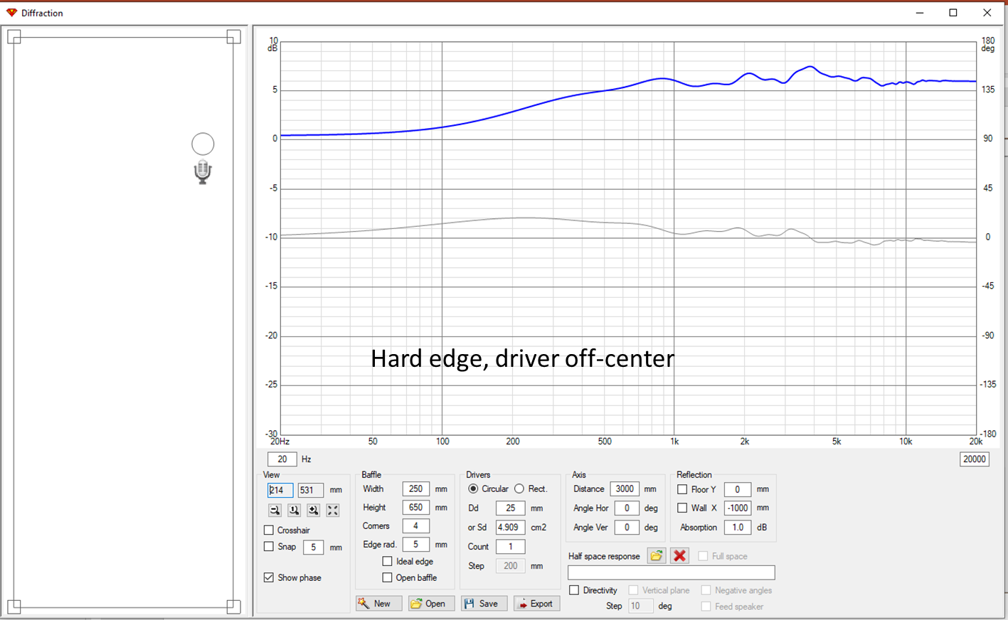

This can be seen in the baffle simulations attached. I simulated a 10 inch x 26 inch baffle with a 1 inch dome tweeter at various locations. With a hard edge (radius = 5mm), there is a ragged response no matter where the tweeter is located. To be fair, there are some specific baffle locations which smooth out considerably, but just a few "magic spots". Next I simulated the same baffle but with a 35 mm radius. Now it does not seem to matter where the driver is located. The low-end of the tweeter is mildly affected by the different baffle steps, but the raggedness of the upper response is gone.

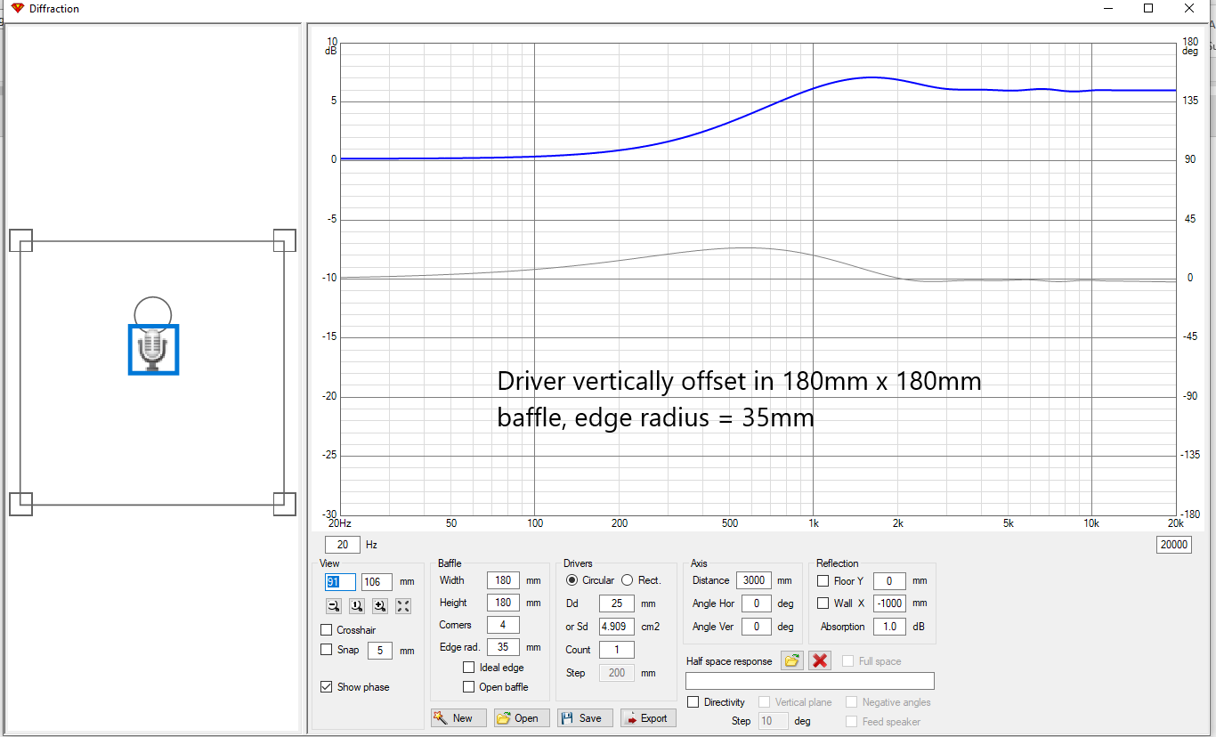

Another couple of examples of baffles with big edge radius.
The first is a 100 mm x 160 mm, with the driver in the center. There are vitually no negative diffraction effects. Playing with the simulation showed that the response stays virtually the same no matter where the driver is located on the baffle.

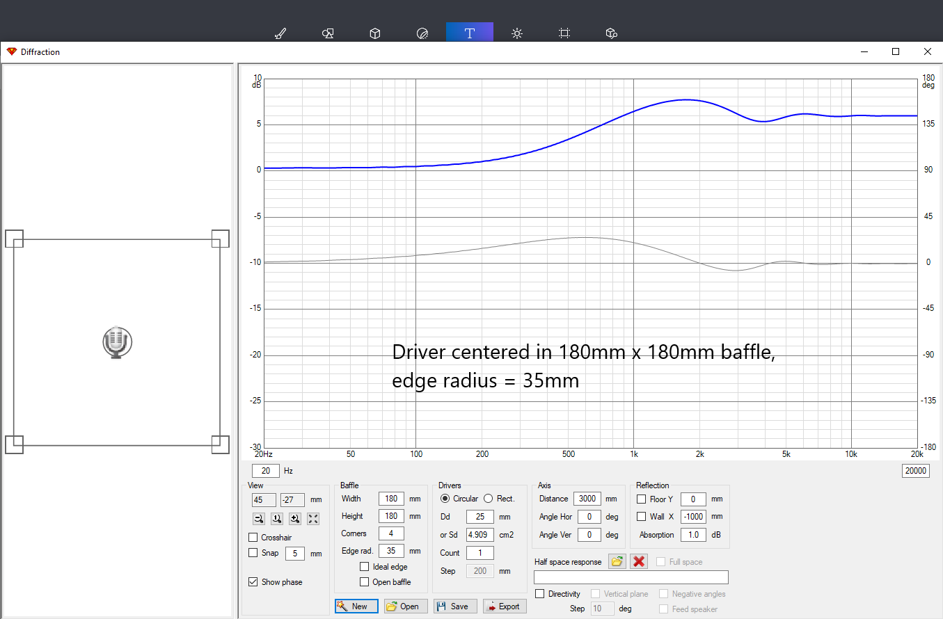

The second has the driver centered in a square baffle 180 mm x 180 mm. Being in the middle of a square baffle should be a poor design, but the response is nice except for a 1 dB dip at 4k.
The third shows what happens to a square baffle is the driver is vertically moved off of center. It does not take much offset to improve things, and almost any location not in the exact center results in response that looks like this.

hifijim has shown what a roundover should do, probably also addresses markbakk regarding my earlier comment.
@markbakk a lack of negative diffraction effects is considered a part of what gives a clean image.
Secondly, the frequency below which the sound is headed for the room walls, is a different situation to some degree.
Diffraction and baffle step can be simulated of course. Jim's sims prove my point that a non symmetrical placement is beneficial for the on-axis response. Even with rounded or beveled edges by the way. And that makes perfect sense.

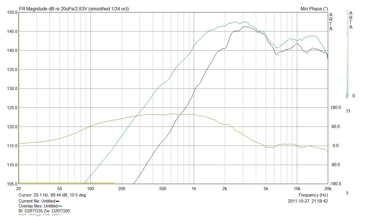

As for point symmetry: long ago I measured some tweeters without mounting them into the baffle. Two venerable Vifa units with round faceplates, if anyone cares. The 20mm dome was remarked for it's linearity by the way.
The attached result shows some things: the diffraction effect clearly leads to a ripple of more than 6dB, the summing and cancellation are quite visible, especially in the response plot of the 20mm. The 26mm dome shows the same, and even the phase behavior of this one (plotted) is slightly altered.
The problem with diffraction is that we cannot compensate for it in the crossover. Of course you can get the on-axis response right, but the off-axis response degrades.
Imho this all ends into this: roundover or bevel baffle corners where you can. And do decide whether you listen on-axis or off-axis (toed in). If on-axis, consider asymmetrical placement, because you don't have to fiddle as much to get a linear response (which will compromise the power response too). I even think that, with well-chosen driver placements, the response above the initial 'bump' becomes pretty linear.

Woofers can be mounted on the side panel to maintain a modest front baffle width or an artistic shape. Side mounting can support one large diameter woofer, or two side-side counter-force woofers. The 12" SB34NRX75-6 is designed for -F3 under 40Hz in a modest sealed volume. A pair of side-side SB23NBACS45-8 8" Aluminum cone woofers in sealed volume generate excellent transients--- sealed 1.6cuft for each woofer. -F3 ~44Hz. (-F3 ~47Hz in sealed 1.3cuft)
B&W engineering strives for the best function and creates several artistic form models before a final product. B&W top Nautilus 802 D3 uses a 6" diameter cone midrange mounted in a 10.5" diameter sphere. Reducing edge diffraction distortion is very important to creating a natural soundstage, and B&W selected the 10.5" diameter.
