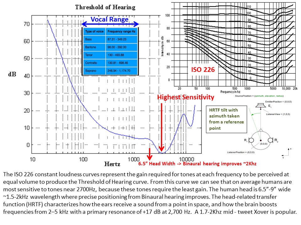

Use a 6" midbass which can cover ~80Hz to 1,700 - 2,000Hz in a SEALED volume because...
- Singing vocal range covers 87-1174Hz
- Hearing sensitivity to tone and soundstage errors increases dramatically above 1,700Hz

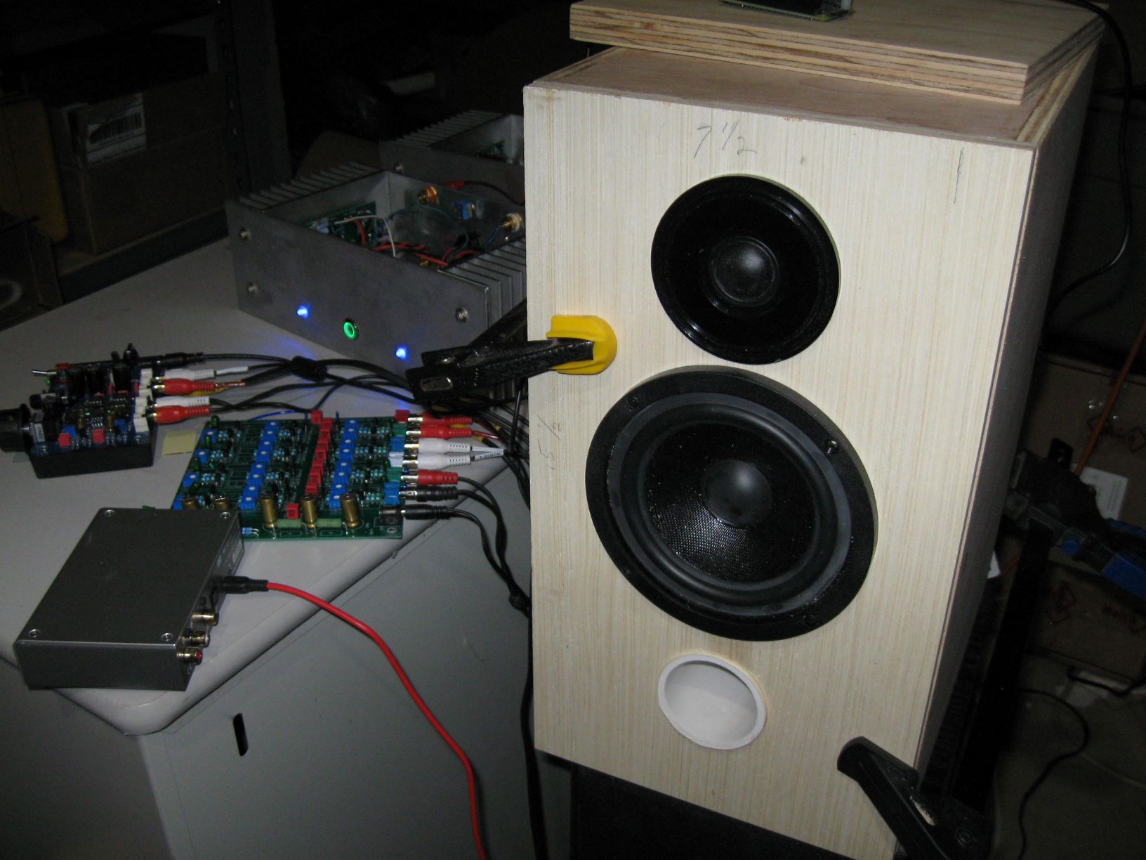

I like to listen to the baffles before I attach them permanently so I use clamps to hold them on for testing. Everything I read tells me there should be artifacts from the clamps on the baffle but I don't seem to hear it. This lets me try different baffle layouts. Usually making the baffle is the most time consuming step. I like to spend my time doing instead of don'ting. Just me
