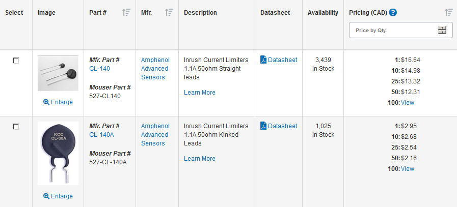

These are my choices of CL-140 (see attached). Are either of them suitable for the TR1 position? Also, any idea why the straight lead version is so ridiculously priced?
By the way, my board arrived today, George. Thank you! It is beautiful.
They are actually both the same part, the only difference is the leads.
Likely a screw-up in the data entry department.....The data sheet gives 3 different numbers, the CL-140 with plain straight wires, the CL-140A with the kink to space it off the board, and the CL-140B on tape and reel.

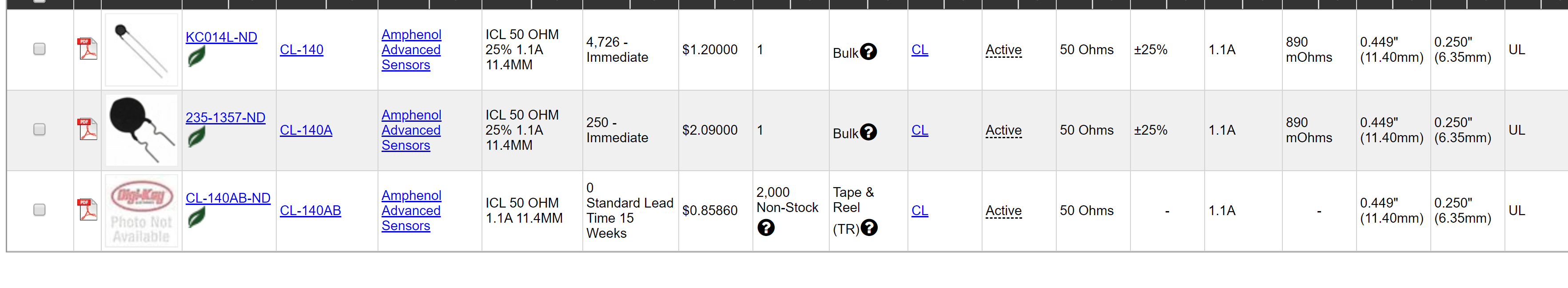

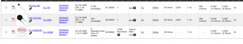

The mouser pricing seems incorrect. The pricing on Digikey appears more appropriate.
Thanks. Ya, I posted Canadian prices, so I think they are mostly correct on Mouser, except it appears they shifted the decimal point for the straight-lead version.
I sort of figured that, but I have learned the hard way not to assume anything when it comes to electronics.
Makes sense. So, since you didn't explicitly warn against using either of these parts, I'll go ahead and order the kinked-lead version.
