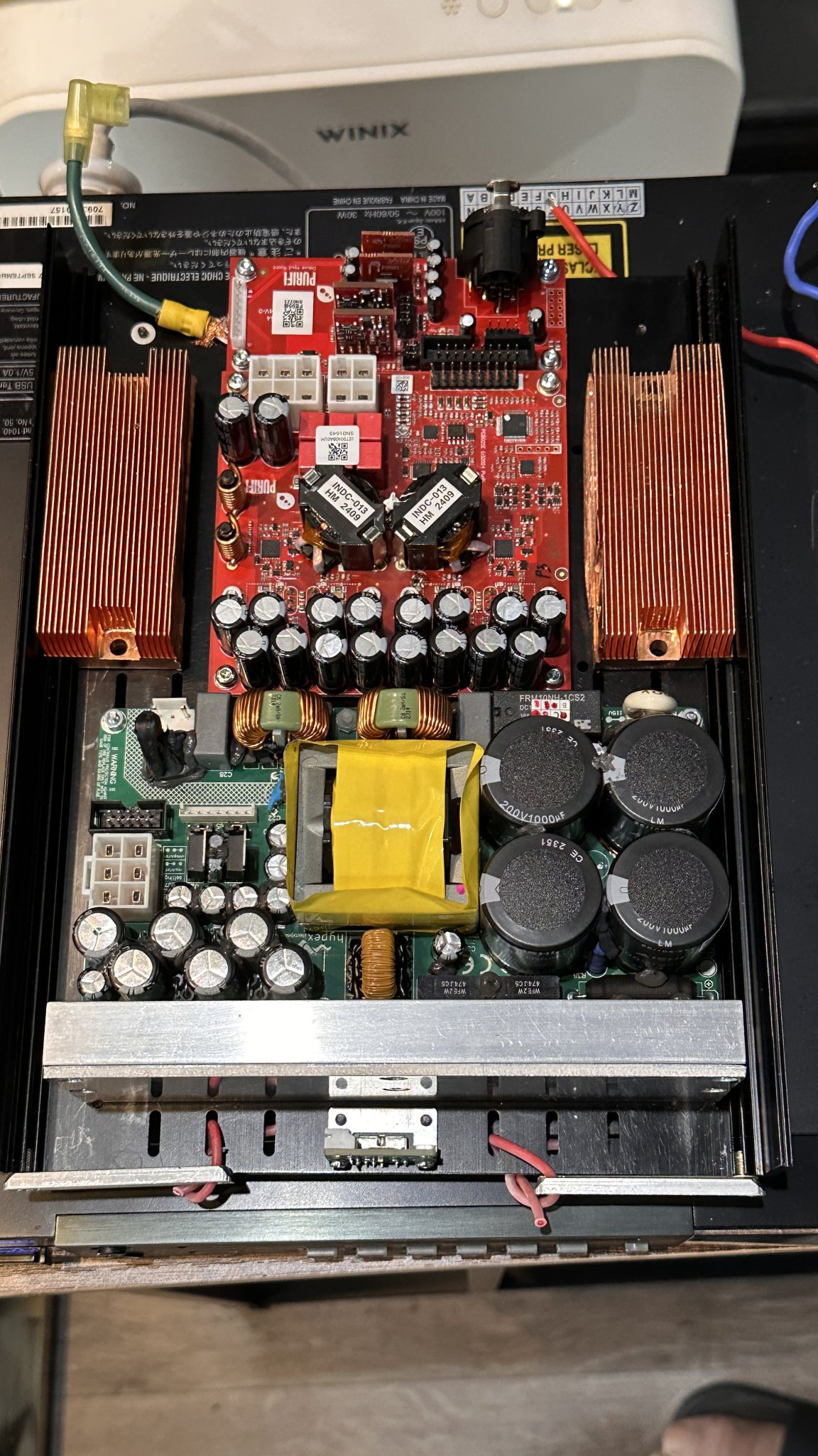

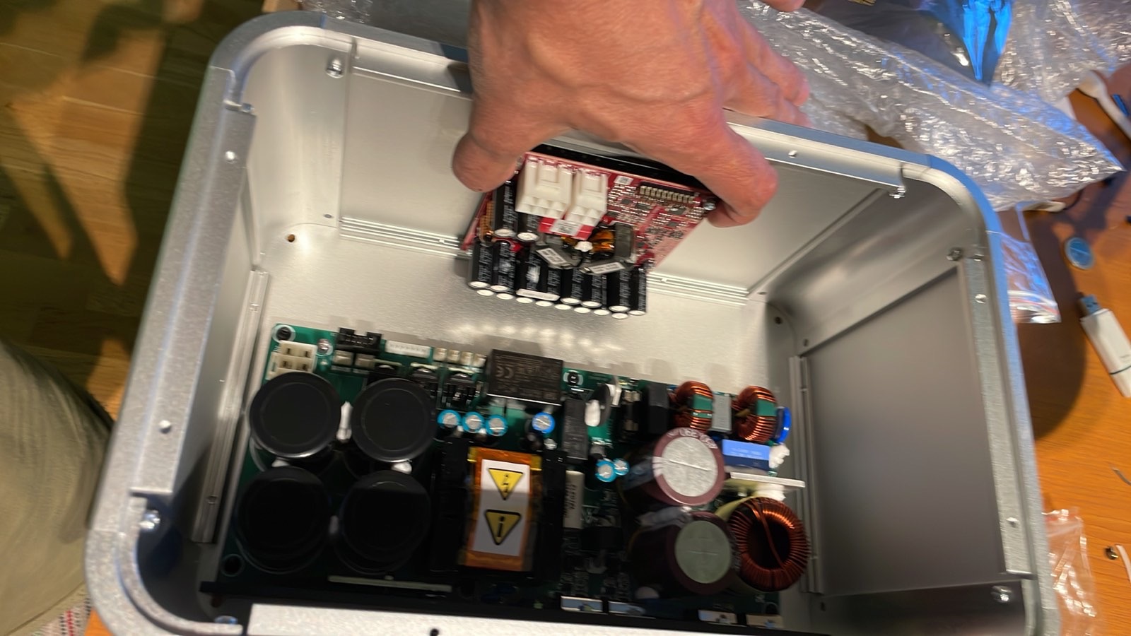

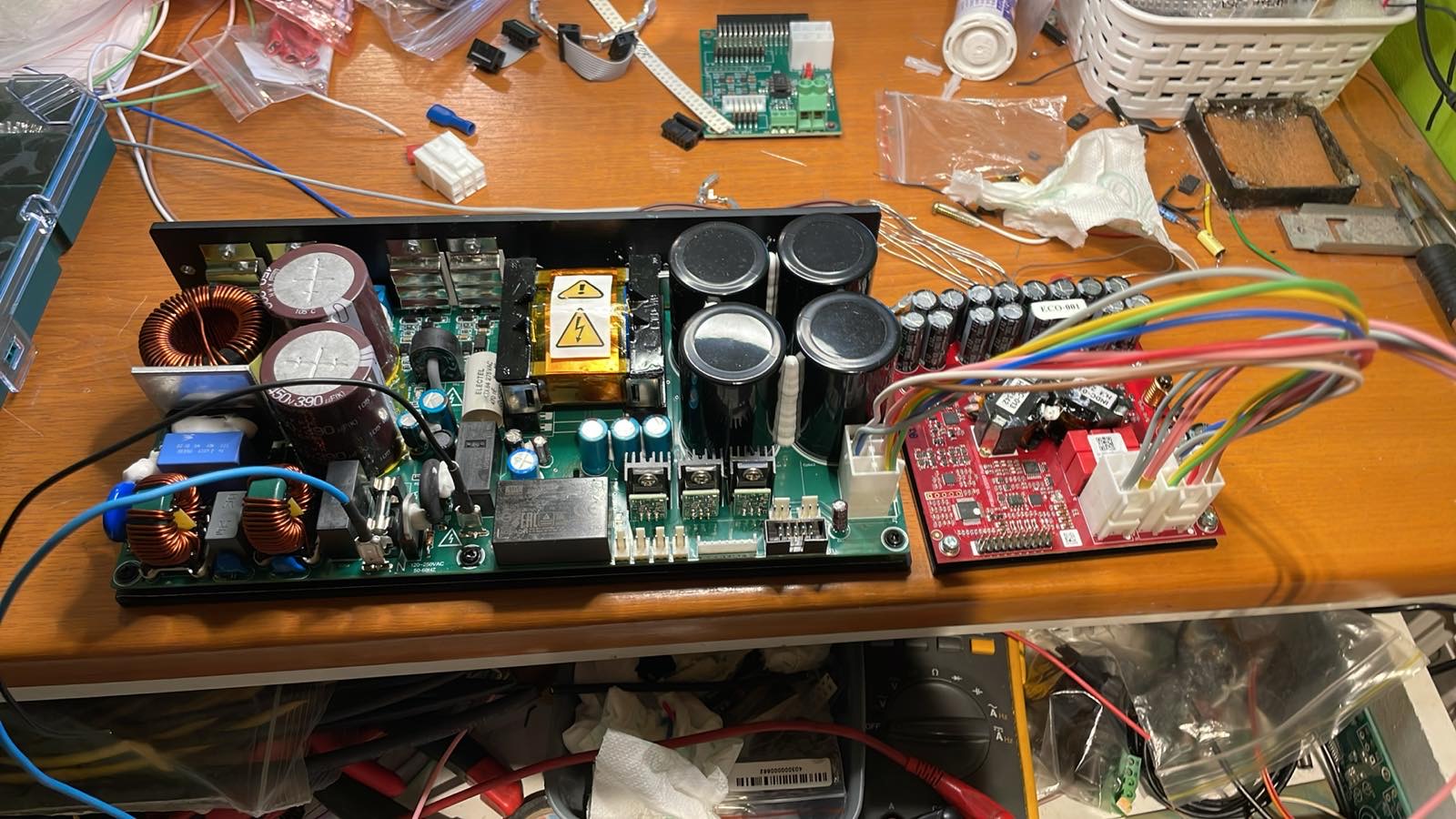

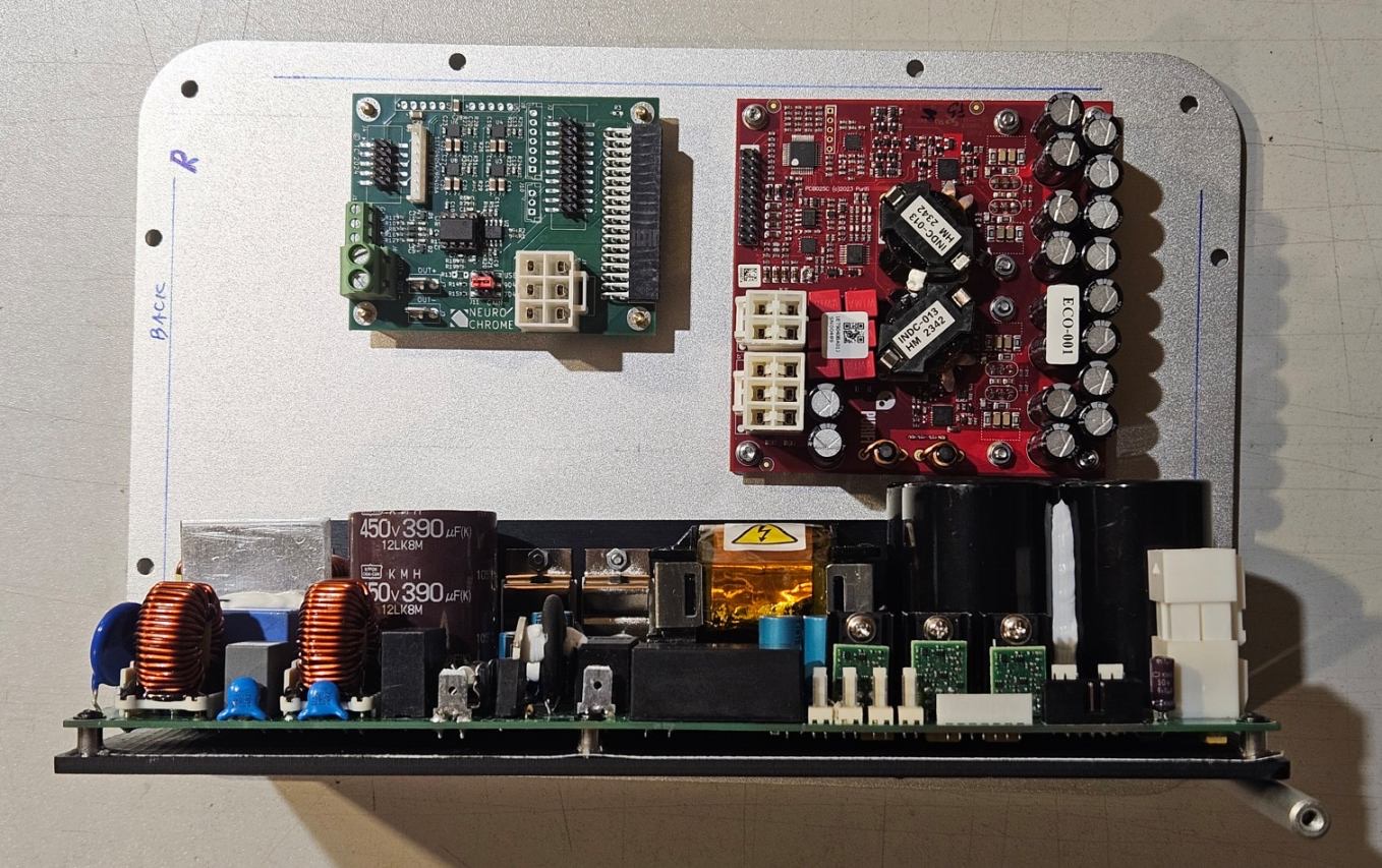

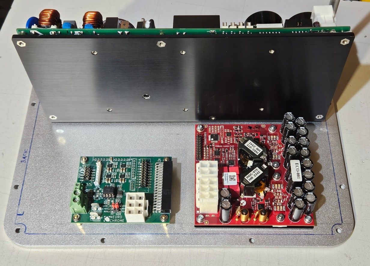

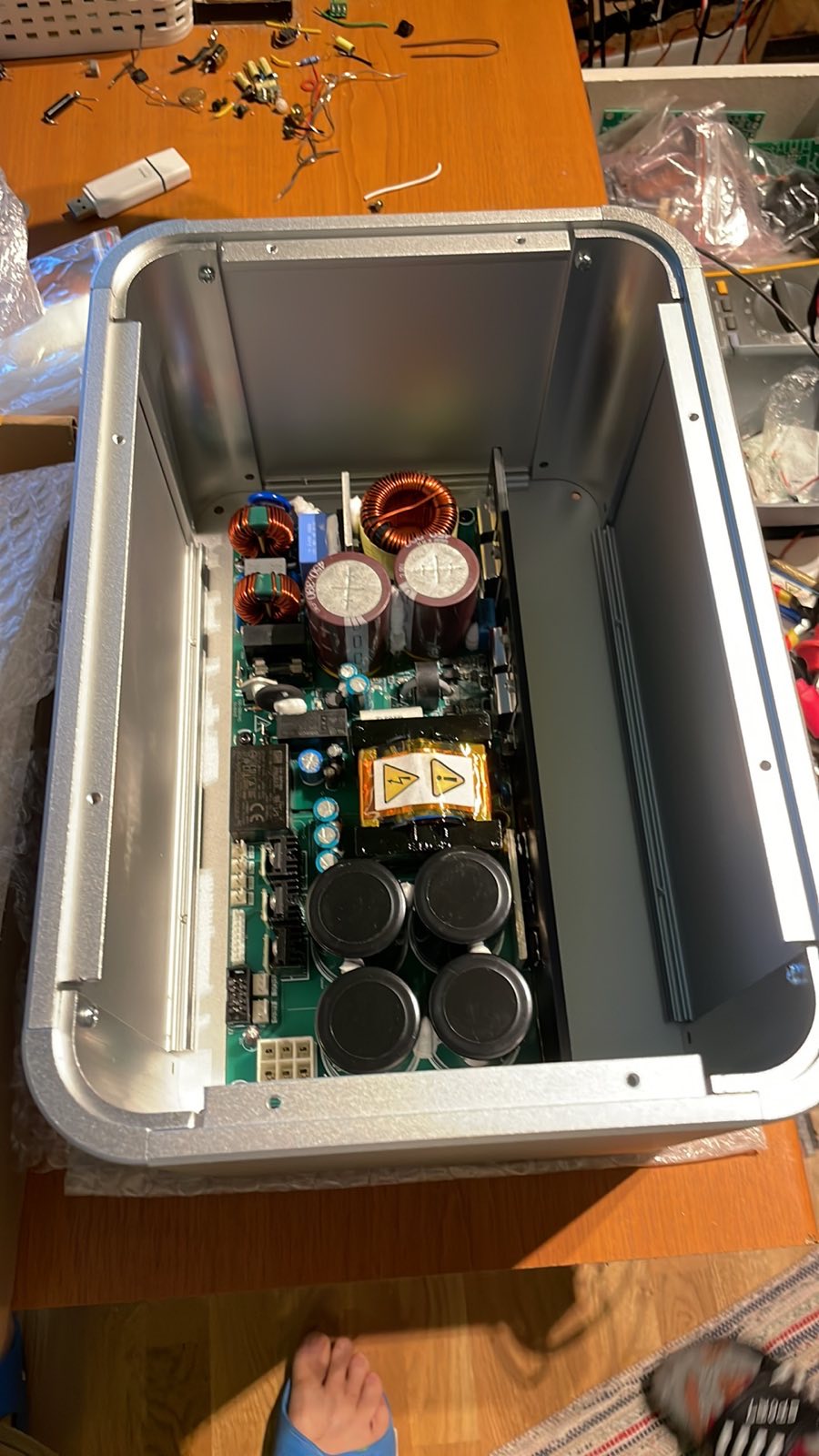

Information from Purifi on connecting the amp to SMPS 1200a180.
https://purifi-audio.com/shop/eval5-eval5-mono-1et9040ba-deluxe-eval-kit-2561/document/796
I originally left the jumper at regulated since J5 in SMPS1200A180 only provides unregulated aux and the front end is working properly.
Now I change the jumper to unregulated.
