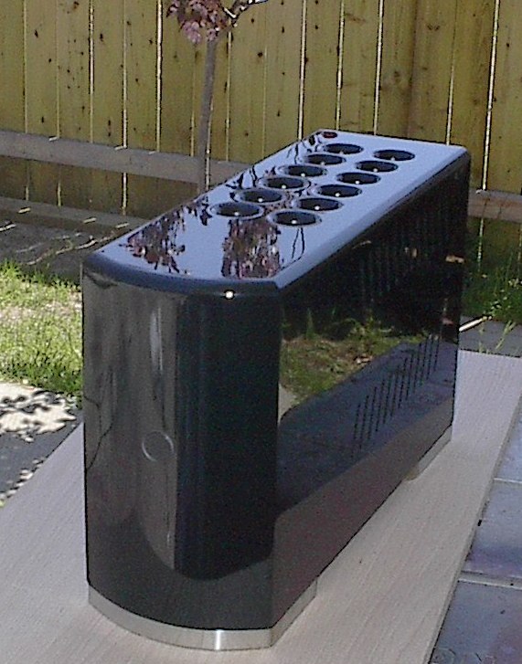

Looks like an interesting build. I've done a few curves myself.
You might want to reconsider the fiberglass wrap as it will be very time consuming to make smooth.
For what its worth, I would stack the rings to go completely through the opening, gluing them in. I'd also mount the woofers from the front, as this will be a lot easier and easier to brace the magnet.
Where the rings meet the baffle, you could use auto body filler (basically talc mixed with epoxy, except in a more convenient package) to fill and smooth the transition. Might be worth filling the kerfs with this too to increase the overall strength.
The front of this amp case is kerfed 5/16" HDF (masonite). sides and top are also 5/16" HDF.

Thanks for the response and the suggestions. You certainly might be right about the fiberglass concerns. On the other hand I'm not looking forward to cutting out twelve woofer rings out of MDF so if I had to do 24 or 36 rings in order to stack them, I think I'd really be discouraged.
As a result of the concerns you voiced I've started reconsidering an idea I had awhile ago. I could carefully sculpt the desired shape around the cutouts and MDF ring I've made already, perhaps using auto body filler to refine the shape. I could then use that shape as a plug, make a fiberglass mold from that plug, and then make twelve baffle fronts from the mold. I'd only have to carefully prepare the surface of the plug once, and if all goes well, I'd be able to make twelve copies whose surface finish wouldn't require lots of sanding before painting. I don't have any experience with this approach but it would be a MUCH simpler project than the one that inspired my thinking---a thread describing the diy fabrication of a carbon fiber motorcycle fuel tank, as described
here
I agree that filling the kerfs would be helpful. I've explored running some rubber sheet down each kerf in order to provide some damping, or I could just use filled epoxy in the way you described. I guess I'll have to experiment a bit more before finalizing a plan.
Thanks again for the thought provoking comments. By the way, I was inspired by your amp case photos in the high gloss thread. I hope to try your approach if I ever manage to get these things built.
