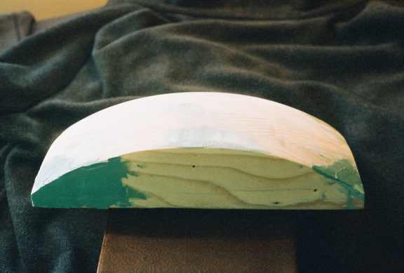

I spent about an hour today hand grinding the mold blank and it is coming up nicely. I'm going to have to do some more bondo work to fill small holes and bring up some areas near the edges that I took down to far with a rasp.

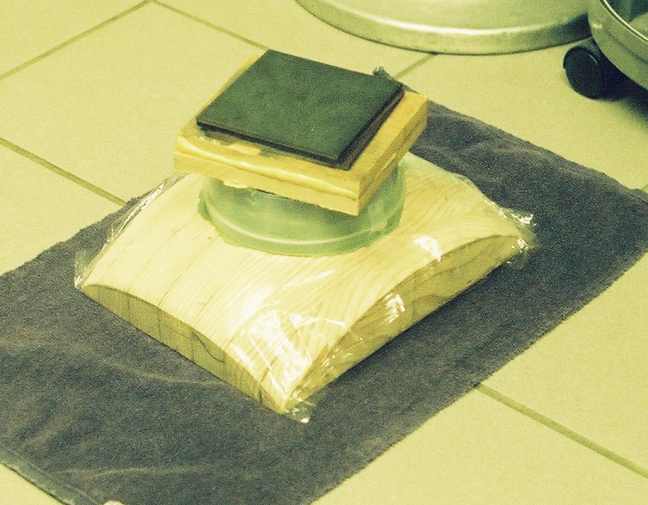

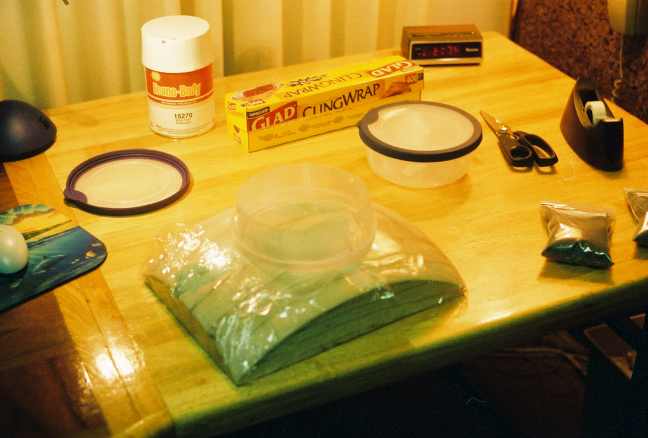

big lens progress
Here is some of the stuff I am using to finish the lens mold blank to a higher state. I found some silicon carbide powder at a nearby rock and lapidary shop. It is 60-90 grit and was 4.95 for each bag. I've also got two identical plactic bowls that I purchased at the local dollar store.
I then cut the bottom off of one of the bowls.
Hezz
Hezz

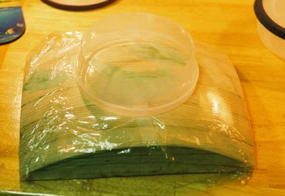

The custom made tool that we will use to grind the wood blank more spherical will be made of silicon carbide powder and polyester body filler. It is important the the tool material be about the same hardness as the wood. This is why I choose the body filler. It is NAPA economy 4.99 USD filler.
Some kitchen plastic wrap is then stretched across the surface that we have rounded with eyeball methods with a wood rasp.
The I placed the cut bottom bowl upside down on the wood blank. It will become the form to make our tool.
Hezz
Hezz

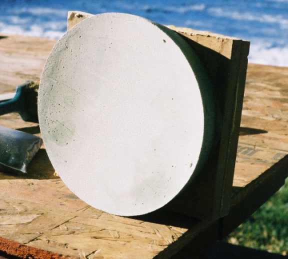

I put about 3/4 of one bag of the grit into the other bowl which was identical so that I could easily estimate how much material to mix. Then about 3/4 of the can of body filler goes in with the grit. It takes a while to mix it together well because it is very thick. This is how it should be or the grit will be too diluted in the mix. It should be a very thick dough like consistency.
After the grit and the polyester filler are thoroughly mixed it is time to add the hardener. It also must be mix in very well and should be poured in the mold as quickly as possible as the more soft it is the better it will fill in the mold.
Hezz
Hezz
Once the tool was fully hardened I glued a wooden square of MDF to the back with silicone glue after flattening the back of the tool with a file. The tool will take on the form of the curve and allthough it is not perfectly spherical it will wear down into a near perfect sphere with the right grinding technique.
Here is a picture of the tool after about an hours worth of grinding. You can see if you look closely that the tool is making contact all around the edges and at a large patch in the center of the tool. It is hard to see in the photo but if you look close you can tell. The grinding process needs to continue with this tool until it has seated all the way down and is touching on nearly all of it's surface.
Hezz
At first the tool will not grind very well by itself and I had to sprinkle about a half teaspoon of the loose grit onto the surface of the wood blank to get it going. Once it starts grinding it goes pretty fast with wood and body filler.
I used a cordal stroke going outward from the center of the lens to the sides and walked around the lens in a circular pattern. I would take about four stokes and count them and then move about an eighth of a turn around the lens and then turn the tool about the same amount beforre taking the next four stokes. This is very important because in order for the tool to wear spherical you must turn it everytime that you move on the lens. I doens not take much pressure and every attempt should be made to keep the tool from rocking as much as possible. This is easier said then done.
Because I had gone to happy with the wood rasp I had to add quite a bit of filler to the outside corners. These then have to be taken down with a file to near where the curve is supposed to be. The lens blank is coming together pretty well and I think it needs about two more hours of grinding before the tool completely seats.
Here are a couple of pictures that show the outline of the lens blank in two different directions. You can see that the curvature is becoming very round and spherical.
