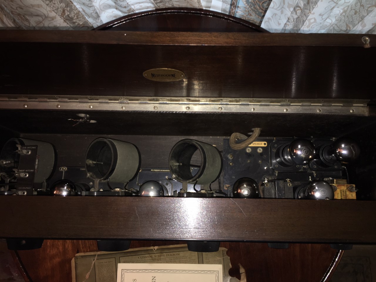

I can't Tell from the Pictures, What Brand of Radio do You now have ?? (and)
What Tubes does it use ?? Are they 01A's ??
It looks nice on the Inside and the Outside..
THANK YOU Marty

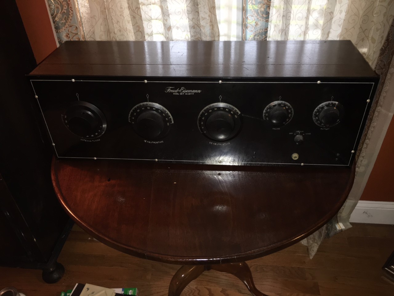

Hi Demonkleaner,
Beautiful set! I could only wish to find something in as good a shape up here. The old radios are mostly in rough cosmetic shape. Probably due to our climate.
-Chris

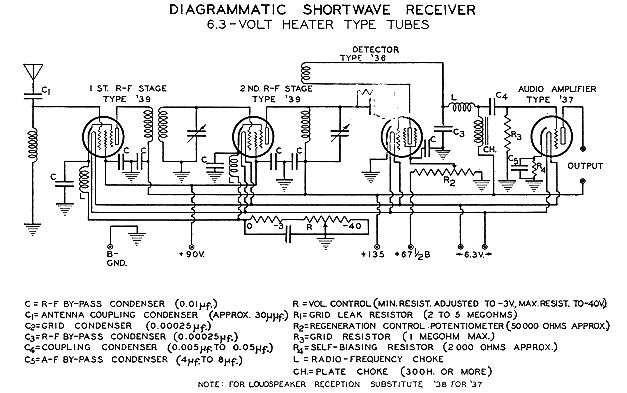

...You will have a very tough time using the 01A as a RF amplifier....
Agree--- however everybody but RCA made lots of '01 TRFs. (RCA had a better patent but their tubes were crap.)
The RC-10 '39 plan (below) is, of course, screen-grid tubes. Do you have the sockets for '39? My understanding is that the coils will be "very" different. With triodes you do NOT want big gain, it will be unstable. With screen grids you go for the gain.
And the RC-10 plan calls for an astonishing >300H plate choke. OK, with a pentode driving 1Meg, 300H is good down to like 250Hz, so that's not wrong.
I have zero doubt that you could hide a few JFETs in there and make a working TRF radio. (JFETs are screen-grid tubes without a screen grid.)

Hi Demonkleaner,
-Chris
Thanks Chris
An older collector was "thinning the herd" at a local swap meet. He has the matching speaker but didn't have it with him. Hope to persuade him to sell it to me. The battery leads are pretty much gone so that will need to be addressed. The required PS is a bit complicated but I'm working on it. It used 5 separate batteries!
Marty: Yes they're 01A's. It has two of them in parallel for the audio out. Haven't tested them yet though. Radio is a Freed Eismann model NR-7. Not nearly as rare as your Star. I did some looking and other than the radio museum photo PRR posted, I can't find anything. I have all of the Ryder manuals on DVD and nothing there either. I wrongly stated that I the Sams photofact manuals the other day. I may also have a set of knobs from a donor radio (if they're the right diameter) that may fit your set.

"" The RC-10 '39 plan (below) is, of course, screen-grid tubes. Do you have the sockets for '39? ""
Yes, I have the tubes and the sockets..
"" I have zero doubt that you could hide a few JFETs in there and make a working TRF radio. (JFETs are screen-grid tubes without a screen grid.) ""
I do NOT plan on using Jfet's, this is a Tube Radio..
The attached Schematic is the one that I am going to adapt to try and get it working..
