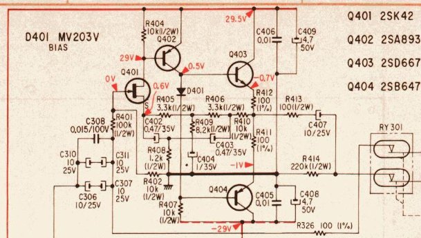

This last 'low Id' contraption is already found in the late 70's Sony TA-E86B preamplifier, it's odd 'bass boost' circuit intended for some audience.
The J-fet (Vdsmax= 12V!) runs at some 60μA without problems. I don't use that output actually.

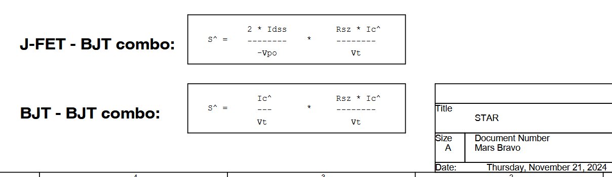

The redux is about the assumption of a high beta, so the current through Rsz is determining the transconductance of the bjt (aka 'voltage driven' instead of 'current driven').
In this case the Sziklai-transconductance boils down to a simple equation, alongside the fet-bjt also valid for a bjt-bjt combo.

It took me a full month to realize that the actual 'Sziklai Transconductance Amplification Ratio' ("STAR") is in the very second part of the formula: ... * Rsz * (Ic^/Vt), where the latter is the reciprocal of the internal emitter impedance ('re') or the 'thermal imedance'.
So the transconductance incremental secret of the Sziklai is: ... Rsz / re , alike a current mirror with external emitter resistors.
Jfet: Ssz = Sj * Rsz/re
BJT: Ssz = Sq * Rsz/re
I'm from the pre-MOS era, so I guess...
MOS: Ssz = Sm * Rsz/re
