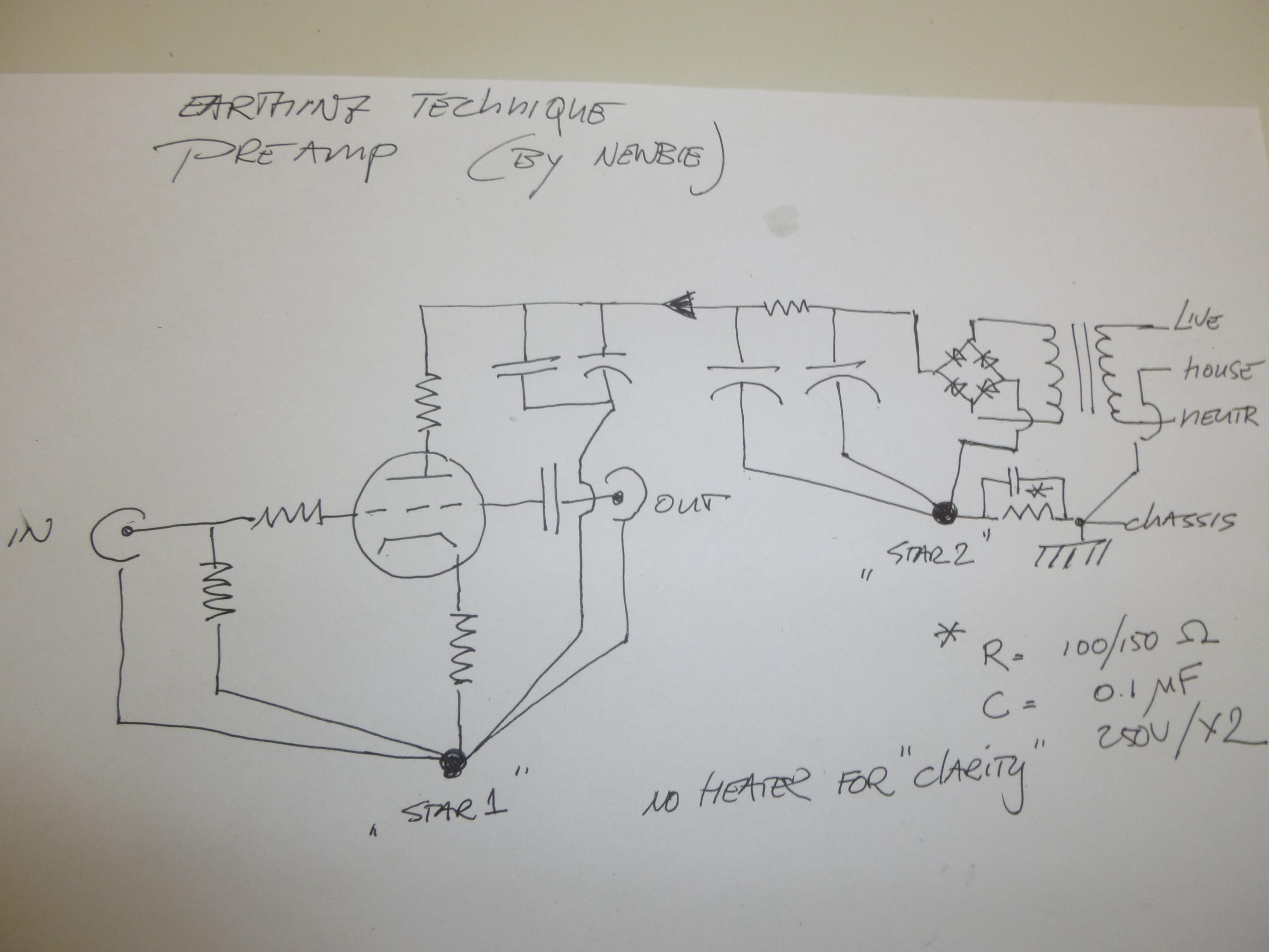

As visuals work best for me, and maybe for someone else too, I started drawing a way of earthing a simple tube buffer. Only high tension, rectification, smoothing and the cathode follower are drawn for simplicity.
I hope someone can point me to mistakes or failures.... Is this the way to do a star-ground? Am I missing something?

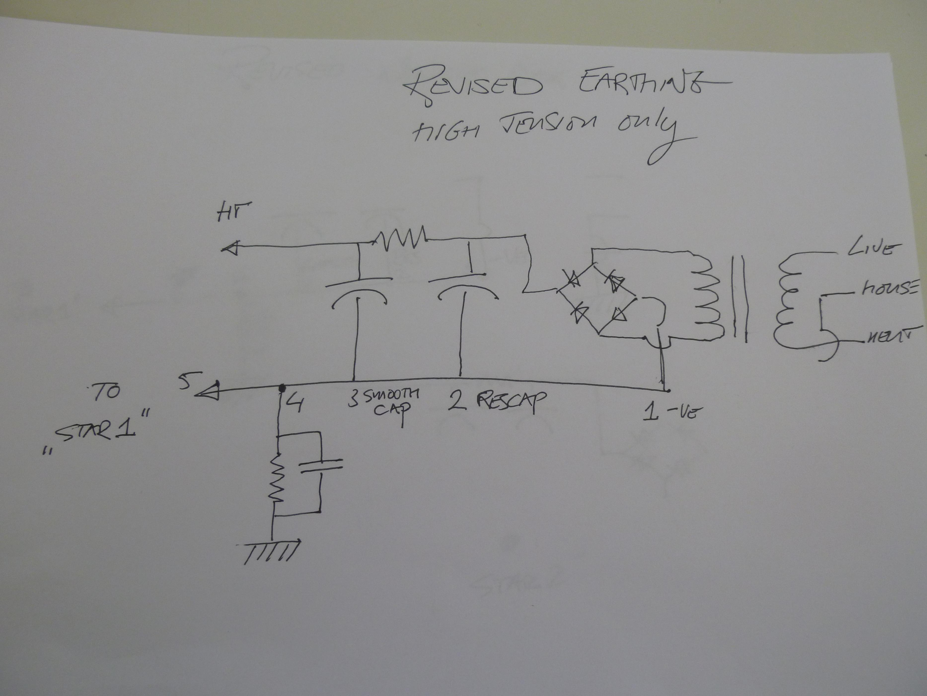

Two serious problems with that diagram:
1. no connection between star 1 and star 2.
2. star 2 guarantees the injection of charging pulses into the PSU ground.
The solution is to turn star 2 into a bus. The order along the bus is
rectifier -ve out
reservoir cap -ve
smoother cap -ve
connection to safety ground
connection to star 1
Note that star 1 could be a bus too, but it doesn't have to be.

Thank you SY,
Much appreciated! If I understand correctly, star 2 being the PSU ground, can be a buss with a specific order of attaching the components.

No. 'Star 2' must be a bus, not "can be". Your diagram looks OK now.Phats said:If I understand correctly, star 2 being the PSU ground, can be a buss with a specific order of attaching the components.

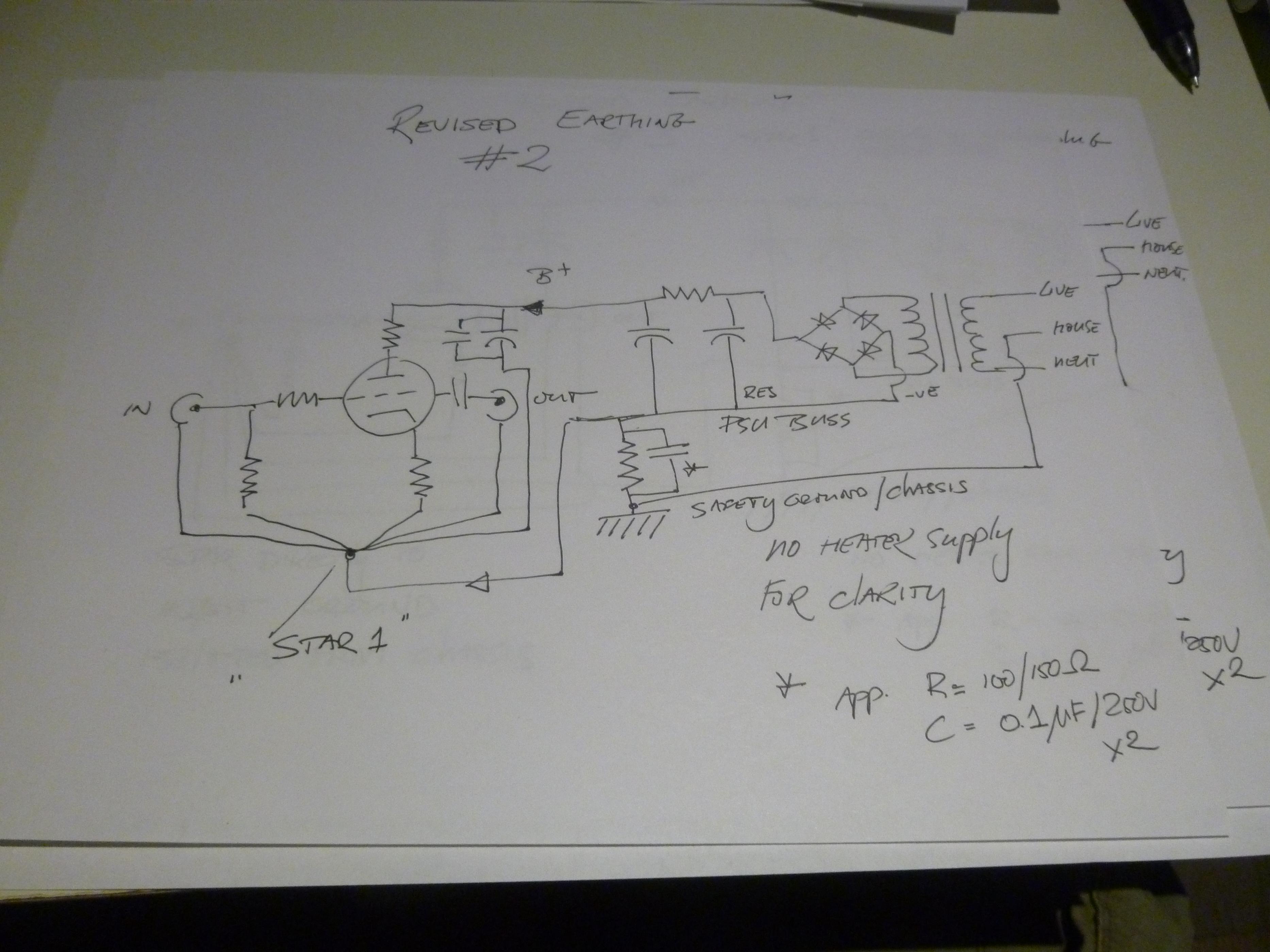

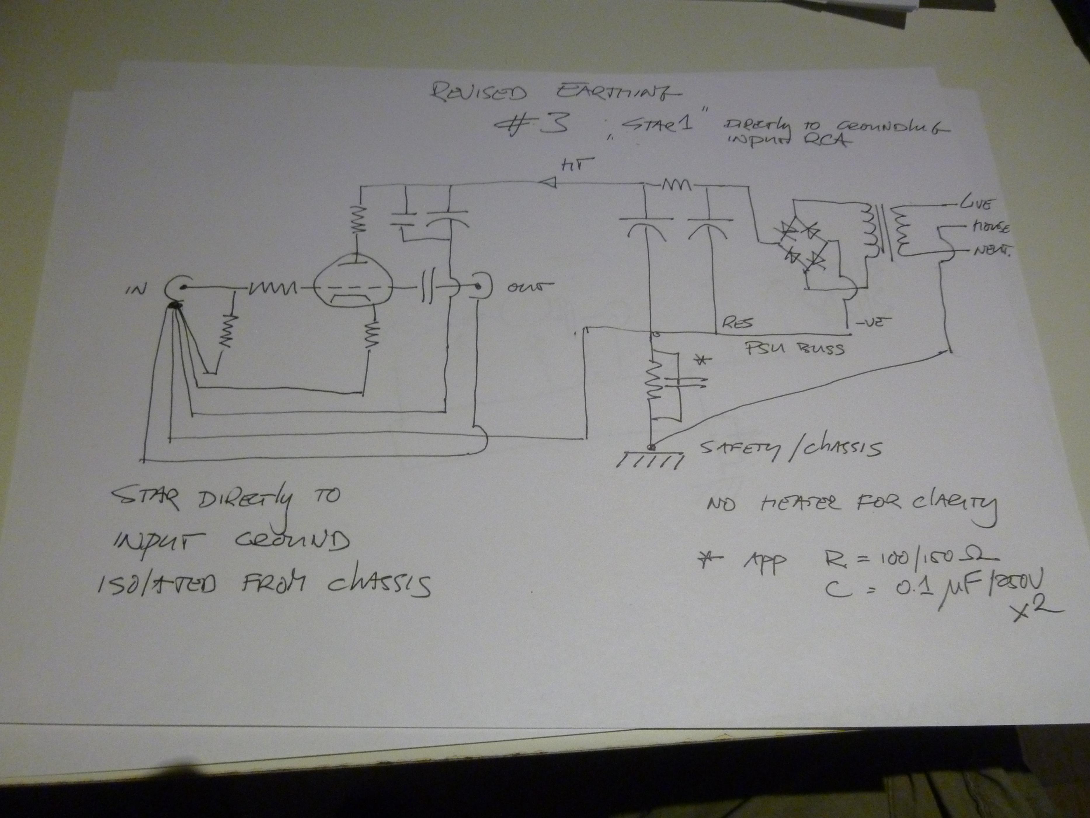

I thought it would be practical to draw DF's comments into a complete visual, hoping it would be of use to anyone. (for me it is!)
"Revised Earthing #2" is how DF commented my diagram and #3 is my deviation, an alternative. The idea is to use the input RCA's groundlug (isolating that input from chassis) as a point for star-ground 1. I read in Bruce Heran's article on grounding and shielding techniques he combined signal and PSU at that point.
Does this work in theory, I can imagine that routing this in practice is quite inconvenient.

With #3 you have "extended" the main input stage current loop all the way the the input RCA and back. ie the connection between the last Power Supply capacitor -ve and the cathode resistor. This will increase the chance of this loop picking up noise. I think you are beginning to understand that good grounding is not about having a rigid set of universal rules and more about understanding where the current is flowing and wiring your circuit accordingly using the most appropriate grounding system for each section.I thought it would be practical to draw DF's comments into a complete visual, hoping it would be of use to anyone. (for me it is!)

#3 means longer wires, and is unnecessary. Go with #2.Phats said:"Revised Earthing #2" is how DF commented my diagram and #3 is my deviation, an alternative. The idea is to use the input RCA's groundlug (isolating that input from chassis) as a point for star-ground 1. I read in Bruce Heran's article on grounding and shielding techniques he combined signal and PSU at that point.
All real stars are in fact a short bus. The advantage of a 'star' is that you don't have to think so much. I prefer to use a bus.As an extra alternative, what are peoples thought on 'buss-grounding' contrary to 'stars'. I mean, routing one bare rod from input to output groundlugs. And (of course I am talking P2P wiring) per stage joining the negative leads to one point, nearest to that stage, at that buss.
