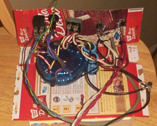

Current Status (PIC)
As of tonight, I have successfully tested the lab supply. Thanks for the help thus far.
The next phase is finalizing the component layout so I can begin the chassis fabrication. The current wiring is subject to change, pending suggestions for an improved layout.
The following pic, plus those available at the link, are indeed the proposed layout put together on a cake box. I figure a few laughs are in order.
Anyway, any comments on improving the physical layout, such as relocating capacitors, re-routing wiring or moving this or that would be appreciated.
Thanks for the continuing help.
S.
PS: The high res pictures are on my site at:
http://tshouston.net/labsupply/thumbs/labsuppl.htm
. . . not wanting to waste DIYA's bandwidth!:goodbad:
