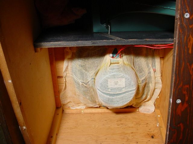

Yes, they will have both even and odd harmonic eigenmodes, so normally stuffed with polyfil/whatever and more recently with shredded jeans becoming popular. I grew up with fiberglass insulation and would us it today if still building since you don't need as much for a given stuffing density.
Regardless, as Perry noted you want to insure it can't get into the open back driver, i.e. historically with cheesecloth loosely draped/stapled over the driver(s).
Some general guidelines for stuffing.
