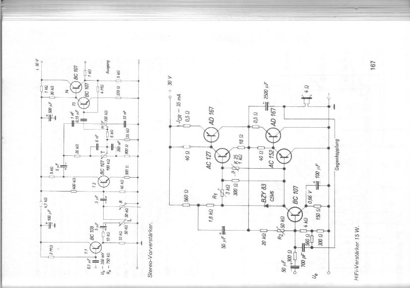

hello.
found an old schematic (hifi-nostalgia).............
they are all similar,like today............
greetings..............

I have assembled both during the seventies
Was a brazilian Kit.... the union of Phillips, Ibrape and Miniwatt resulted into a big company that started to sell audio kits.
Ibrape was "Brazilian Industry of components"
And Miniwatt was a division from the Philips factory that made electronic tubes (valves)
and those schematics you show were used...i have assembled both down the seventies... sounded fine for those days standards.
Inspecting the circuit i found some differences...the output used here was matched AD161 and AD162... drivers was AC187 and AC188 and supply was 24 volts DC.
