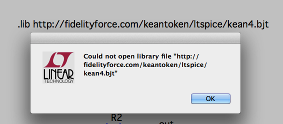

First, see if you can download the file in your browser using this:
http://startfetch.com/keantoken/ltspice/kean4.bjt
If not, then it is a problem with the server or with your network. If you can download the file, then it's a problem with LTSpice. If you go to Help->About, it will give you Mike's email address and you can send him a report.
It is getting downloaded as "kean4.hmt"
edit: It could be renamed as kean4.bjt and opening in word pad normally.

That's strange - could LTSpice be going through Explorer to do this, and Explorer is automatically renaming it? Try this:
Code:
.lib http://fidelityforce.com/keantoken/ltspice/kean4.bjt
And if that doesn't work, try this:
Code:
.ferret http://fidelityforce.com/keantoken/ltspice/kean4.bjt
.lib kean4.htm
I assumed you misspelled .htm to .hmt, but use the extension that it gets when downloaded.
Try it again now. The webserver was changed so the file wouldn't try to display in the browser; that may what cause it to change the extension to .htm.

I just tried again and got the same error. I'm posting a screenshot for illustration.
You'll have to ask Mike about it like I suggested. Does kean.bjt appear in the schematic directory?
I emailed to linear, I guess that generic address goes to mike. On the mac there is no "about" option under the help menu, it's somewhere else, but I found it and got that address. We'll see if something is done to fix this.
I forgot to mention earlier, but I only get the error and no file gets downloaded anywhere.

Today, when I clicked on it, kean4.bjt is getting downloaded directly.

Yes, the server configuration changed. You can try the simulator directive again to see if it works.
