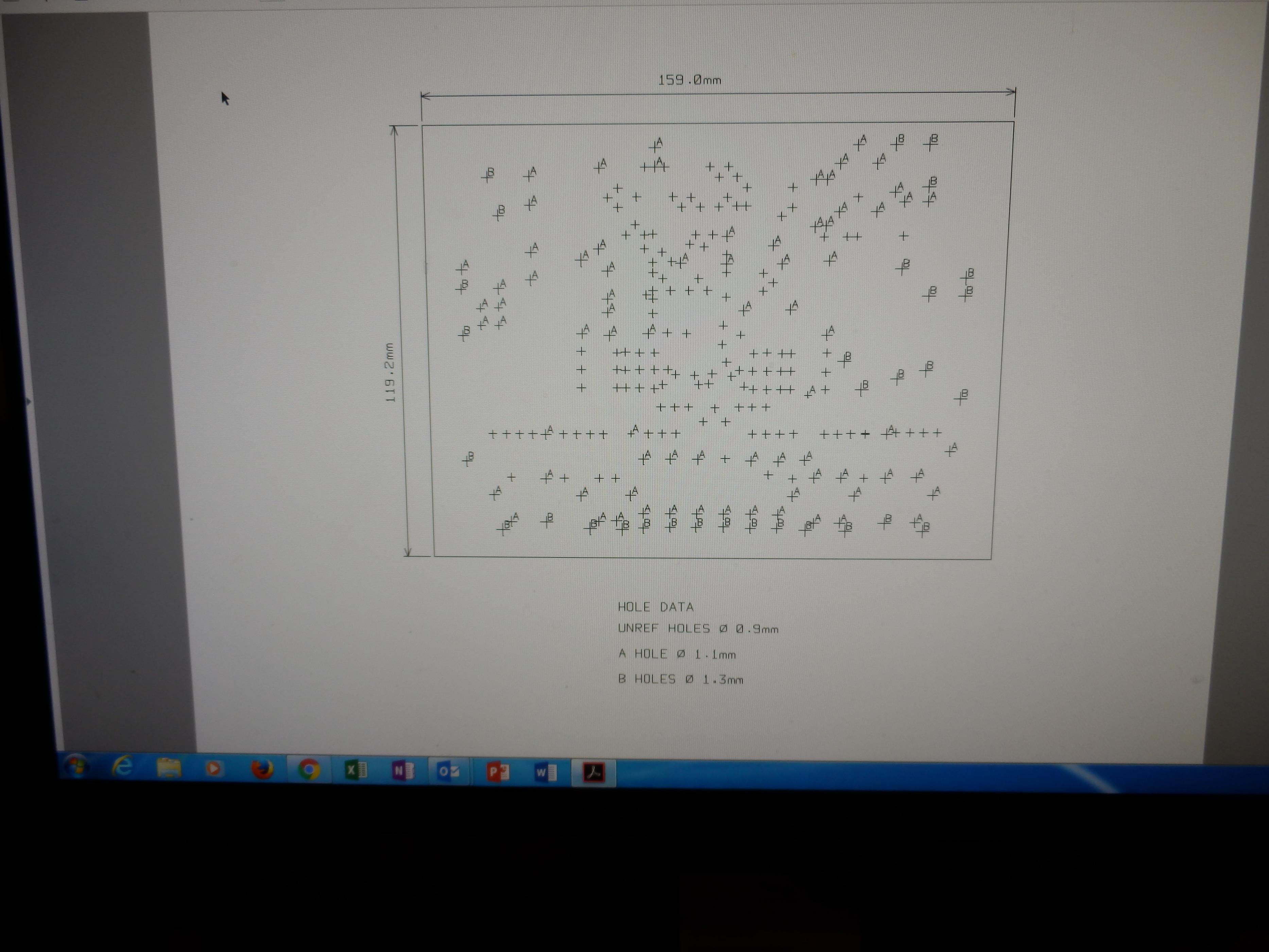

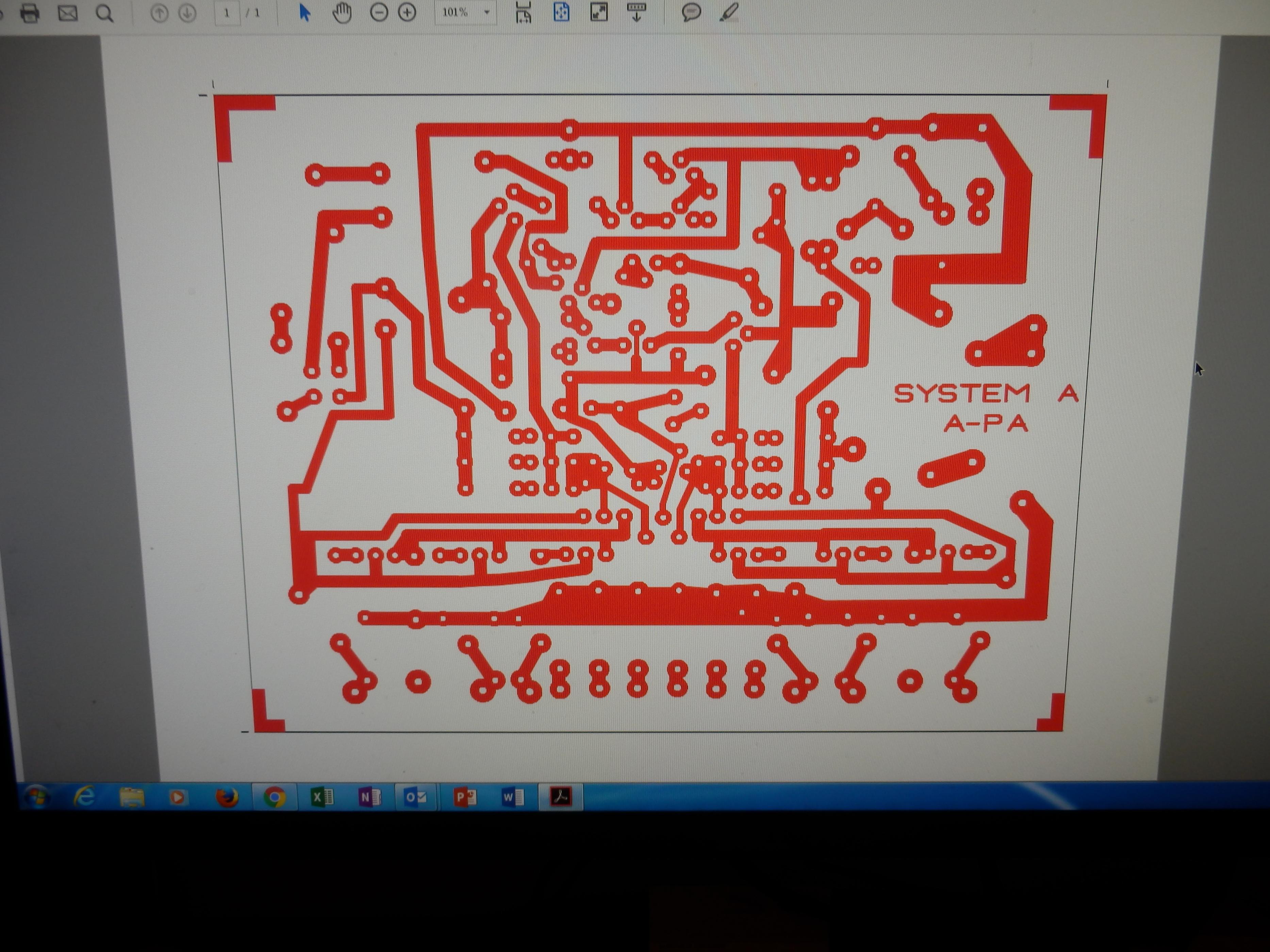

Hello .. new post
I have started the construction for this amplifier .. now that I have listened to one, well impressed
so the 1st thing to do is make the original PCB with the appropriate gerber files
regards
regards
class a pcb
so a small review before gerber generation
