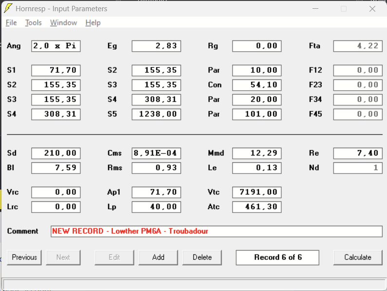

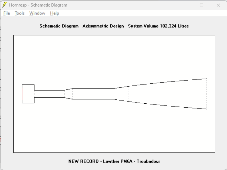

i do have a pair of Lowther PM6A equivalents made in the early 1970s, which i had reconed by Stefan Stamm here in Berlin 10 years ago. I´ve been using them in a MLTL design as recommended by martin king, which i didn´t like too much. I preferred the sound of the original Acousta enclosures, even though they had been built very poorly.

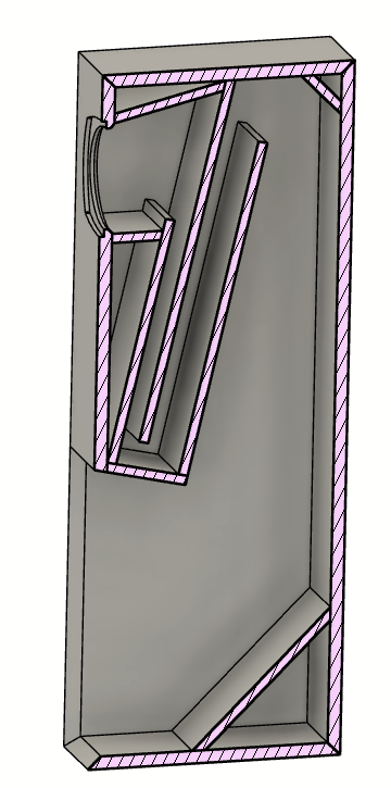

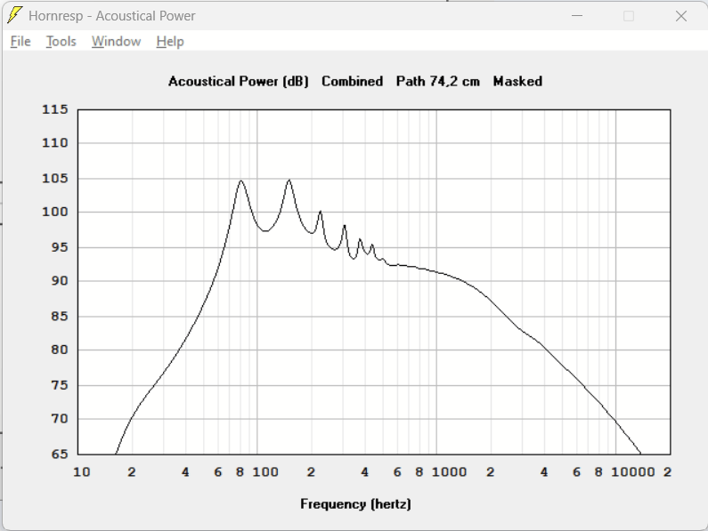

Now i want to try something new since i do have access to a proper workshop currently. I found a LothX Troubadour design, which was supposed to work with Stamm drivers, i don´t know too much about. I did remodel it in CAD and took its dimensions into hornresp. Since i never used hornresp before, i am a little bewildered by the results.
I am very unsure if this is a viable backloaded horn design for my lowthers. What do you say?
