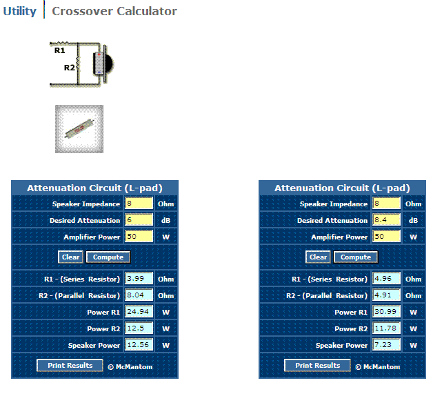

Here is a tip that I use ... purchase a set of L-pads. Adjust them to attenuate the tweeters to a level that matches the woofer.
Remove the L-pads, and measure the DC resistance of both the series and parallel legs.
Then wire a fixed resistor L-pad with the same resistances.
If the measured resistances do not exactly match fixed resistor values, just use the closest available values.

If you can get your hands on some cheap 10 or 20W cast resistors, and if your tweeters are 8 ohms, try using a 4 ohm in series and then an 8 ohm in parallel. That will reduce the power to the tweeter to 1/4 of the original or 3dB attenuation. If that still is not enough try a 5 ohm in series and a then 5 ohm in parallel. Unless there is something really mismatched, you should be OK with one of those two. Remember you can't just add resistance to the circuit or you will change the crossover frequency.

I am just a bit confused - do i put 1 resistor in series with the 1 in parallel, or put the series resistor in first, check how it sounds, then take the resistor out and put 1 in parallel with tweeter??

1.
R1 = 4 (series)
R2 = 8 (parallel)
2.
R1 = 5 (series)
R2 = 5 (parallel)
Note: ...and please don't touch the mains switch.:att'n:

Yes you wire them like Inductor has shown but you do so after the cap and before the tweeter so you may have to de-solder the existing cap to fit them in.
