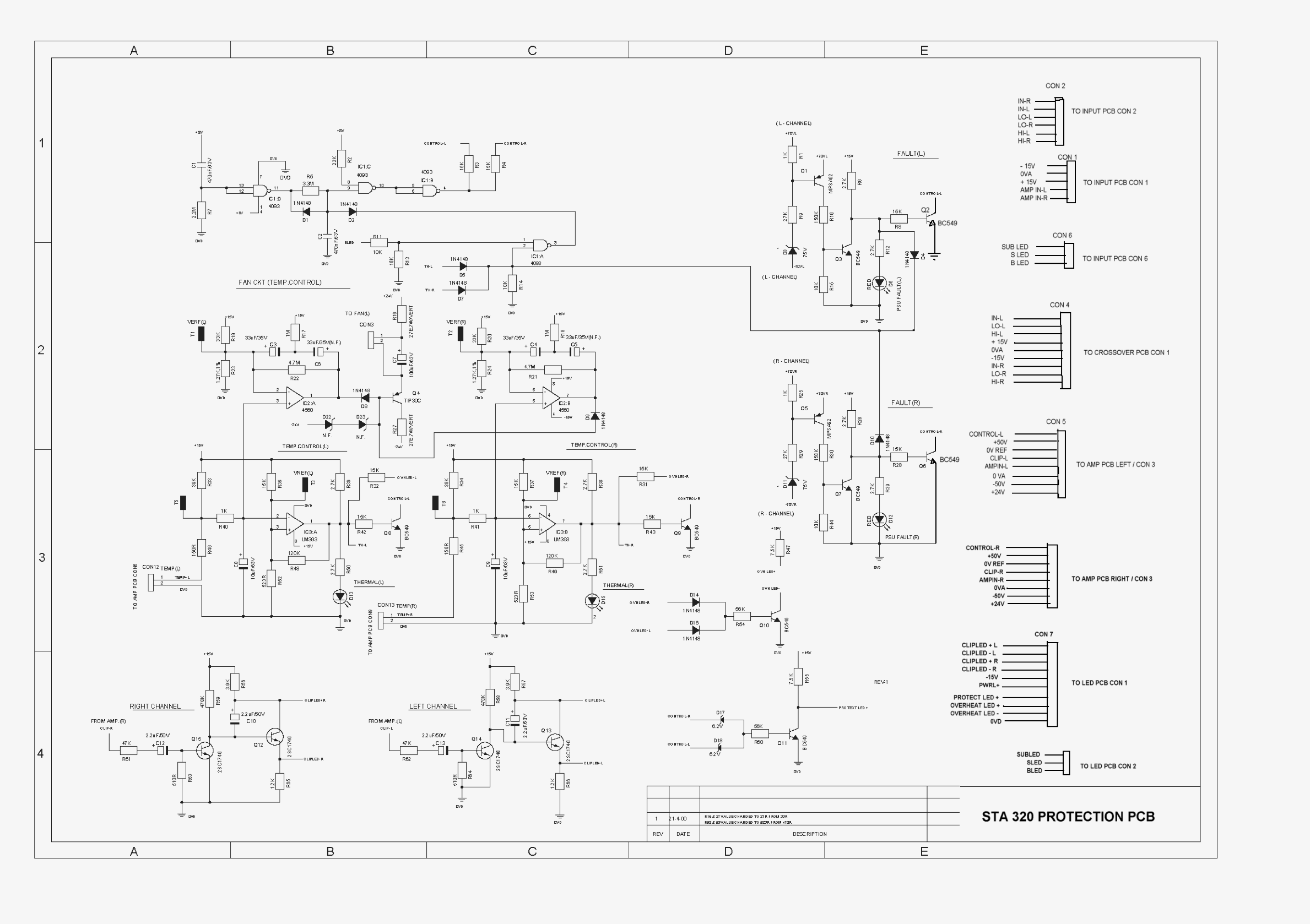

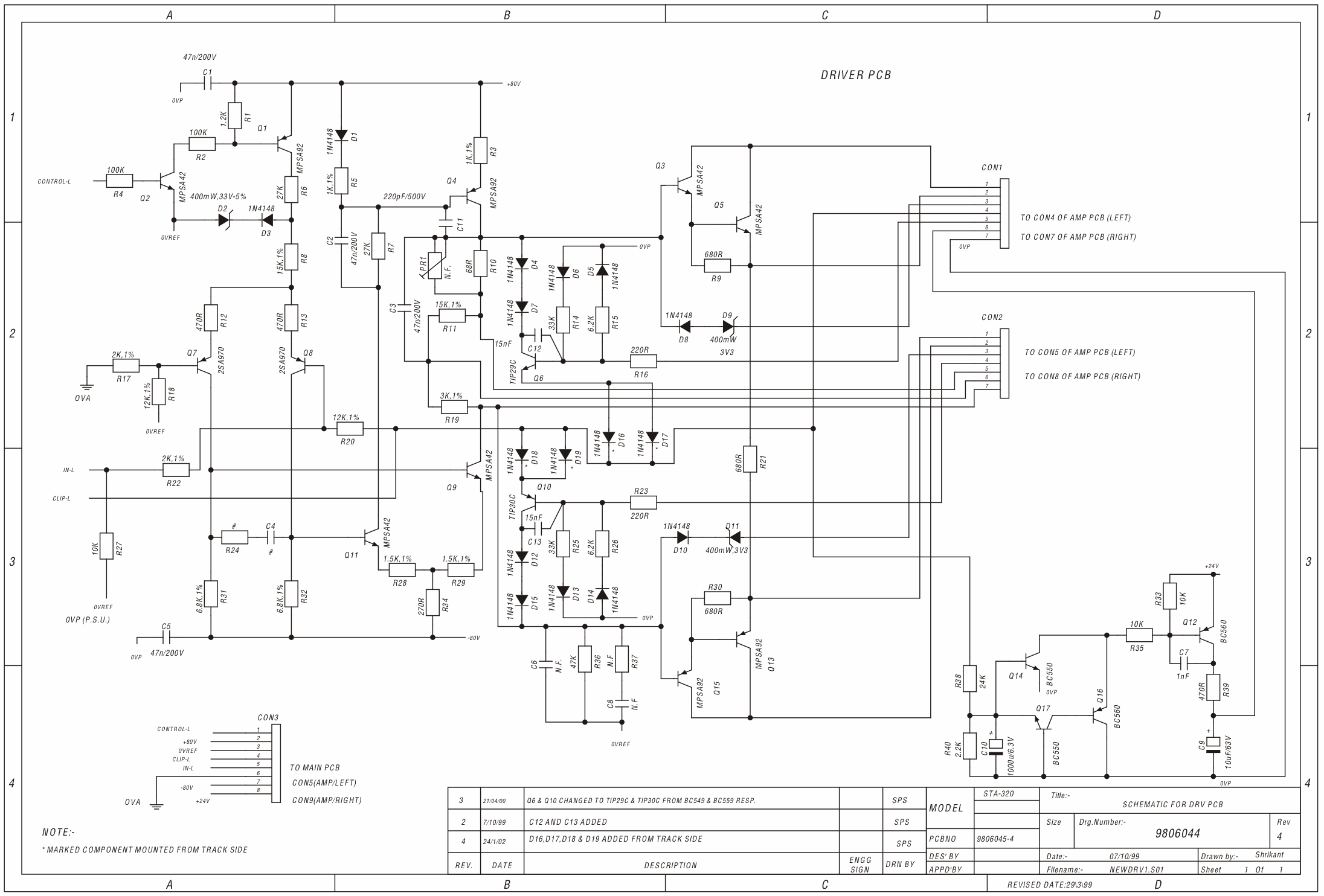

i just bought a stage line sta-320 pa amplifier. i got it cheap because it goes into "protect" mode just after powering up. i disassembled it, unsoldered all power transistors and checked them for shorts. the result is, that none of them is shorted. the problem is, when i replace the fuses (they were blown) of one channel, the fuses survive (no matter which channel) but when i replace the fuses of both channels, so that the amplifier leaves protect-mode, all fuses blow again. the power rails arent switched. these issues make me think that the problem is in the driver stage. am i right?

right, the driver pcb is connected to the power stage pcb via pinheaders, i resoldered most joints, so they should be okay, also there are no cracks on the pcb. the power supply (two huge transformers, 0-18-60-69 each supply the correct voltages, the filter caps are in good optical condition, i havent unsolodered them so far, because they are glued to the pcb, but i think they are okay too, because after leaving the amp unconnected over night, today there was still about 20V across each rail. i think the reason that the aplifier goes into protect mode is the voltage rail monitor, which measures the voltage AFTER the fuses of each channel. so my next try is to install fuses, so that the protection circuit sees the right voltages, but leave the power stage pcb of the second channel unconnected so it cant blow the fuses...

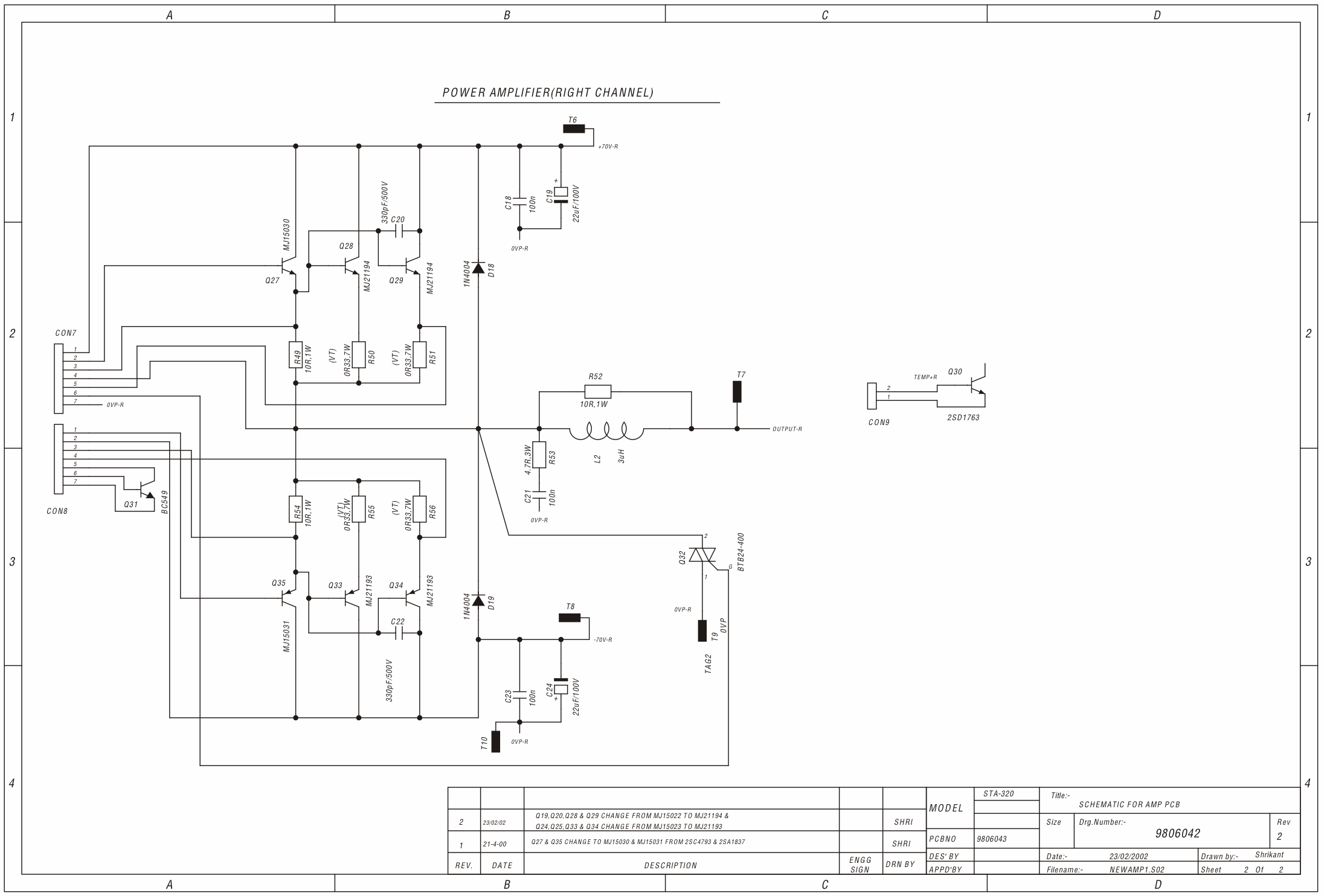

I( see what looks like a crowbar triac across the output, is it shorted? (There would be a dead short across the output terminals.)

An open in a bias string can allow both sides of the push pull to conduct at once, that surely blows fuses.
You have tested the output transistors, good. Now don;t bother to remove them first, but set your meter to diode test, and just go down the board and check every trransistor and diode on it. If it checks shorted, then remove it and retest. If it does n ot check as shorted, then it isn;t shorted. No parallel circuit in the world will make a shorted part look like it is not. Not very high tech nor is it deep troubleshooting, but it might reveal a shorted or open predriver or some such that won;t reveal itself blowing fuses each time.
hmm, i replaced the fuses of one channel, started up and the channel worked. added the other fuses, now both channels are working like a charm... very strange... perhaps only the connection between power supply and power stage board was broken...

with no load connected i tried what happens when i drive the amp into clipping. i didn't even go into clipping when there was a spark on the power stage pcb near one load balancing resistor oder driver transistor. i turned the volume low again, measured for high voltages on the output and after not finding any i connected a speaker. the amplifier is still working properly as far as i can tell. any idea what this was? only one channel was affected... did it perhaps start oscillating with no load?

F6 feeds the power transistors of the right channel. try swapping the driver boards, this helped me with two of the amps. in both amps the control circuit for the output protection triac wasnt working for one channel (this circuit is placed on the driver board)
