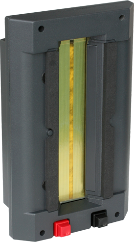

Due to many requests, Stage Accompany did finaly taken the SA8520 diaphragm back into production.
The replacement kit can be ordered under part number 3220.8520 (R8520).
By a small adjustment (terminal holes) this diaphragm can also be used for the Philips RSQ8P.

Thanks a lot Webbie for the update and info on this new product.
I was interested at some stage in a 4ohm diaph for the SA 8535 since my (passive Xovered and monamplified) system yields more than a 100dB at 4ohms.
I am now using "big boys" compression drivers for the 2kHz-20khz (JBL 2445, Mccauley 9620). They are 16 ohms and I'm using autoformers in reverse mode (yes...reverse mode) to increase at the higher frequencies the signal from the amp and thus equalise the response in UHF area of these big boys. i love their impact and realism (4" diaphragms) in the treble as they recreate very well percussions, wind instruments etc.
It's probably time for me to try also my sa 8535 12ohm drivers with this signal increase set up (+ 6dB will suffice I guess, no equalising needed).
Hello Bear,
I think you referring to the "Ribbon Rooster" site.
Between the last bankruptcy and the restart of Stage Accompany, Alcons brought the "Rooster Ribbon" site up and running. Probably to attract the SA customers to Alcons. The ribbon driver shown on their site is the SA8535, but painted in grey instead of the SA blue.
Fortunately, many SA customers remained loyal to SA and did not make the step to Alcons.
The Alcons ribbon drivers have a higher output then the original SA8535, but as always, there's no free lunch.
The Alcons ribbon drivers don't sound so good and accurate as the SA8535.
As earlier said in this tread, Alcons won't sell their ribbon drivers separate.
Greetz Webbie..

Hello Elac,
The sound with the SA8535 will be far better then with compression drivers.
One of the reasons some people dislike a ribbon driver is that they're missing something in the sound the ribbon produces.
And that's correct, they're missing the harshness and distortion of the compression driver ;-)
The other reason why people don't like the ribbon sound is that they think the output of the ribbon driver is far less then that of a compression driver.
A system with lots of distortion in the mids and highs gives you the idea that that system is producing far more dB's (and in that believ sounding better)!
A ribbon equiped system stays free of distortion even at very loud levels and gives the listener the idea that the set isn't playing loud (until you grab your dB-meter and start measuring).
That's why you can listening for hours and hours to a SA ribbon loaded cabinet (without the distortion) without going to feel tired after awhile (what is the main reason of my ribbon-addiction).
Because of the above mentioned reasons a SA ribbon loaded cabinet sounds "how music should sound", without distortion and with dynamics.
(It's still a pitty a lot of youngsters like the sound of a heavily compressed song (loudness war) which leaves no room for dynamics.
The only thing they care about is how hard the song will blast out of their mobile devices. Many youngsters don't know how music should sound!)
One of these days I will order a set of tri-amped M59's equiped with hornless SA8535's.

I presume that the Alcons ribbons are good alternatives for the SA 8535.
Unfortunally the Alcons ribbons are not sold seperatly.
On the other hand, SA isn't death yet, some people of SA are starting to build the SA 8535 (and folies) and woofers again.
Also complete enclosures.
After New Year I post the details.
Greetz Webbie...

From there I receive today follow Informations:
The "Planar Face Plate" (front plate), for use in the M57 and M59, can only be used if the terminals of the RCD have been modified (see attachments).
The terminals are also equal to the terminals used in the Screen RCD.
These terminals are shortened and equiped with an allen head bolts.
The allen head bolt can be reached by the two holes in the front plate.
The SA 8535M, used in the M57 and M59, has allready this modification.
Prices: SA 8535M: € 549,00 and front plate: € 87,00

But there is an additional difference by SA8535 between the pictures of the M57: left with diffuser and right without.
Who can upload the overview of all accessories for the SA8535M (planar face plate, diffuser etc) ?
