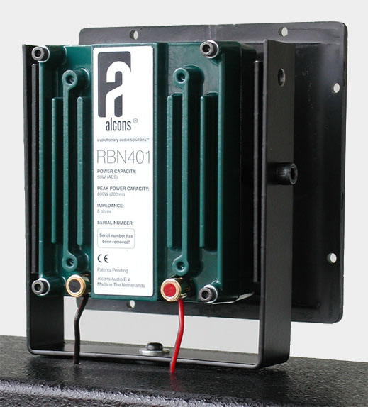

I have found this types from alconsaudio here:There is another Dutch company called Alcons, founded by former SA people. AFAIK they also make planar tweeters of some sort.Regards Charles
alcons audio - evolutionary audio solutions ®
1) "RBN 401"
http://www.diereferenz.de/files/image/Alcons_CR1_pro_ribbon.jpg
2) "RBN 601"
http://www.alconsaudio.com/site/images/technology/rbn601_260.jpg
3) "RBN 1801" and other magnetostatics
Alcons Audios' RBN1801 Pro Ribbon Technology
Magnetostatic
