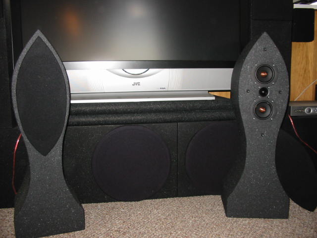

Does anyone use a technique detailed in this build to create a curved speaker enclosure shape (I'm referring to the 'egg')? Humble Homemade Hifi
I want to investigate this further... anyone know of any interesting threads to read on the subject? I have searched but don't really know what I'm searching for!
Cheers
Chris

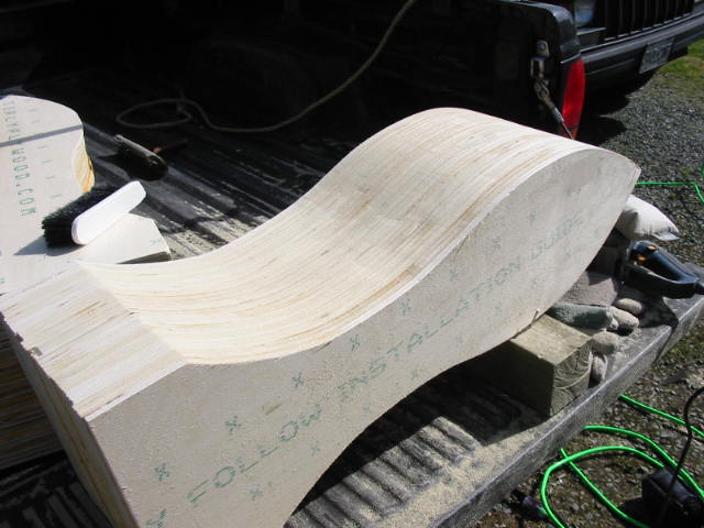

a) CNC out the rings, you could even do it in dovetail sections, so in stead of having 15 rings on a board, you would have 60-70 smaller pieces that could slot perfectly together.
b) In my opinion, it would be way way easier to find something pre-made thats suitable (aka my ikea salad bowl speakers) You must be able to find some beautiful chopping boards, or fruit bowls, wire mesh or i have even heard of balloons being inflated and covered in resin or other strong compounds.
I guess you need to know whether you desire the shape, inside &/or out, the material concentric layers of ply looks pretty special, or both. Without the aid of a CNC machine, it will be a long process.

One of the terms you want to search on is Translam. This technique is becoming fairly popular because it is a relatively easy (but wasteful -- Cal did find a creative & useful way to use his scrap) way of creating complex shapes. Plywood is a good idea, i've seen far too many of the MDF ones slpit right in the middle of a piece of the MDF.
dave
dave
Thanks Guys. Cal - I did see your thread; it was a good read.
Any advantages to doing it the "Translam" way? I was going to use a router on the inside of the walls so not to create a uniform wall for internal reflections.
It is pretty wasteful but is there anything good (better) than a traditional box build aside from being able to create shapes more easily?

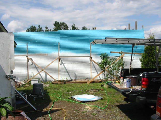

Dave's right I had some fun with the cut-out scraps. The woman I was with at the time had a big ole ugly metal wall at the back of her property so we painted it blue then re-sawed the cutouts, give'm a little colour and voila!
