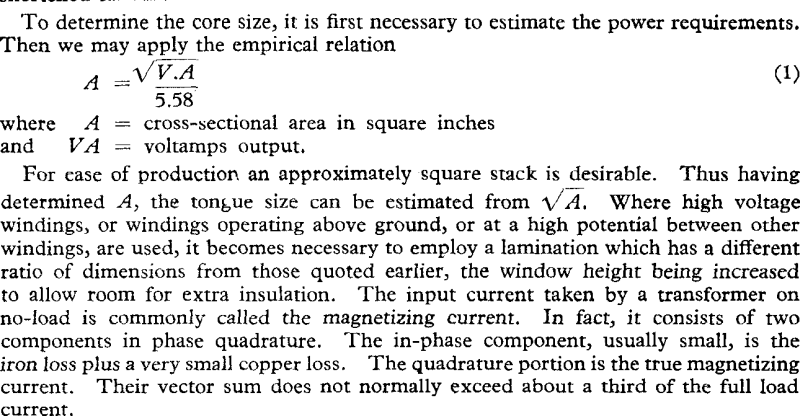

POWER TRANSFORMER VA and core size/area
Tony,
it took me a while to track down a virtual copy of the Radiotron handbook.
Chapter5 on transformers, section5 Power Transformers states.
rearranging the formula gives
VA = 31 A^2 where A is the core area in square inches.
Tony,
AndrewT,
Your reference is wrong. Don't believe everything you read. Searching for something that is wrong is a waste of time. Look up some of the core vendor applications literature. You will find the power handling capability of a core is directly proportional to Ac, not Ac^2.
Rick
Rick
i'd rather believe in the Radiotron Designer's Handbooks than take your words....🙂
anyways, that formula is a guide so that you have more or less a clear idea of what the power handling capability of a given core could be....
real world designs will vary all over the place.....
