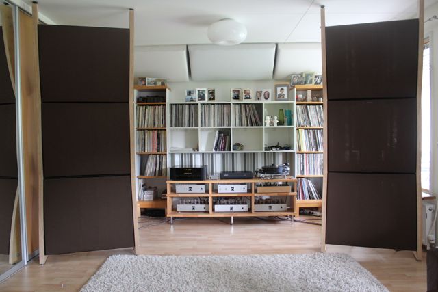

Hi all,
I saw this thread and thought to tell about my ESL system.
I have a pair of triple stacked Quad ESLs. They are mounted in custom built frames in curved arrangement with listening distance of 3.5 meters. For rigidity, they are supported tightly between ceiling and floor. They are driven with 3 Transcendent Sound T16 OTL stereo power amplifiers, so each speaker has it's own amplification. OTL's are connected in parallel to Transcendent Grounded Grip preamp. In addition, the lowest frequencies are produced with two closed 350 litres subs with 8 x 12'' Peerless drivers and Hypex plate amps.
I have gradually developed the system from a single pair and added additional amplification. The speakers are refurbished by myself, thanks to material/parts and help from Gary Jacobson and Arend-Jan.
After several years of upgrading I now feel there is nothing to change and everything sounds as I want them to sound.

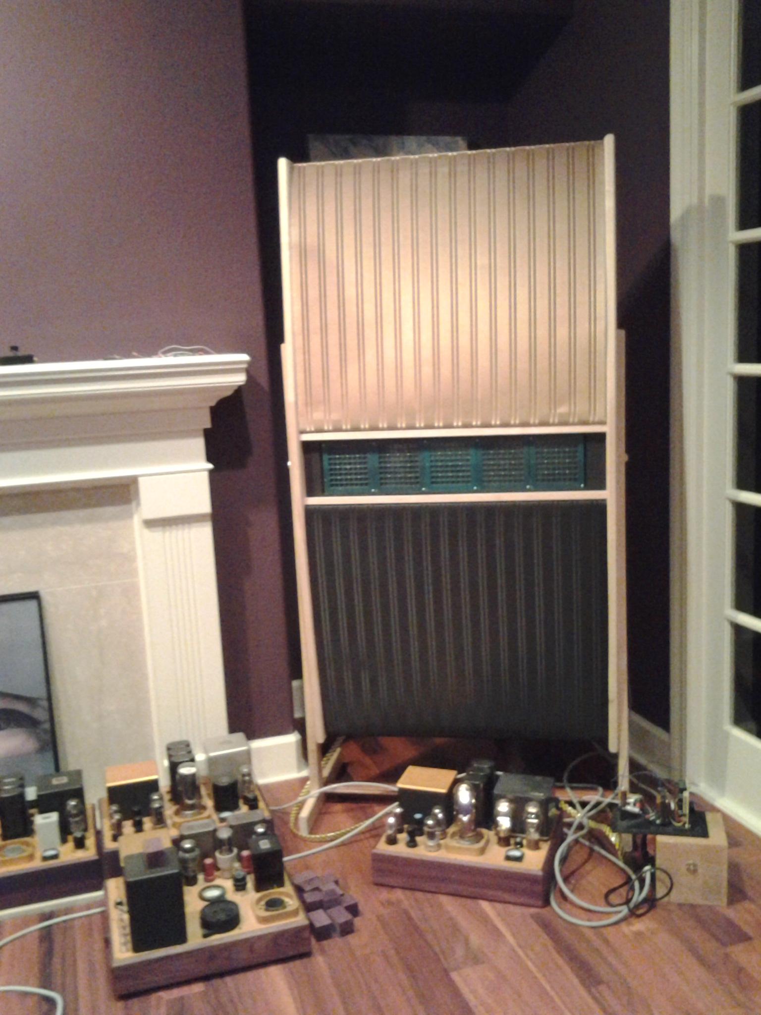

I put together a stacked Quad few years ago. I tried few supertweeter covered 7Khz up (Decca as ML, Fountek ribbon, Aurum Cantus and few others), and finally settled on 5 RTR ESL panels per side. The RTR matched really well with the Quad, without them the Quad seemed roll off (due to aged, or amplifier that could not handled the 1 ohm hf load). The staked Quad/RTR can be driven with one amp using an I30 passive xover, or bi-amp (with a SE 6C33).
I have tried quite a few amp that I can get my hand on, OTL (NYAL OTL 3B), SE (845, 211, 250TL, 6C33C...), PP (845, KT66, GU50) , solid state (ML, Krell..).... I found that the Stacked Quads worked best with SE amp with 15watts or more. I finally settled on a SE 211 20W that I have built, matched with the stacked Quad, the system have no major shortcoming, and I can spend hours and hours of music enjoyment.
Considering the Quad that I have (bronze circa 1959, black circa 1978) are pretty reliable, the only thing I change was the diodes in the PS on the bronze, which is over 50 years old!
Nice post. I have not run my SE845 20/20 watts into the Quad 57 (revised) I will try this when I get time. In a smaller secondroom these did not need to be a doubled stack. My main room is much bigger and would have benefited with stacked units.
Interesting that you have ended up SE211 20W which is where I am at but 845 instead. At present I like the sound through a TQWT but the Quad stacks with SE211 IMO would be better esp for mid and treble.
Do you know how the stages on the SE211 are coupled. This can make a difference. Do you have a circuit diagram forthis amp Email if you wish.
My solid state amp is as good as it gets. Not sure which I prefer.
This SE 211 used VT25 as input tube and driver tube. I also have couple 845 SE, but with different driving circuit, they also sound pretty good with the Quads. Another amp I also like is the WE212. You can read about the SE 211 here:
