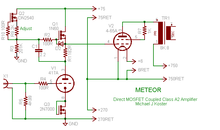

Here is a stacked supply I built that just happens to have "ground" in the center but the current loops are the same as if ground had been connected to the negative-most point or even at the positive-most point. Just don't exceed the breakdown voltage to chassis on any of your components.

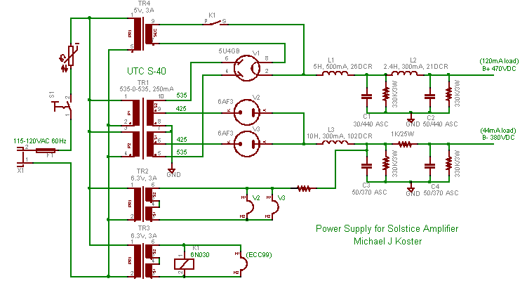

The center tap is in fact the common point where the (-) of the top supply connects to the (+) of the bottom supply. It's connected to chassis in my amp out of convenience. I had already decided on the input transformer because I use all balanced sources and I use these for PA gigs etc... OT but I rocked an outdoor festival last week with a pair of these 15W triode amps and Klipsch LaScalas!
I think your description of the stacking with the bottom supply grounded sounds right. Here is an example. I also have a third (75V) supply stacked to provide positive grid drive voltage, but the principle is still the same; separate current loops. The filament supply is even stacked on the same connection point. Definitely a separate current loop there!

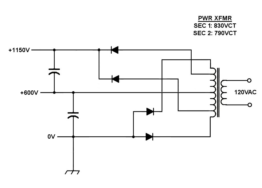

I think I get it. Here's the power supply I was thinking of. The idea is to use the lower (+370V) supply for two LTP driver pairs drawing 30mA for the two pairs (7.5mA per triode), and the upper (+350V) supply for two pairs of output tubes drawing about 200mA total for the two pairs (50mA per triode). The power transformer is rated for 275mA, and I'm staying under that by about 45mA.
I see what I think are the two current loops, each consisting of the diode bridge, choke and reservoir cap and on to load (where the current loop would continue and be closed). Right?

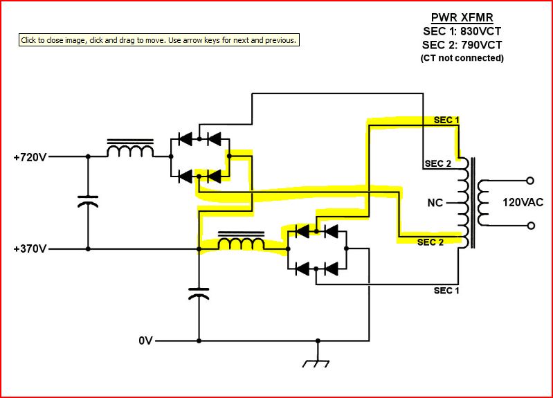

Not quite. There is a very short current loop through diodes, the choke, and the power transformer.
The bridge diodes do not create a center tap (as often mis-stated), they in fact create an "end tap" which creates a short circuit as shown in yellow when two opposite polarity "end taps" are connect together.
You need to use the transformer's center tap as the stacking point and use a (+) connected pair of diodes for the B+ and a (-) connected pair for the driver supply with the driver filter in the (-) branch to ground. Look at the Solstice supply and instead connect the 'B-' driver output to ground and connect the center tap to the 2 filter returns (which becomes the stacking point).
Don't worry about the filter choke in the line to ground. The whole transformer primary floats on the small amount of lower supply ripple and adds to the B+ ripple (series connection of the two power supply voltages + ripple).
Does it make sense?

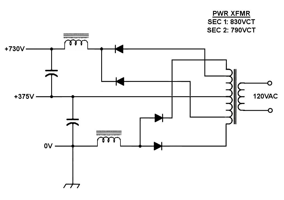

Wow, that made my brain hurt. Here's what I came up with...
That will do it. If you use a choke in the lower supply it can go between the rectifier or cap and ground.

Many thanks for coaching me through that!
So now, if I add the chokes as choke-input smoothing, and since the resulting output voltage will equal approximately VAC in * 0.9, I should get voltages as shown in the schematic below. (Ignoring DCR of the chokes and xfmr windings and other losses.)
Sec. 1: 415 * 0.9 = 373.5
Sec. 2: 395 * 0.9 = 355.5
Right?

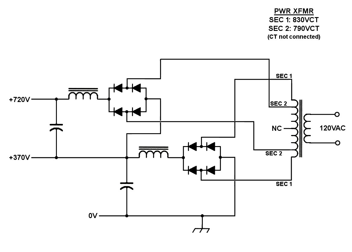

Last question, re: Additional smoothing of the two DC supplies by adding add'l RC sections...
Let's say I've got a 2-stage amp I want to DC-couple.
I'm using the 'stacking point' as the B+ for the first stage, 'top' supply is for the output stage.
I need to define ground for the first stage input, as I want that input to be DC-coupled (no input cap).
Do I now start adding RC filter stages to the center tap to use as the first stage supply, or is that causing a problem that I can't see?
schematic attached...
PS - I keep looking at that schematic... Dropping the voltage of the center tap feed would also drop the voltage of the top supply's lifted ground reference, no? It seems the two DC supplies would interact in all sorts of ways I can't decipher.
M. Jones' "Crystal Palace" amp has its LTP driver DC-coupled to its PP output stage. But the input stage output is RC-coupled to the driver stage's grids, which is why the input can be at ground in that 3-stage amp. A two-stage DC-coupled amp with the input at ground is looking like a challenge with this 'two stacked DC supplies from a single pwr xfmr' scheme...

Maybe I need to think of it as a dual-polarity supply, and the decoupling resistor needs to be in series with the choke, and then I define ground at the end of the chain...
PS - I'll call the previous schematic "take one," this one "take two." I'm pretty sure Take 2 is correct... ??
