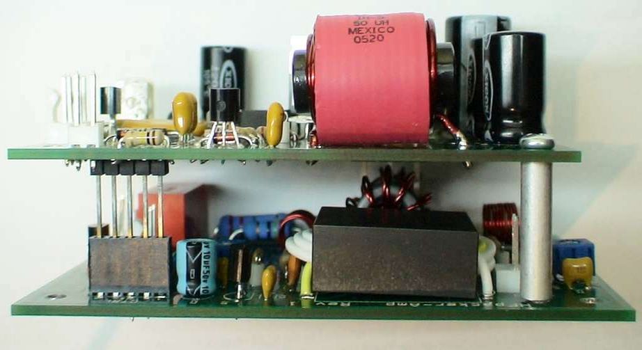

I have new solid state amp in mind, and just from looking at the block diagram, I can see that I (due to size limitation) need to stack the VAS stage PCB on top of the Output section PCB.
The distance between the stacked PCBs must be 15-20mm (0.6-7.9"). The signals going through the connector are mixed control signals, low Current audio and power signals (max 1A).
Is there out there who knows of some good audio "PCB to PCB" connectors ? I have thought of just making wire connections, but would like the easyness of the connector type connection.

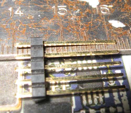

I agree with the pins.... I buy them on long strips or a few cents...
and of course you get the strips in female too...
They come in a variety of pitches and lengths and you even get angled ones.

I do know these gold plated pin headers (use them a lot for jumper purposes), however I havn't came across ones that are long enough (20mm). However the short pin headers may be used, if the receiption is a vertical connector like on the attached picture (however I do not need this big space between PCBs.

I'll grab a few for you from the shop when I go on Monday... They definatly have them in longer versions, I think the long one is about an inch... It has two plastic strips to keep the pins seperated over the full lenght, instead of just the one strip at the base...
Waith they must be even longer, as I found a small piece from the medium sized pins... and they are 22mm
P.S. super neat pins in your picture...

I get those from a small retailer... would hate to know what RS charges for them... as you could see from the picture the pins are completely untarnished after 2 years, even just lying in a little drawer... (I live by the sea)... I remember them being quite cheap... like cents I think....

I can get 21 and 35mm lenght, they come in snapable strips of 40
and are about .33EUR in single strips and .25EUR each in 100 strips (4000 pins).
RS calls it WIRE WRAP HEADERS, and charge 10 times that...
