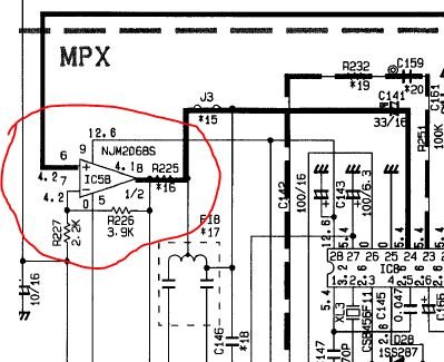

Attached is the relevant part of the schematic. I was baffled when I encountered it the first time tweaking the tuner to be a jitter meter.

Power pins are parallel in any design anyways, im guessing you just bend up the output pins to attach resistors?

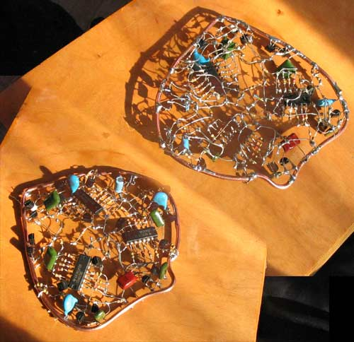

Dead bug circuits were fasinating I think Ciat Lonbarde took it to a fun level with his paper circuits

Howdy and thanks for that awesome link! The magic word being fun here. Yes, the pins are cut and shortened resistor leads are soldered and bent back, then joined and one lead is pushed into the appropriate hole on the header. Made the retrieved from the garbage, literally, Pyle 444 phono pre listenable.

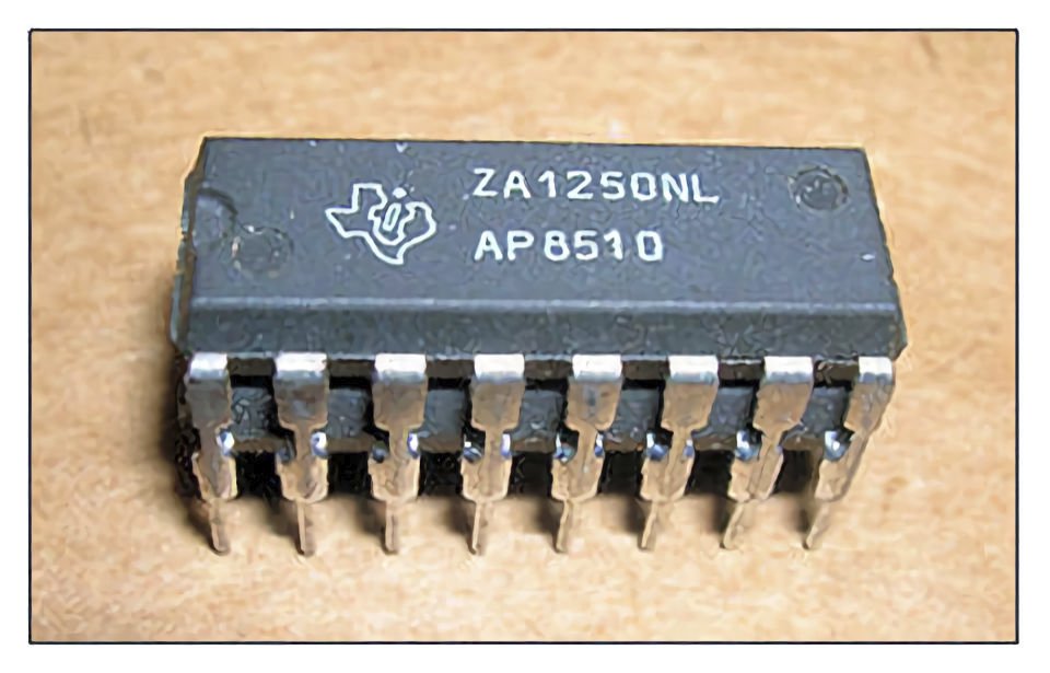

They were stacking logic chips or dip transistor packages if I remember for mini motor controllers.
