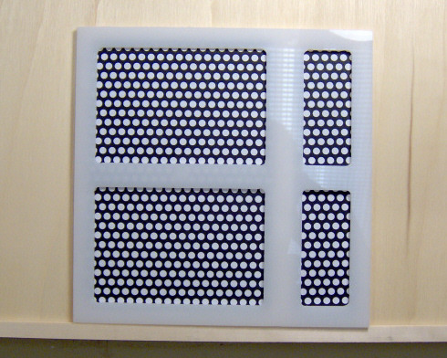

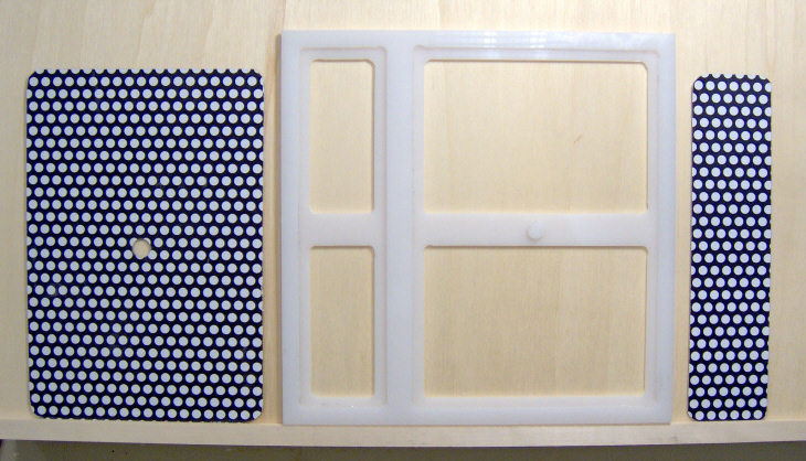

I wanted to see if their style of insulator construction could be done DIY. They use an acrylic sheet that has the cutouts CNC machined. Not an option for me, but I hit on the idea of stacking two thinner acrylic sheets to achieve the same result.
The photo below shows my small two-way proof of concept insulator. It would needed to be scaled up in length for an actual ESL and two mirror image insulators would be needed for a complete panel. It's two layers of 0.100" thick white acrylic glued together which should give a diaphragm to stator distance of 0.056" when used with 0.036" thick perforated steel sheets, allowing 0.005" for powder coat thickness. The stators shown are not the real thing, they're printed on cardboard for this test. :)
Note the round plastic peg on the horizontal insulator and the hole to clear it in the perforated stator. They're the 'node points' refered to by ER Audio. I believe the peg should have holes for a screws to connect both halves of the ESL panel.

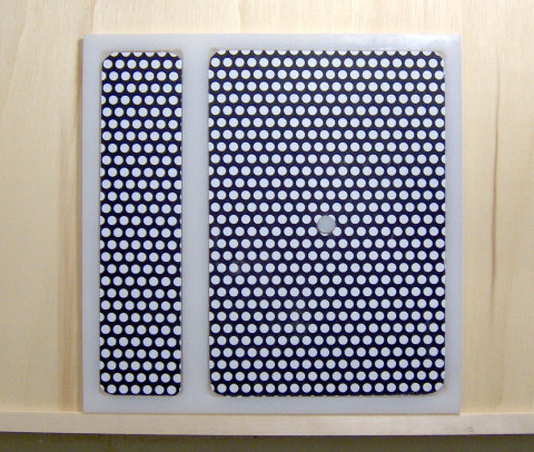

Here's the diaphragm-side view with the stators in place. I'm thinking epoxy adhesive would work to hold the stators in place. Rough up the acrylic with sandpaper, set the stators in with some weights to hold them flat, and pour the epoxy into the holes of the stator.

You will find that epoxy will not bond well with acrylic. There are contact cements that work well for bonding the metal to the acrylic and bond the diaphragm to the acrylic. The trick will be to find a distributor who well sell you a small quantity of the stuff- it is made for industrial use.

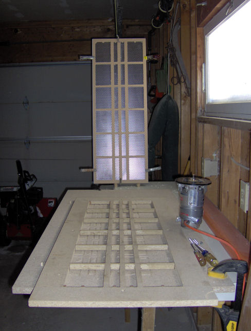

I'm going ahead and using the stacked insulators for my ESL speakers. The background of the picture below shows the outer insulator after routing, with the perforated steel stators held temporarily in place. The acrylic is 0.118" thick, white, and measures 13-3/4" wide x 37-1/16" high.
You can see the router jig in the foreground. The base is a 2' x 4' sheet of 3/4" chipboard. On the left side is two of the three dowels that locate the acrylic blank and the routing template. Four flat head screws hold everything together. The acrylic sheet gets sandwiched between the base and template.
It worked out quite well. I cut four identical insulators using a 1/4" two-flute carbide router bit and a guide collar on the base of the router. It took about 60 minutes to rout each insulator.

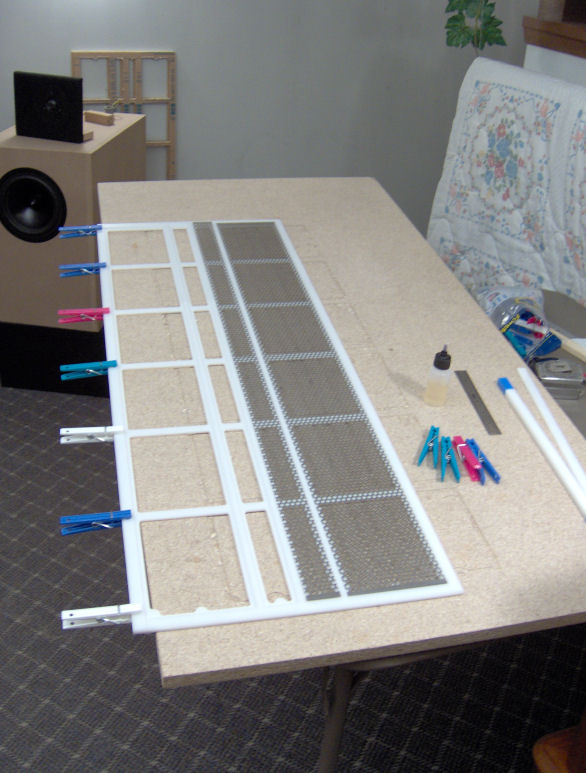

This picture shows the second layer of 0.100" acrylic being glued to the base layer of 0.118" (3mm) acrylic. It's hard to see, but there's three 1/4" wide strips glued to the center ribs and a 1/2" wide border around the outside of the base layer. All held together with Weld-on #3 solvent cement.

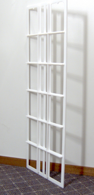

Thanks, dstockwell. It's been a long time between updates, but the insulators are done. I've attached a photo that shows one of the panels with 0.250" thick x 0.563" stiffeners glued on edge to the main panel. Two panels held together are incredibly stiff when I try to flex them in the middle.
The perforated steel stators should be powder coated next week.
BillH
