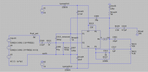

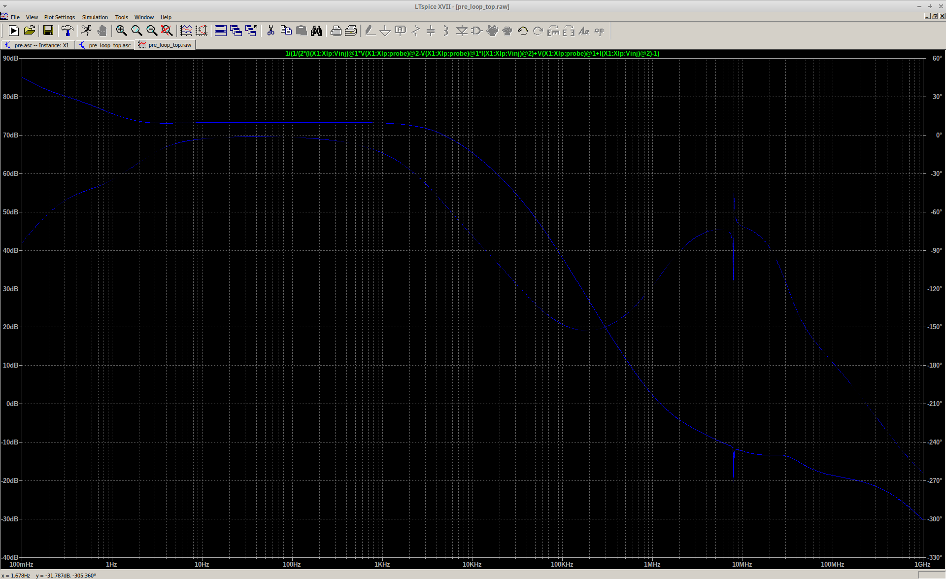

Simulating the factory circuit reveals that phase margin is pretty bad -- about 20 degrees.
Here's a first attempt to change the compensation to get this stable. While this looks great in spice, the actual circuit still picked up FM :-C
The trouble is likely that the Baxandall network (abbreviated here as R415 and R421) is several inches away and spread over two PCBs connected by a lengthy wiring harness. It's probably contributing some parasitics that I don't know how to model in spice.

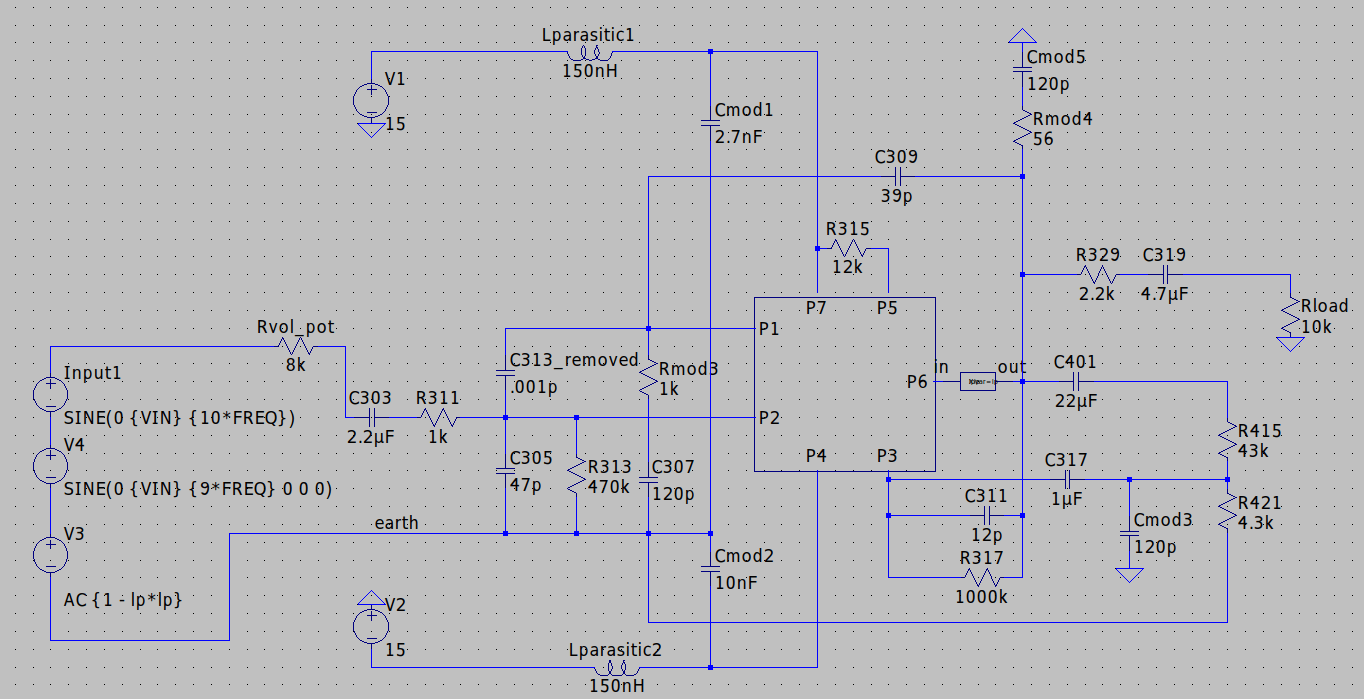

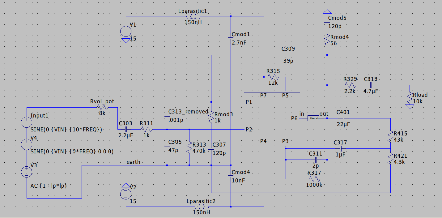

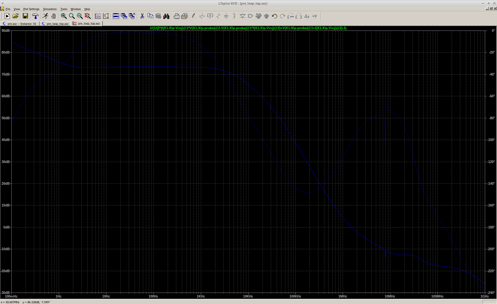

The lengthy NFB loop and Baxandall circuit behaves like who-knows-what at HF.
We can add cap Cmod3 to form a capacitive divider with existing C311, creating a new NFB loop at HF where the impedance of these caps falls below that of the Baxandall network and so this new NFB loop will dominate. The reduction in HF impedance and the physical proximity should bring the actual circuit into closer alignment with the behavior that spice predicts; knock on wood.
It seemed to work -- this circuit gets rid of the radio pickup. The noise floor is lower; it sounds passive, like thermal noise hiss; and it no longer "jumps" with a hand on the chassis.
All the mods were:
  • Remove C313. This boosts in-band loop gain from ~40dB to ~60dB.
  • Replace C307 with 120pF in series with 1k.
  • Replace C309 with 39pF.
  • Replace C311 with 12pF -- probably the original 8pF value would work fine too.
  • Add Cmod3 (120pF) to form the capacitive divider mentioned above.
  • Add Cmod5 (120pF) and Rmod4 (56). This creates a low impedance load for the preamp at HF. Maybe not necessary but it adds to the margins.
  • Add decoupling caps Cmod1 and Cmod2. This probably wasn't needed; the supply isn't that far away. But it's easy to do, the factory left unpopulated pads for them.
  • R311 reduced from 4.7k to 1k. Optional. Reducing the input impedance improves distortion performance a bit, though we're in series with the volume pot here so there's only so much you can do.

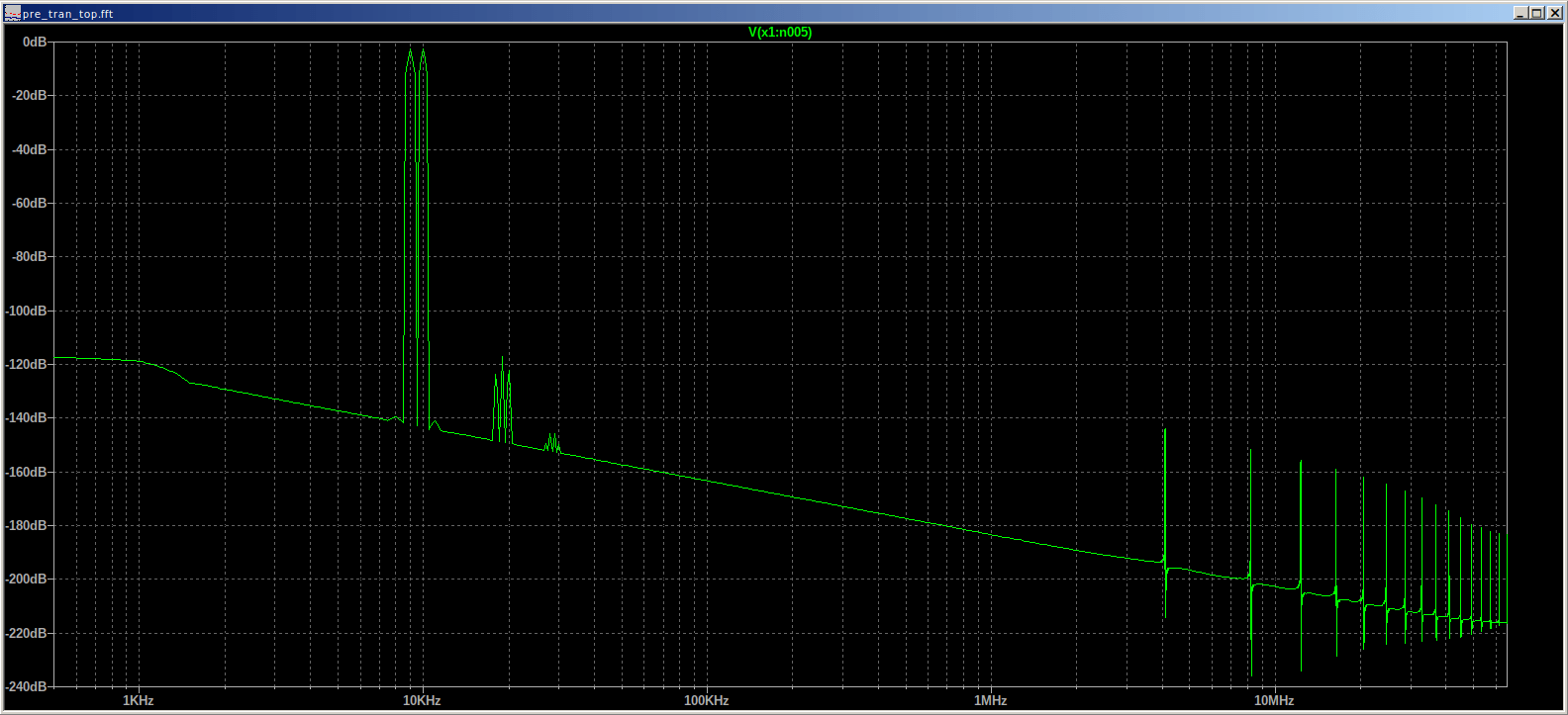

The finished preamp simulates around -100dB distortion floor at worst-case volume setting and signal level. Not bad for a 45-year old op amp. In the right application it can work well.

Here's simulated distortion performance on the A-5 with mods, assuming an 8k source impedance from the volume pot. Better than -110dB -- excellent.
