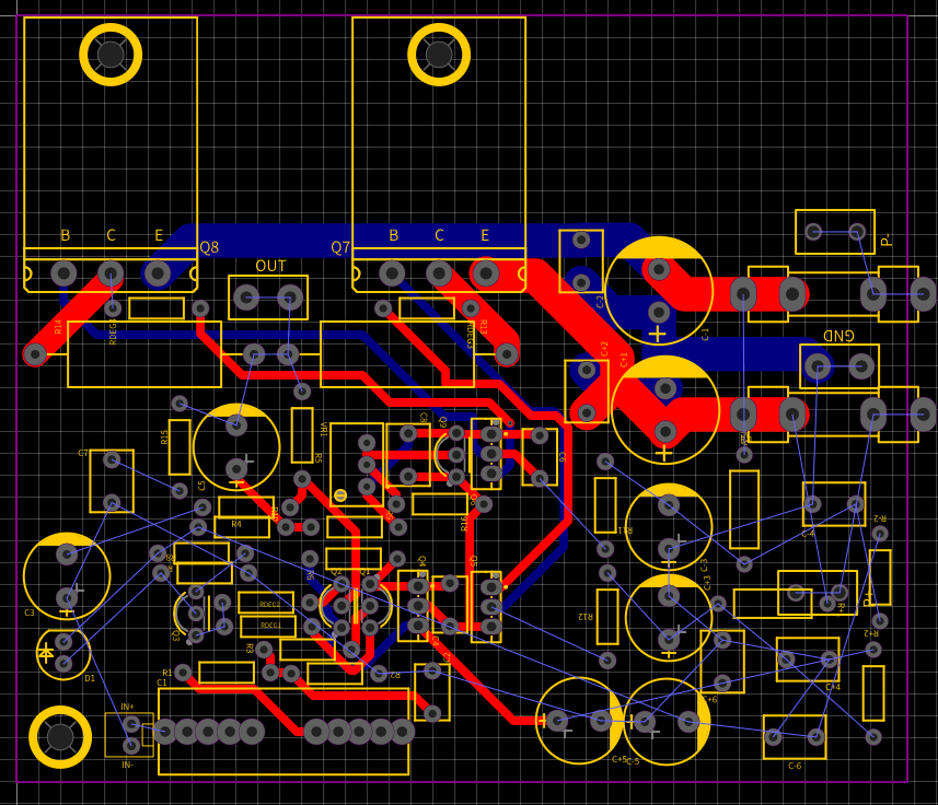

Re pcb layout.Thanks for the feedback.
Version 3.0
And the layout:
I've copied from the wolverine here, 1R 2W for the output to driver decoupling and 10R 1/2w for the input/VAS decoupling.

To my mind R13 and R14 are too close to Q1 and Q2. for comfort since these resistors have a small level of inductance and varying currents will induce voltages causing radiated fields in parallel with the resistor bodies.
Radiated fields can be reduced by routing the power supply leads and that for speaker out so these are in close parallel with these resistors. This cancellation strategy does does not neccessarily mean making traces under the pcb.
These leads can be routed around the perimeter of the board with gentle curves to navigate around corners with leads secured to anchor points by cable ties.

Well, i've spent a few hours on this now.Grounding is often the trickiest part of audio PCB design. Ideally, the positive and negative grounds should resolve locally before connecting to the rest of the ground network. If you look at the ESP's P3a PCB, you'll see this in practice. Addressing this on your PCB would require a bit of reworking.
The Wolverine PCBs are an excellent example of audio grounding done right, using a star on star approach with a ground lift. It's quite a bit more intricate that simpler grounding topologies.
I've attempted to do a 'sideways' style design like the wolverine which would theoretically allow me to do the separated ground layout style grounding of the wolverine. However I am not sure that the juice is worth the squeeze.
The trace from the drivers to the outputs goes from 16mm on my previous design to something like 60mm.
The feedback trace goes from 15mm to something like 40mm.
That is before figuring out how to get everything neatly where it needs to go.
So it seems to me that I am best to take a few steps backwards. If the grounding layout on V3.0 is poor then I am best to remove the extra supply rail decoupling and redo the supply rails to come from one side only so that the grounding can be better laid out like on Rod's board.
The extra decoupling was probably a step away the goal of a pcb with the extra stability components and better capacitor options. No point making it harder for myself than it needs to be.
It has certainly been a good lesson though.
The one's I have are 5mm spacing, quite fat though so I have used a wider footprint so allow space.If the footprint space for these looks much wider than for a 100pF CoG Np0 capacitor in post 19 there is mention of silver mica types. I have some of these value 270 pF and the spacing of the leads for these is far greater.
This is almost identical to Rod's board.Re pcb layout.
The learning experience of doing a proper layout is certainly time well spent. The major current loops are now much smaller and that is very positive. The drivers could be placed closer to the outputs to reduce both trace resistance and inductance. Another layout "rule of thumb" is that traces should be routed both "to and from" filter caps. A single trace "to a cap" just adds to their equivalent series resistance and inductance reducing their effectiveness. Layouts usually end up being a series of compromises. The more you understand the complexity of the task the more one appreciates the amount of work it takes to create an excellent board.

The same comment applies to the cermet trimmers I would move them away to avoid the perils mentioned in my recent post on radiated fields and wire would resistor inductance.Well, i've spent a few hours on this now.

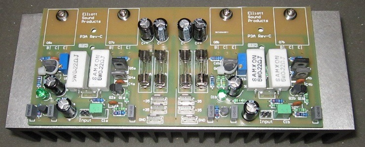

The whole layout is to fit the heatsink which restricts the pcb dimensions.
This may be ideal in such as high power amplifier where the power supply takes up a large space inside a standard size case. The heat sink in this photo looks outsized for the power level for Class AB working.
The way these wire wound resistors are arranged I don't see any simple route to run supply and output leads in parallel. That would be possible if these were to be oriented at 90 degrees to where they are now i.e across the short length of the pcb.In that way there will be a straight line for the bunch of output and power supply leads to kill two birds with one stone.
