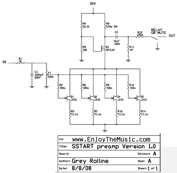

Speaking of J310's Idss: mine are all in the range of 40mA. You suggest in the article to lower the voltage to 8V. But how's the math? (I know, this question is briefly "how a JFET works" but I am a newbie :angel: ) . 🙂devilr: Guido, don't only ask, study electronics instead...)
And then: how to compute the value of the load resistor? 🙂devilr: and english, also)
Many thanks 😉
Guido
First you have added your J310, any number
using 100 Ohm at each gate and 47 Ohm for each emitter (instead of 51.1 Ohm)
and added the IRF610 biased by 10 kOhm + 22 kOhm (R5, R4)
Then you can put one 10 Ohm resistor in place of R8 (270R).
The goal is to get a voltage drop across R8 of ~17.5 Volt. (Between 15-20 Volt is alright)
Now measure the voltage across this 10 Ohm resistor.
We call this voltage MV = Measured voltage.
This is how to calculate the value for R8:
R8 = 17.5/MV * 10 Ohm
Find a resistor close to this value.
Use a 5 Watt power resistor.
The above method assumes a power supply ~50 VDC. = Default GRollins supply.
For like 40 VDC supply, we may want ~15V across R8, and you could use formula:
R8 = 15/MV * 10 Ohm
For like 60 VDC supply, we may want ~20V across R8, and you could use formula:
R8 = 20/MV * 10 Ohm
Grey had J310 with 25-30 mA.
GuidoR has got some 40 mA
My spice models are 50 mA IDSS.
Grey use four J310 at about 16 mA per each.
The target value assumed is like 50% of IDSS.
The source resistor should be chosen accordingly.
For Grey this was 51.1 Ohm

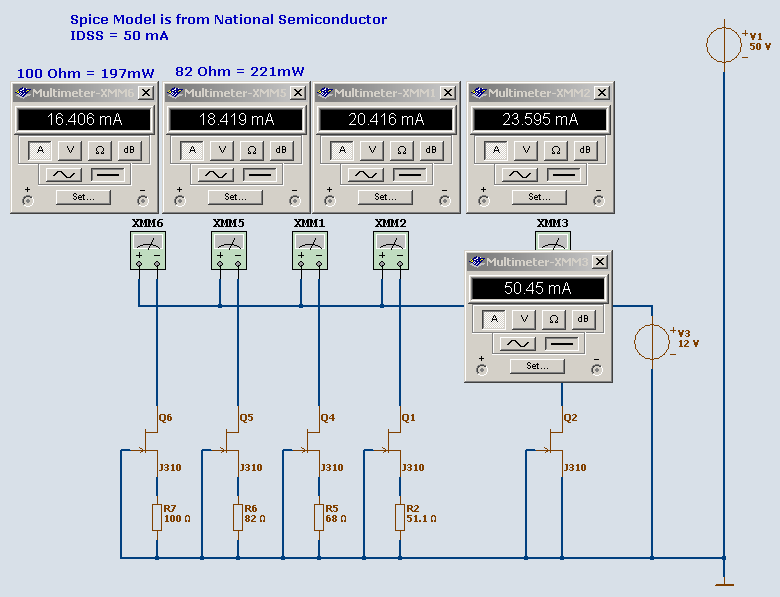

Well, there is something wrong with that 625 mW rating for J310 in Farichild datasheet.
Onsemi & Philips have these figures: 350mW & 400mW.
So Grey is right, run them no harder than 150-200mW.
Max 12-16 mA with like 12 Volt across Drain-Source.
Gives:
12mA x 12V = 144mW
16mA x 12V = 192mW
See attachment.
If using the default 50 VDC supply and JFETs so are working at 12V drain-source,
then this simulation renders I should use >= 100 Ohm source resistors
for max 200 mWatt operation.
This is for the Philips IDSS= 50 mA spice models.
So, the advice to use 51.1 Ohm or more is correct. I guess for most J310.
Each one that will build SSTART may do his own measurments.
It is not very difficult math 🙂
Actually I could use 82 ohm resistor, because there is a voltage drop across this 82 Ohm resistor of like 1.5V.
So the JFET has 12-1.5= 10.5V drain-source.
18.4mA x 10.5V = 193.2 mWatt
