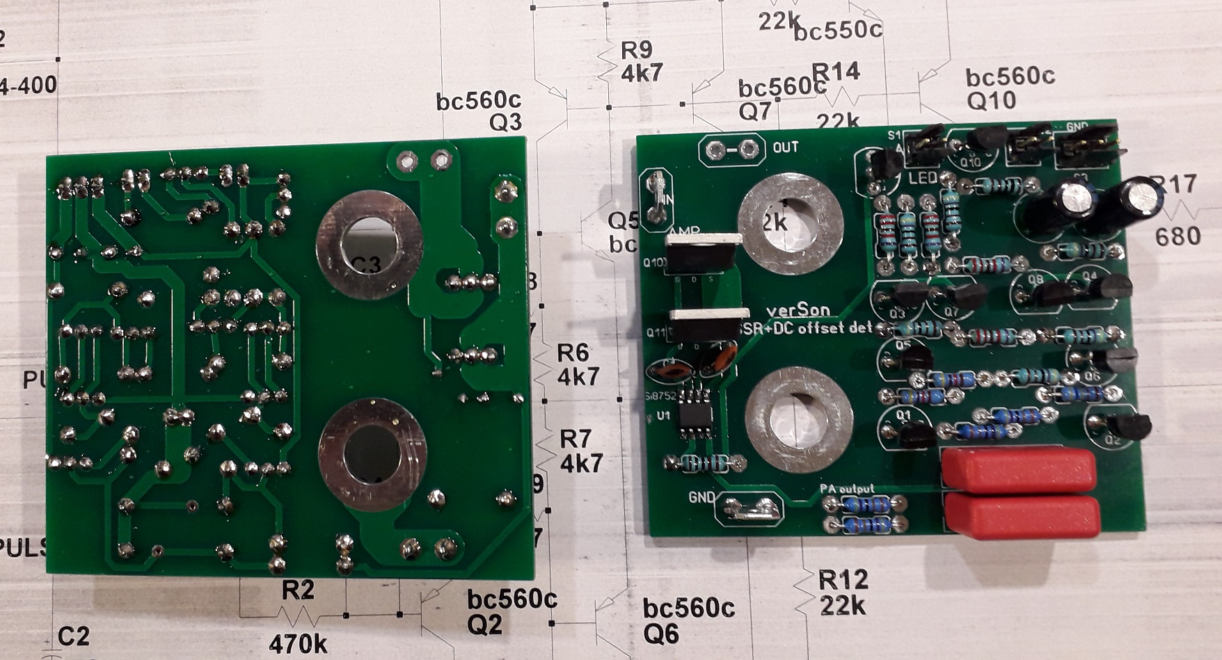

I chose to connect SSR between amp hot output and loudspeaker, and there is no need to separately connect integrated DC offset detector.
If you look at schematic and layout in first post there two more connections, LED indicating DC offset detection and TR showing in that case about 2 V that could be used to switch off the amp power supply (some switching power supplies have input for that).
My new PS regulator (cap multiplier) has switch off input.

Hi Damir, do you have an .asc for the circuit in post #1?
It's here.
Damn, I didn´t see this thread before, otherwise I might have jumped on a couple PCBs. Mady my own PCB now with PMA´s circuit, which is more basic but approved and I only wanted DC-protection anyway.

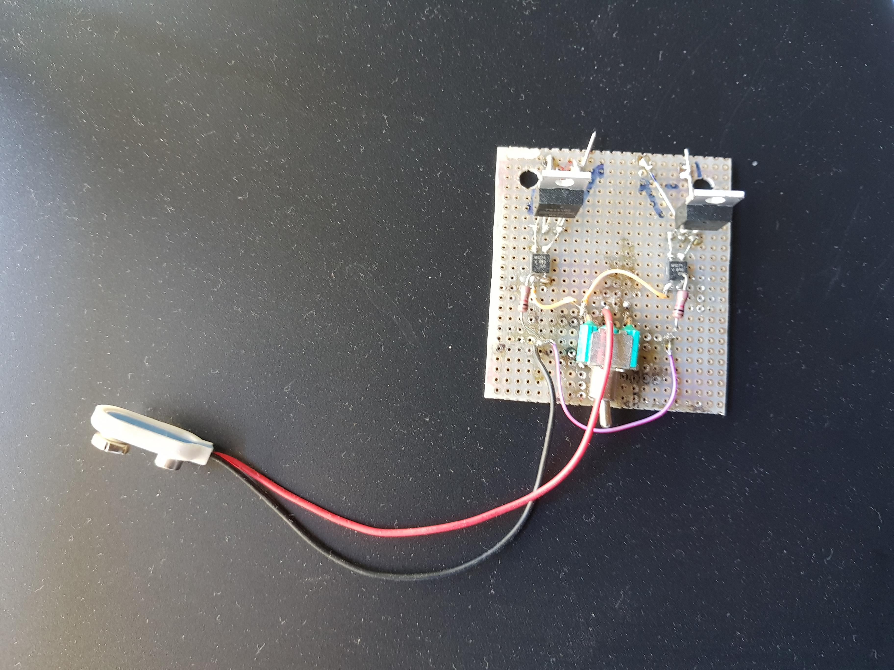

CSD19505 with Rdson 2.6mOhm. That's what i use in my sync rectifiers. Fed directly from a VOM1271 photovoltaic driver. Assuming 8v Vgs the mosfet has less than 3mOhms.
Built a couple of these to test in the speaker output and also unipolar for the PS rails. Did not like what they did to the sound in either spot. Never tested them before the large smoothing caps, but there they should be fine. One of the test jigs appears to have miraculously survived until now.
