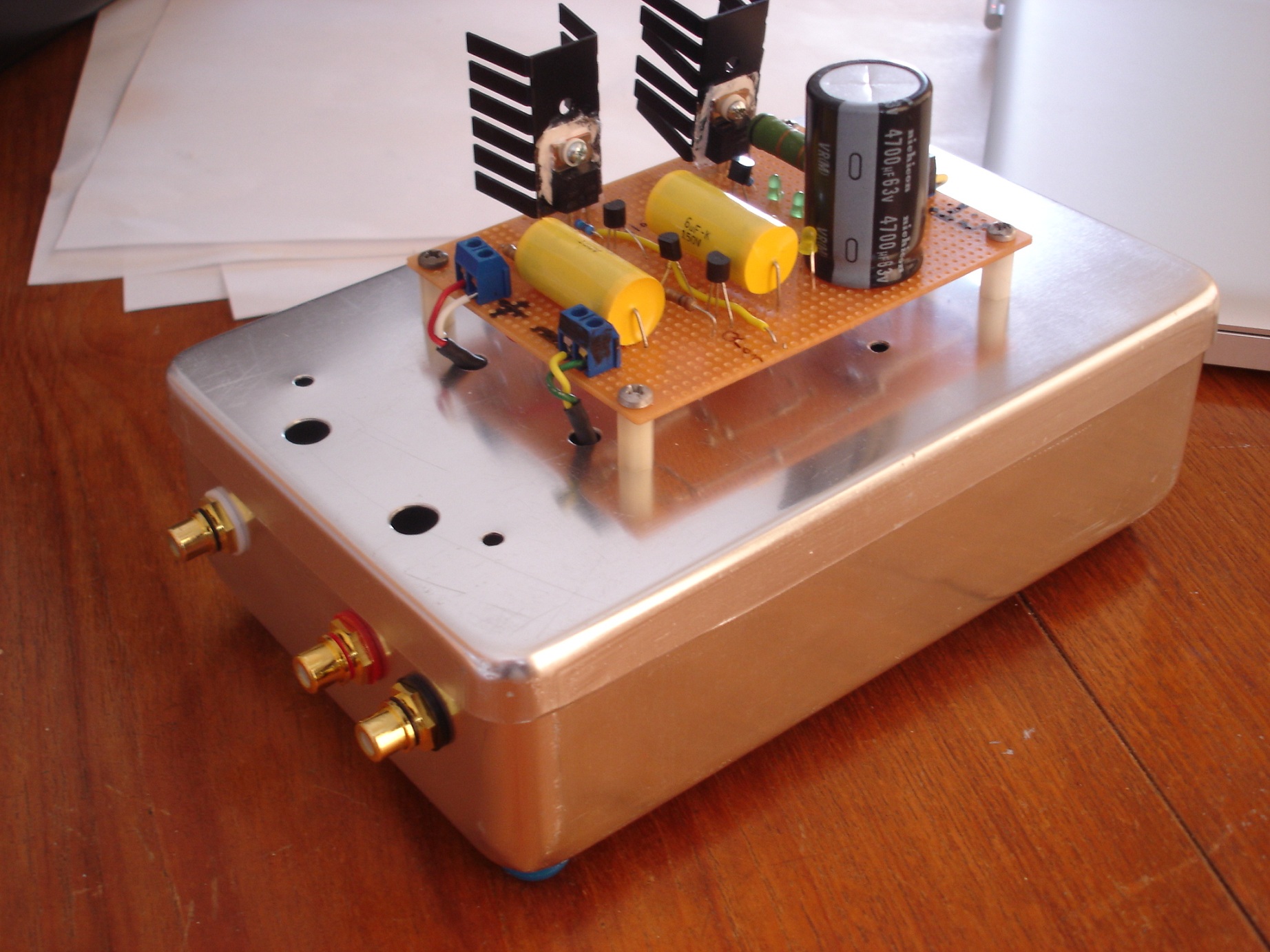

It is up and stable upon first switch, no BOO 😀
Next is to parallel a couple resistor to R101 and R103 to hit my 250mA and 5V mark then hook up to the dac ....

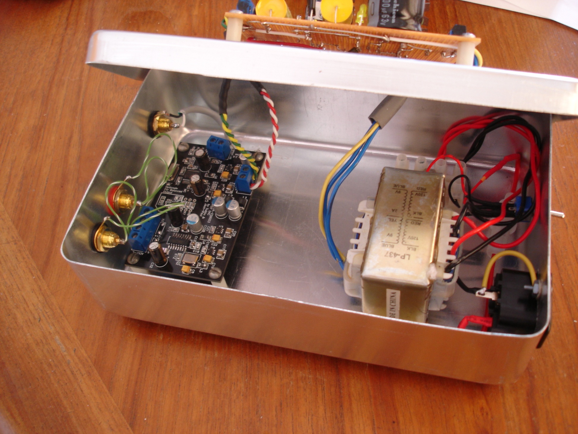

Salas, I owe you a couple pictures of the final product.
The black board is JP/Subbu's ES9023P Dac.
SSLV1.1 sounds better than any PS that I tried, so it is sitting on the top 😉

do you find difference when substitute original psu to Salas
what brand and where to find yellow films
great build
Samoloko,
I haven't receive the PS board from Subbu yet, so there is no original psu per se.
I built a few 3-legs regular based psu from:
regulator booster - pink fish media
and the using 3-pin regulars concept from Just one thing about music - when it hits you feel no pain
The results were quite good but not as good as SSLV 1.1, obviously. My ears are nothing to be pride of. It wasn't a night and day after I swapped in the SSLV, but in a more in depth audition, the improved clarify throughout the audio range just made the listening experience that much enjoyable.
The yellow caps are some unknown brand that I have owned for quite some time. They were new, but the voltage rating is too low for my tube projects. Since the build guide suggests 4.7uF to 10uF film caps, they fit the bill 🙂
In short, it is well worth the effort to build and try!!
