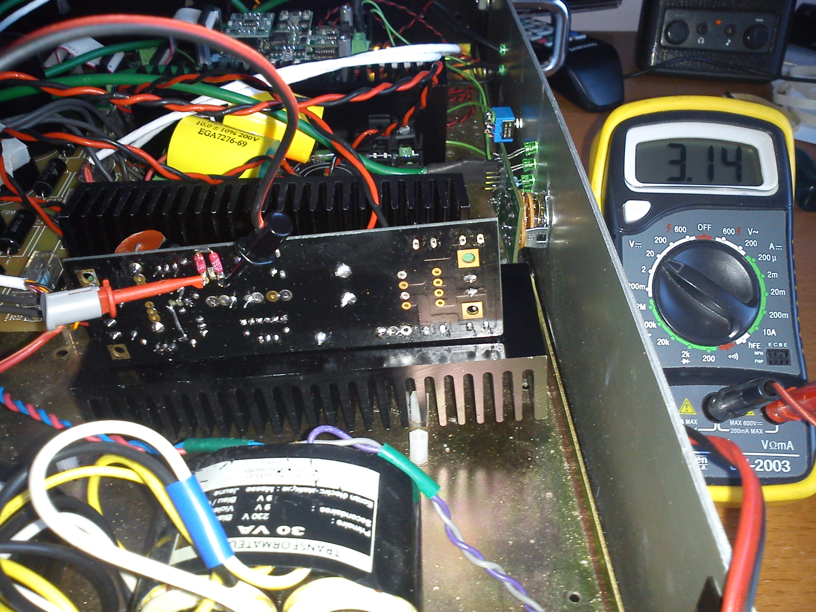

Voltage drop across Vref resistor (11R78) 3,20V + 0,6V diode + 0.002 * 1000 = 5.8V but I get Vout 5.23?
What is the measured voltage across the fixed resistor?
What is the value of the fixed resistor? Or if it's a parallel pair, what are the values?
From there you get the actual current passing and can use that to substitute for the 0.002 value that I guessed at for a 4.3mA Idss running @ 600mVds.
What is the actual diode Vdrop (Vf)?
I don't understand the 11r78 giving 3.2V for Vdrop. That indicates ~270mA of current flow through the Vref string. That can't be right !
What is the measured voltage across the fixed resistor? Now after 1 hour of warm up 3.14VWhat is the value of the fixed resistor? 11R78 Or if it's a parallel pair, what are the values? 22R+33R in series paralleled with 15RFrom there you get the actual current passing and can use that to substitute for the 0.002 value that I guessed at for a 4.3mA Idss running @ 600mVds.
What is the actual diode Vdrop (Vf)? 0.76V
............I don't understand the 11r78 giving 3.2V for Vdrop. That indicates ~270mA of current flow through the Vref string. That can't be right !

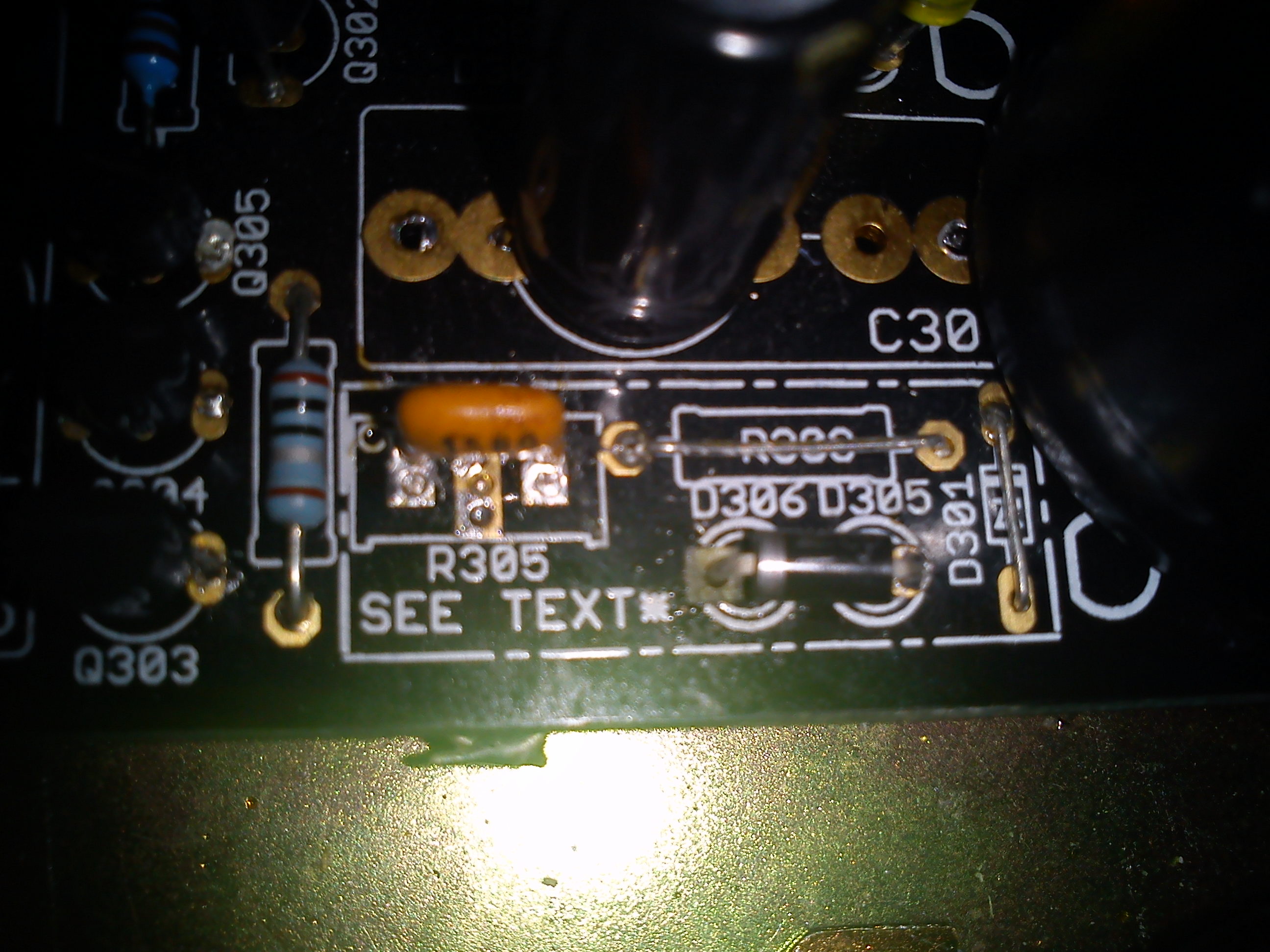

it still can't be right.AndrewT see attached pic.
How can 270mA flow through the Vref string?
For sure there is something wrong is what I'm looking for all the time. Isn't normal a resistor of near 12R at Vref to get the desired 5.25Vout when calculator says 800R aprox.
Please draw out the modified Vref string so that I and others can see what you have done and what you have measured.
Merlin, you are perplexing Andrew, you have the diode stuffed with cathode going to Q303 and you have it drawn like the optional Zener. Use your DMM and see if you got any short after soldering, especially from Q303's drain to ground. Its impossible to have such high current in the Vref if there isn't an error somewhere.
fixed
Q105 SK117GR S not connected to R106 also not connected to Q104 BC550C C simple adding a little of solder between G & S SK117GR and solved🙂
Tested with scope no ripple🙂
Finally I come back Vref area 1 red LED + 1K trimmer rest jumper😉
