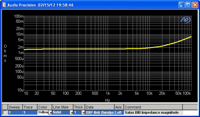

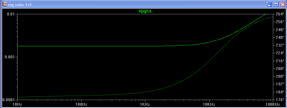

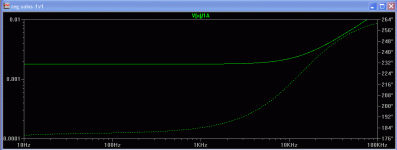

Its been measured on AudioPrecision equipment by member JackInNJ and posted in the general shunt regs thread. Here it is again. Non hot rod & Mosfet output. Matches the simulator in low band and betters it higher. Same settings, no higher than 0.1Meg test unfortunately.
