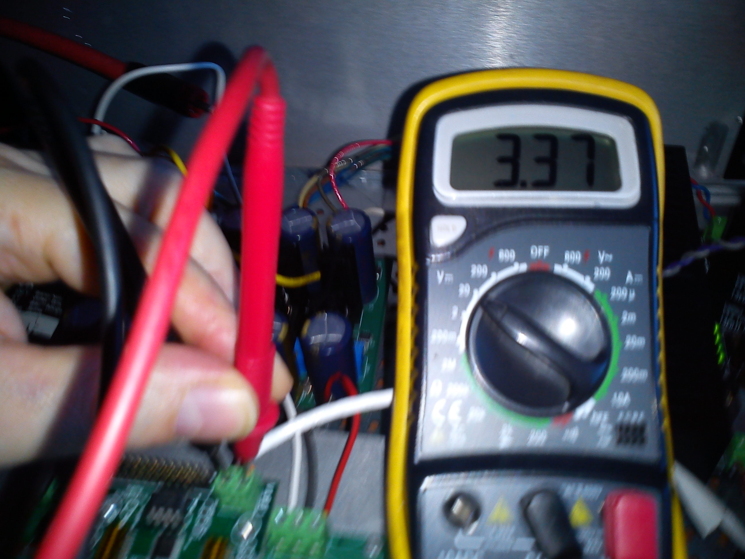

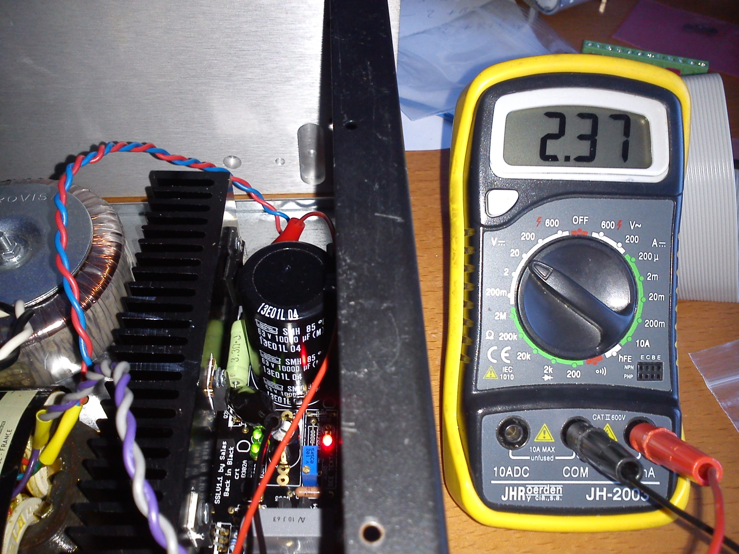

Powering my new B3
Powering my new B3 I need to reduce the voltage to 5.25V instead 5.5V for BII but what surprise: lowered the BiB voltage to 5.25V before without any load & after connected the B3 & "voila" now only can reach 3.37Vout, the current is the same 2.37V:3R3= 718mA, don't touched the Vref remained the same as per BII "2.5-5.5Vout BJT output reg. 1 red 1.9V LED, 1K trimmer. Other parts jumper."

If your load is taking too much current then it is likely that you will not be able to set the voltage. You will have to do something about the current; altering the voltage ref area components without addressing the current problem will not work.
Chris
So
What current is your transformer providing for each secondary? 30VA
What value have you for R101? 3R3
Four LEDs green, correct? YES
What is the voltage drop across each green LED? 1.8-1.9V
What value for C105? 10.000Uf
Chris
Transformer current sufficient.
4 times 1.9V = 7.6V
Say current draw of 700mA = Vgs of about 5.5V.
7.6-5.5=2.1V
I=V/R. I=2.1/3.3. I=640mA.
Not enough current for 700mA. R101 needs to be 3ohm or lower (2.1/0.7). I don't know up to what current the BiB is designed to go.

Hmm, Salas just to confirm, 1.9V = RED LEDs, yes? Because i saw other people who used the regs in the same application and they used the green LEDs in Dx02,x03,x04 instead. Is it because their current used is different?Use 3 1.9V leds and 1.2R 2W setting resistor (R101 etc.) for 0.5A available if you can't find 1.3R.
Different voltage.
OK. After calculation errors it is about the right current levels. The drop across the LEDs depends on their current I believe to some degree.Measured voltage accross R1 2.37 V : 3R3 = 718mA
If you are supplying the right current at the reg level one has to ask if the load is drawing more than this?
Chris
Chris
Extracted from leonvb BIII manual in the TP site:
"The standard board requires an input voltage of 5.25V and it draws approximately 440mA when one is using the recommended set of Trident shunt regulators"
Looks 5ish to me, better calculate based on Vgs=5V. Also your LEDS maybe ~1.9V at the small current they will run, their spec voltage drop Vf is given at 20mA nominal usually.
