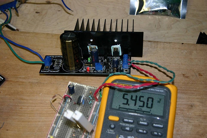

alazira,
thanks for your recipe in post number 433.
I was asking for this in a post earlier. Tried it with a 5.45V and works great.
Will fit nicely side-to side for builds with 2 pos regs.
kind regards.

alazira,
kind regards.
Hi necplusultra,
I'm glad it worked for you. I see you are using an electrolytic for C203. Is R207 a jumper?
alazira,
good catch,
read the guide again and R207 should be jumpered.
I am out of MKT's so I had to use Ecap.
Will fix and jumper the R.
thanks again.

They are the same thing, different only for max voltage they can take beyond 120V. Indifferent in this application.
A quick? since I'm mathmatically challenged.If I want adjustability from 12-15 volts at 200ma do I need a 10R/2w or 4.7r/2w resistor for R101/201 along with 3 green LED's in the CCS? The VR section will have 2 x red LED's a 2k2 pot and a 1k8 resistor.
If we assume 1.9Vf at board's operating current and 4.5V Vgs @ 200mA from 9610's chart, 5.6R looks ballpark.
