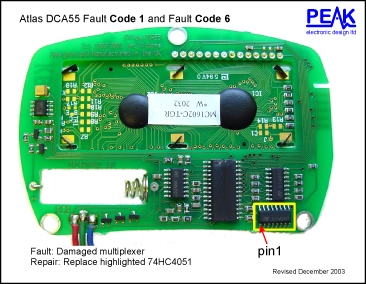

Atlas needs a new battery or one of its clips cut out at cable's end because of use strain?
The device told me to change the battery, once changed display said:
"Self test failed: CODE: 6"
Contacted Atlas and answer was: "Code 6 indicates that one of the multiplexers has probably been damaged.
Your DCA55 will be the same circuit as the picture I sent you, so it is most likely that the analog switch U5 has failed.
You can either send the DCA55 to us to be repaired, which can be ordered in our Web shop, or you can try to repair it yourself by replacing U5, although I cannot guarantee that this will solve the problem.
If we repair it then you can be sure it is working, and the repair comes with a new 12 month warranty. "
Attached image IC to be changed.
Well detailed answer by the manufacturer. That chip must be low cost to try replace it yourself before sending the device to them even if its not the 100% right failure guess (unlikely).
Farnell don't have SMT have this one Texas Instruments with the same reference, is OK?
CD74HC4051E TEXAS INSTRUMENTS, IC, 74HC, 74HC4051, DIP16, 6V | Farnell element14 Espana
Received advice from Jeremy of Peak Electronic to use this one:
74HC4051D NEXPERIA, Multiplexor / Demultiplexor Analogico, 8:1, 1 Circuito, 2V a 10V, SOIC-16 | Farnell element14 Espana
