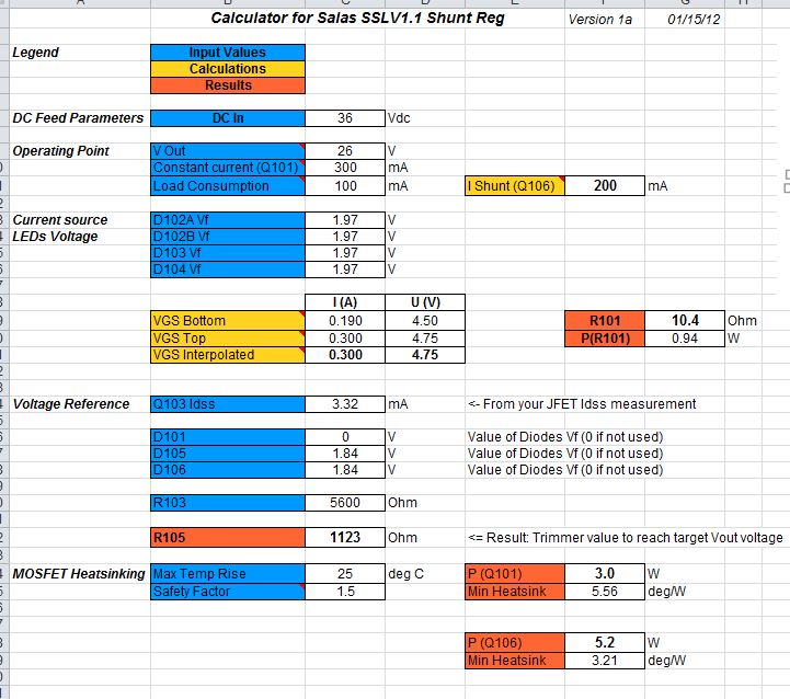

So this my plan based on your 2SK117 input, for a mildly adjustable mosfet +/-26V @ 300mA for BA-3 FE:
Q102/202 = 5.77/5.77mA
Q103/203 = 4.00/4.33mA
Q105/205 = 3.11/3.12mA
And also these:
C105/205 = 10kuF/63V Chemi-Con SMH
C102/104/202/204 = 10uF MKS4 Wima
R101/201 = 10R/5W wirewound
R103/203 = 4.42k
R105/205 = 2k 3296Y
Open to suggestions if there's a more optimal configuration for this particular application!

Make R103/203 5.6k to have bit more range just in case your max Vout with the trimmers will be at the short edge of max enough. Q103/203 will lose about 17% Idss from nominal when in this circuit.
10 Ohm R101/102 with four green Leds will not likely give 300mA CCS. About 220mA rather. Have 6.8R 3-5W also in hand. Because the Leds will not show nominal Vf in circuit. Nominal is usually stated at 20mA. Calculate greens with 1.95-2V Vf maybe. Reds around 1.8V.

Expect those Leds roughly 1.84 and 1.97 Vf (red-green) @ 3mA which is more appropriate for in circuit calculations with that excel

Below is my excel calc with specific inputs (-17% for Q103). Seem OK? I'm expecting/hoping top bump Vout to maybe 28-30V later if the SQ benefits.

Calc seems ok also. Its always a ballpark prediction. The Ohmite is a fine part too.
