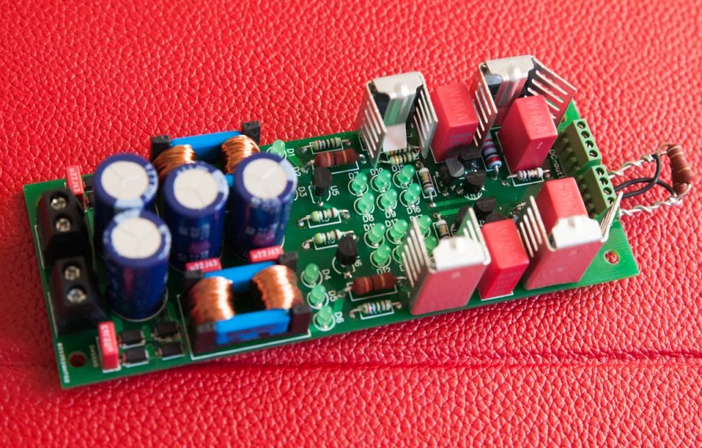

Here is how my 2x SSLV-positive smaller pcb's turned out. Will use them two pcb's to feed the Sen I/V 🙂
Very nice job!
Could you give more details about it?- Doesn´t need the SEN a floating power supply for each phase?Here is how my 2x SSLV-positive smaller pcb's turned out. Will use them two pcb's to feed the Sen I/V 🙂
Well, the SSLV is floating, as long as you don't give it any connection to mains earth. It's exactly the same as batteries - they are also floating as long as you don't connect the negative to mains earth. 🙂
PCB-size 127x47mm with common mode choke between the two first caps. Only problem with this small boards is that caps only 2x1500uf (for 35v at least) and not big room for the current-set resistor. I made the boards for low-current usage, and because of that i only made room for 3x current set-leds also.
not strictly true, batteries dont even have a parasitic connection to mains earth, or any mains related ripple or noise at all. they have their own noise components from the chemical reaction and noise pickup on the leads but thats it.
Ok, maybe not exactly as batteries, that was a bad example - but the supply is still floating if you don't connect it to mains earth. Then there is of course other negative stuff with a transformer such as interwinding capacitance and noise that makes it through the net. But the thing is that alot of people doesn't seem to understand that transformers are usually floating if you don't give them connection to mains earth.
that would be the main parasitic connection I was talking about 😉Then there is of course other negative stuff with a transformer such as interwinding capacitance and noise that makes it through the net.
a parasitic is simply an unwanted (usually) additional effect other than those desired ones you are cultivating. here its mostly cap allowing other effects to couple through the transformer
